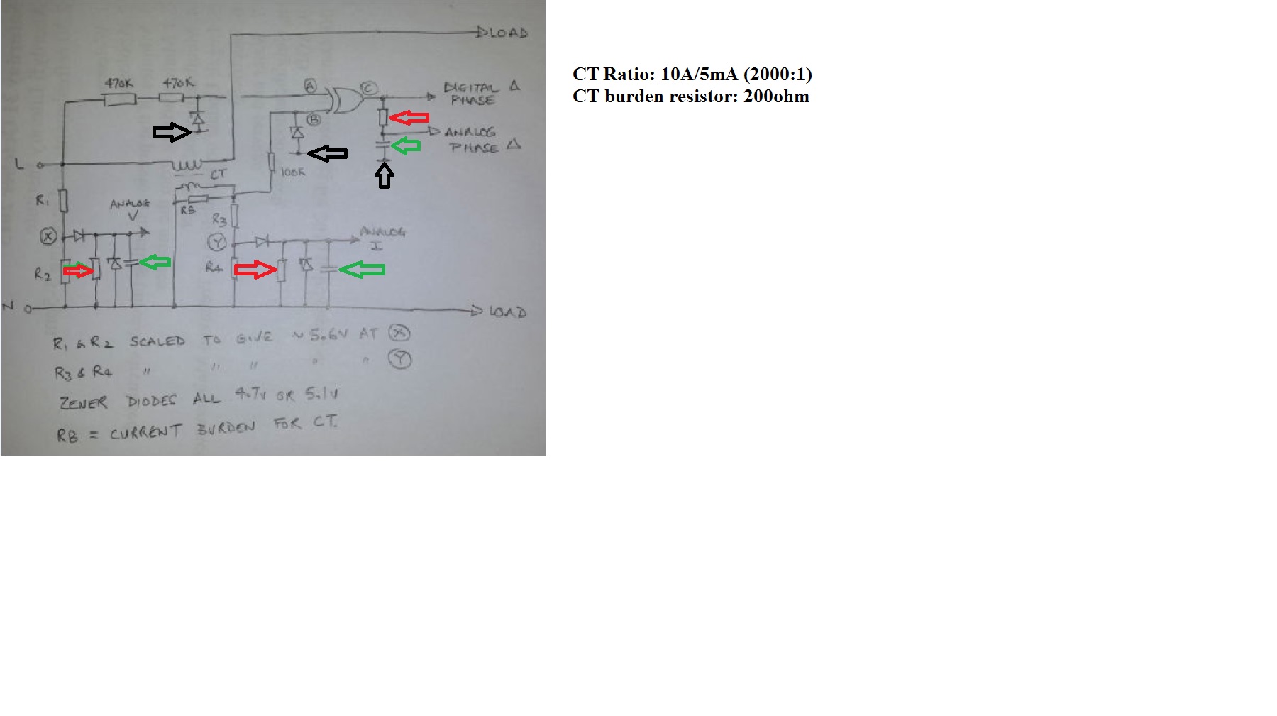

Hello all and thank you!
@betwixt, in the circuit you've posted:
1) For the AC voltage measurement, there is no galvanic isolation between mains and PIC. I already have a 230VAC to 12VAC voltage transformer, and a single phase full wave rectifier, that its output is connected to the resistive voltage divider you've drawn.
For R1 and R2 their values can be easily calculated (voltage divider circuit), but what about the resistor value flashed in red? Also what about capacitance value arrowed with a green arrow? [I assume that 1Kohm is for resistor and 10nF ceramic capacitor for the capacitor]
2) For the AC current measurement: the CT ratio is 10A/5mA, and its burden resistor value accompanied within its datasheet should be of 200ohms: with the circuit you've provided there is a problem: for max current, there is a 5mA in the secondary, and with 200ohms, you have a total voltage output of 1V: How can this (maximum attainable) value can be voltage divided?
What about placing instead of 200ohms burden resistor a resistor of 10Kohms, such that when having maximum current you have an output voltage of 50V and that 50V can be resistively voltage divided to have @Y an output of 5V and therefore R3 and R4 can be also calculated. What about the resistor value flashed in red, as well as capacitor value flashed in green [I also assume they're of 1Kohm for the resistor, and 10nF for the ceramic capacitor]
Isn't such circuit needs a linear amplifier (such as LM324) or the total connection must be changed to a precision rectifier?
3) In the XOR circuit: there are no problems except for the red flashed resistor value as well as the green flashed ceramic capacitor. I assume that the black arrows corresponds to neutral nodes.
Awaiting your reply thank you
@KhaledOsmani:
I see you are confused.
Klaus
Hello Klaus, much thanks to you.
For the path to be followed, I say let's go after betwixt method, with the circuit he'd posted:
After solving its complexities (posted a comment about it, of resistor/cap values, as well as other difficulties regarding CT circuit) we start a coding routine, in order to feed the PIC analog pins with equivalent V, I, pf, using mikroC compiler as "universally accepted coding language" that I hope to grasp as much as I can as faster as I can from its essentials (I have other courses to study, midterms, projects)
Thank you dear

Thank you Brian!
All the analog circuit you've provided will work great (no need to be accurate 100%) but the whole CT circuit is a problem, and will NOT work IF referred to CT datasheet:
The burden is 200ohms, so for max load current the secondary would be a 5mA, that gives a secondary voltage of 0.005*200= 1V << this cannot be held at your voltage divider/filter circuit.
May help at this stage be only about CT circuitry.
Can I branch at CT circuitry a burden of 10Kohms or 1Mohm such that your circuit can be applied somehow, but
I won't be able to supply higher than 1A load?
Or should I post a precision rectifier circuit and you help me building it by giving its R/C parameters?
PLEASE at this stage the only help I'll benefit is constructing the CT circuitry with a 10A/5mA CT.
Thanks

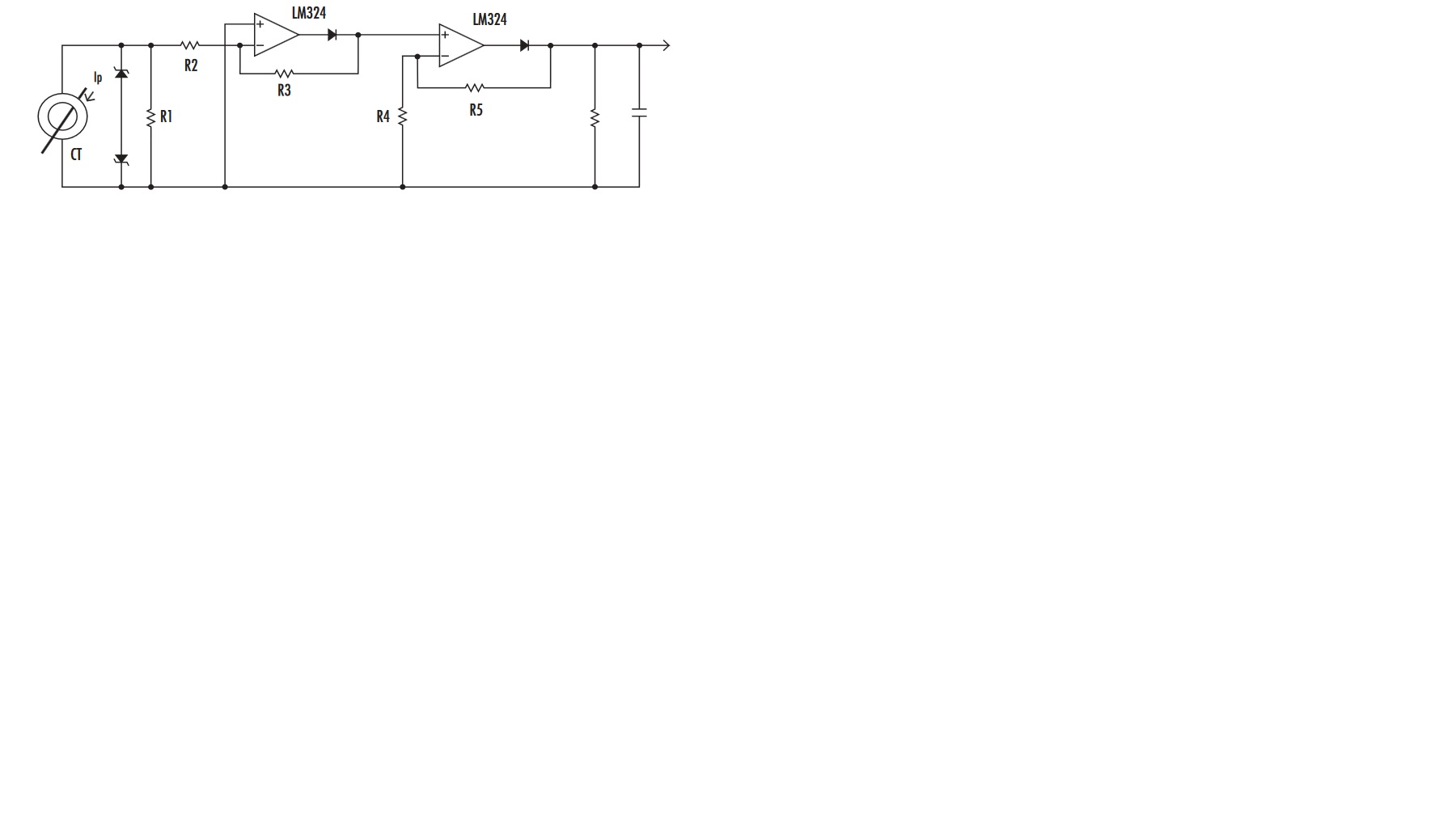

Hello,
Trying to consider the following CT circuit:
CT: 10A/5mA
R1 = 200 ohms
R2 = R3 = 2Kohms
R5/R4 + 1 is the gain of the second stage (should be considered after testing first step voltage, and how much I would like to amplify it.
RC Circuit: C=3.2uF and R=382Kohms
Suggestions please [at this phase I`m only concerned about designed proper Vadc circuit which is already done, Iadc circuit, and the XOR circuit is nothing but taking two inputs from both adc circuits and fed to PIC]
Later on we will discuss code (C code)
Thanks
Sorry (again) too many people are asking me to do too many things at the same time...
I still can't see an up to date schematic but if I understand, you have a transformer based power supply to produce the 5V for the circuit. I assume 5V it is regulated from the rectified 12V transformer output. As the transformer output voltage is roughly proportional to its input voltage and you are rectifying it anyway, you can sense the AC line voltage by dividing down the DC before the 5V regulator.
Example, with 220V line AC you get 12V AC from the transformer, that is about 17V peak minus two diode drops (assuming you use a bridge rectifier giving ~15.5V DC at the regulator input. If you divide that with a series 2.7K resistor and 1K to ground it will drop 15V down to 4V which you can then feed directly to the ADC. With VDD as the ADC refererence you get an ADC value of 828 decimal (0x33C hex) representing 4V and a good safety margin. There is no point in using a precision rectifier for the voltage circuit as any non-linearity will be at low voltages and I think it's safe to assume you would only use this if there was sufficient line voltage to power it anyway!
For the CT, you can increase the value of the burden resistor (within reason) to make it give more V out in the secondary per Amp in the primary. You can set the value so your anticipated maximum load current gives ~5V out. The important thing to consider if you do that is the possibility of an overload making the secondary voltage dangerously high but a series resistor and Zener diode should be sufficient to protect the ADC input.
If you want to use the precision rectifier method instead, you ideally need two op-amp stages (one dual op-amp IC) with the first having a diode in the feedback loop and the second being a simple voltage amplifier. The idea is you compensate the drop in the rectifier diode with an equal and opposite drop in the feedback diode so they should be the same type for best matching. Be careful with the op-amp power supply, you may need to use both positive and negative supply rails to maintain accuracy close to 0V output.
Brian.

For a burden of 10Kohms the output resultant voltage is 40V. This 40V can easily be voltage divided.
What are the values of the Resistor (other than the ground voltage dividing one) that helps protecting with help of Zener diode, that helps in protecting the ADC input in case of overloading?

XOR method is brian's method. KlausST's method was calculating apparent and true powers and then calculate PF from them.
Dear Jayanth,
In your professional C coding, what method have you used? When I see your attachment I see a XOR circuit (in proteus simulation).
This was not your method?!
No.
My preferred solution is to feed both AC signals I and U directely without rectifier and without filtering to the ADC. Nothing else. No XOR.
