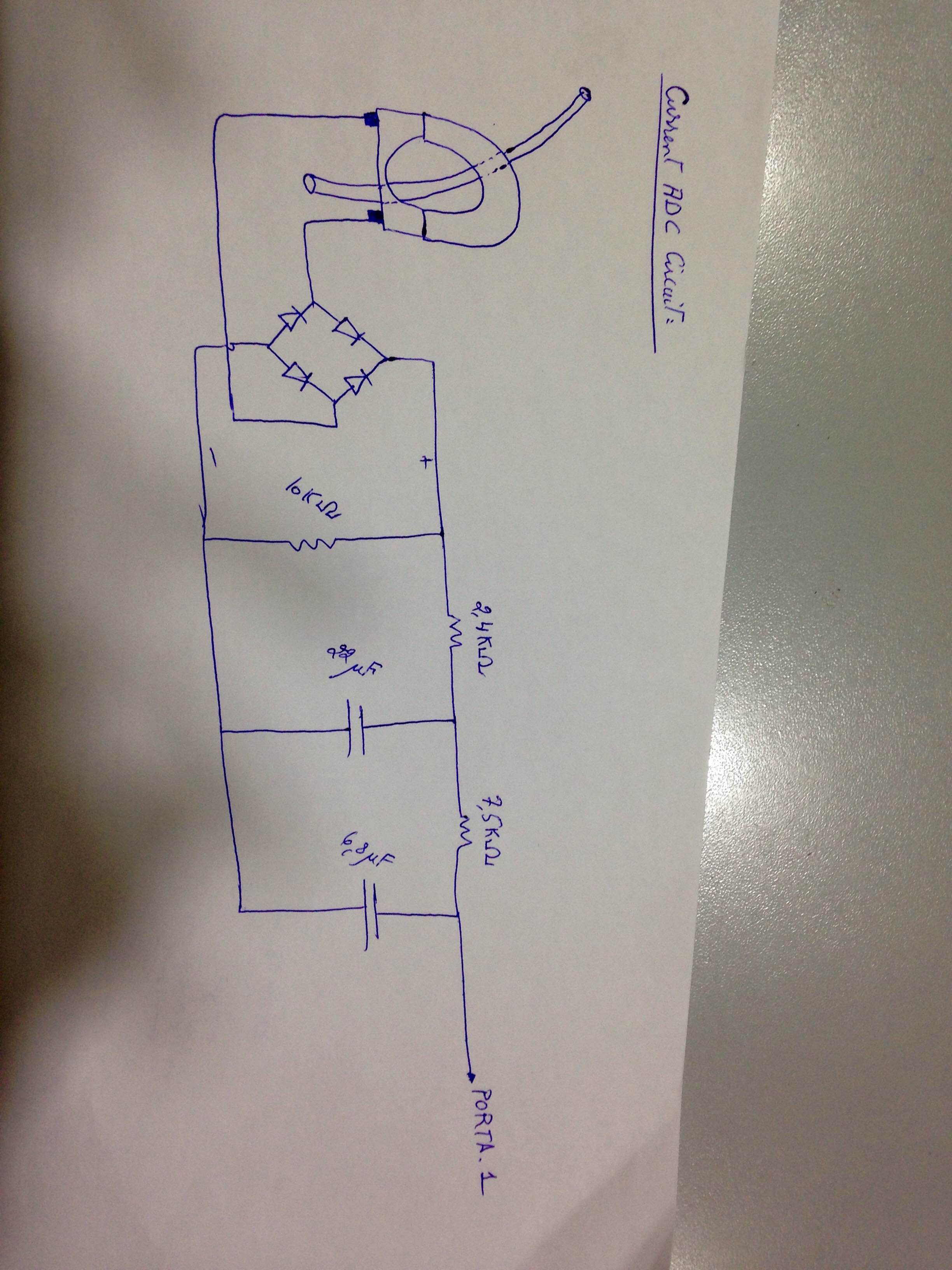

Hello,
So the CT circuit you've posted is following betwixt method not yours.
I tested it with 2nd order LPF, same as you posted it, with same res/cap values.
I've input its value to analog channel PORTA.1, 10 times, then divided the whole result by 10
I did
 Adcin 1,current
that is similar in C language to
ADC_READ(1)
No good results were on LCD, and even when load is disconnected, there still a "random" value that appears for I

Build KlausST's circuits and for V measurement input 300V AC using a Variac and provide me the V DC you get at the adc input pin RA0. For I measurement use a 200W bulb as load and measure current using Multimeter and then provide me the dc voltage you get at the pin RA1. I will write a new code.
Hello,

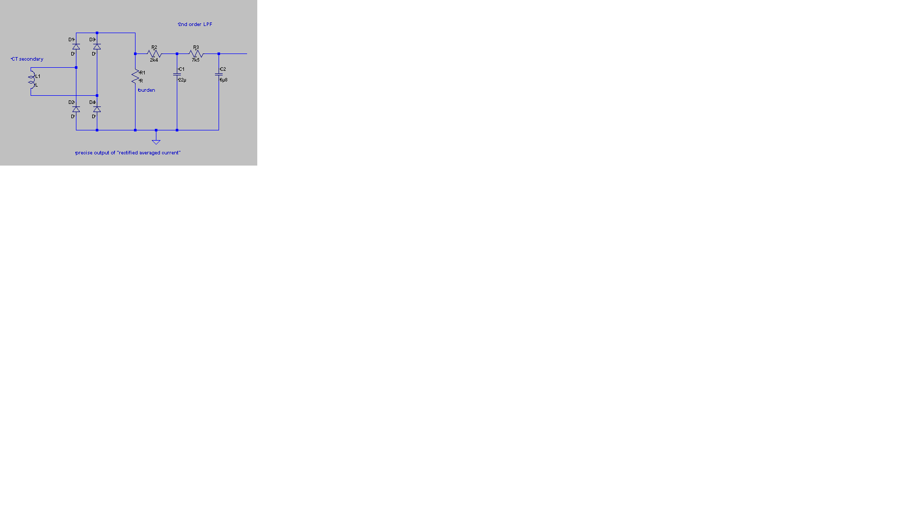

I've tried this circuit:
The above is KlausST's CT circuit. I connected to it a 200W light bulb.
Using a DVM the output voltage of the CT circuit attached is 0.075V.
So when connected to PIC, and after ADC the result on LCD must show a 0.075
Instead, when made a
adc_result = ADC_Read(0) * 5.0 / 1023.0;
there wasn't a fixed value for V resulting from CT circuit, and the value changes such that sometimes it displays "0.105" sometime "0.007" sometime "0.031" etc..
Is the problem from the circuit itself, or code changes must be done? like increasing the icounter in order to sample more Adcin values?
Changes have to be made in the code but before that why don't you give the adc input voltage you get at RA1 when 200W bulb is connected ? Give the V DC you get at RA1 when 200W bulb is connected. I will make changes to the code and provide you new code. Test it and then tell whether it gives correct value or not.
Edit:
Burn the attached project and connect 200W bulb to Current measuring Circuit and measure the current using a Multimeter. Then provide the values for V and I displayed on LCD. Also build KlausST's V measuring circuit and input 300V AC to it. LCD will show values for V and I for 300V AC and current through 200W bulb. Post those results here. Use Auto Transformer (variac) to input 300V to V measuring circuit.
@Khaled #183:
Yes. I respect your decision not to go my way.
My CT circuit of post #172 (if I remember right) is just an improvement on the CT circuit before. More linearity especially with low currents, less ripple, fast response, less electronic parts.
From my experience and simulations the output voltage of my circuit should be very stable as long as the input is stable. It is well filtered, so there is no need to average multiple values.
But you see wrong results.
To debug it:
* check the voltage at the ADC input. With a scope if you have. It should be a straight, clean horizontal line, no movements. Or check it with a DVM to see if the voltage is stable. The ripple should be less than 4mV with stable input. Tell us the result. Value, and "is it stable?"
* if it is not stable we need to find the problem in the circuit.
* if it is stable, then change your program and show the raw ADC value on the display (0..1023), no average, no other calculation.
Tell us the results.

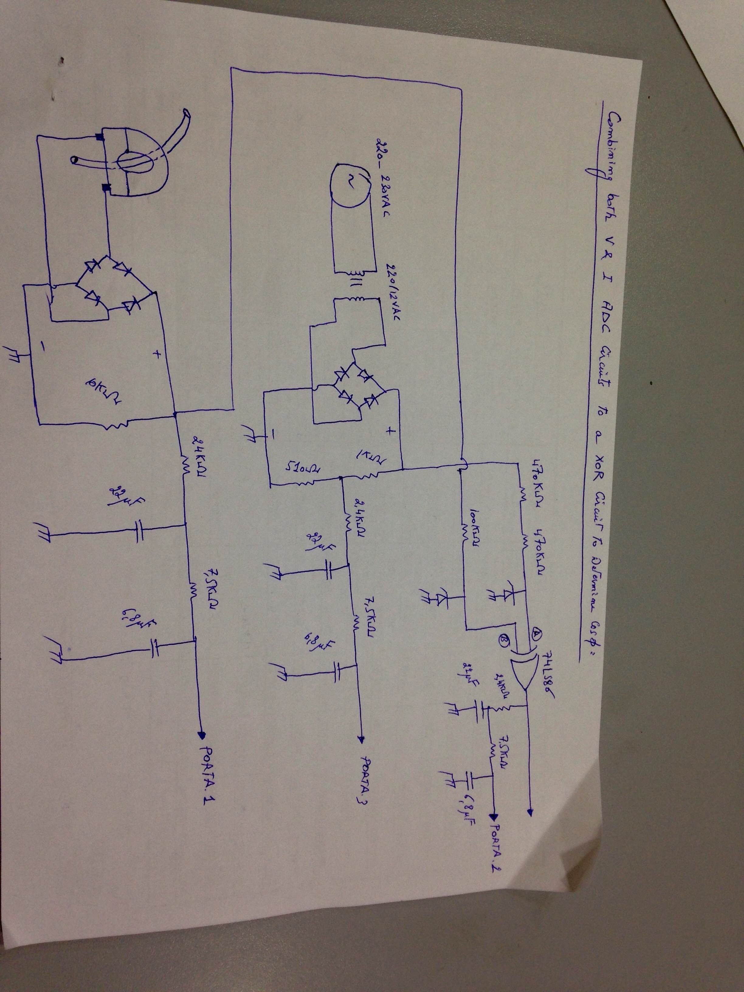

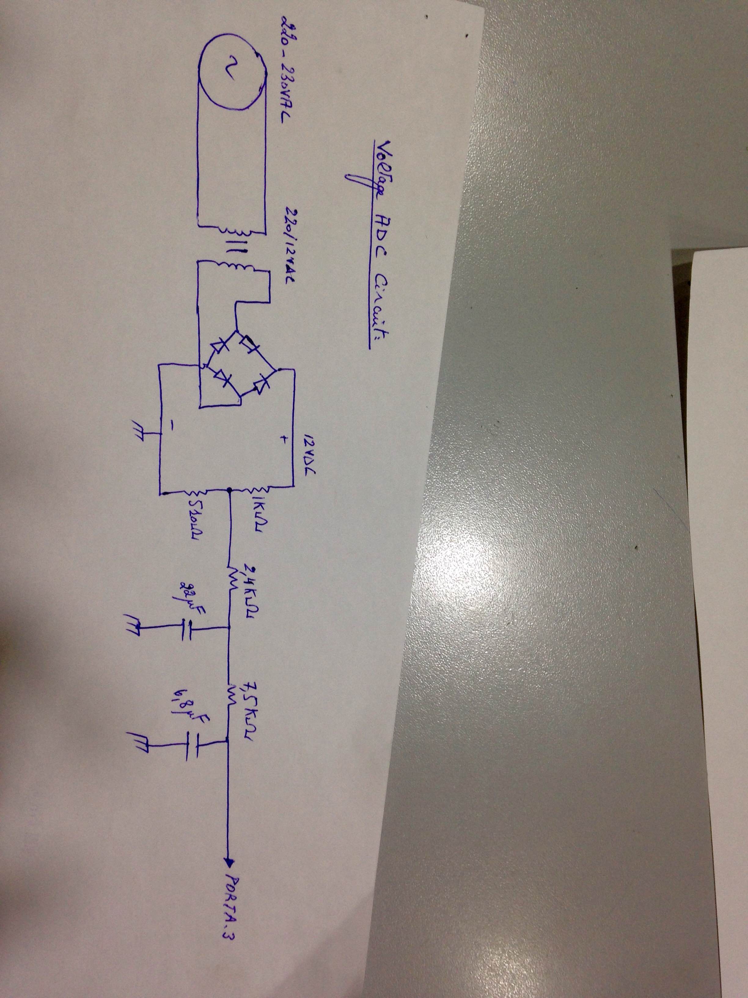

Hello all and thank you!
The following is the voltage measurement circuit:
The following is the current measurement circuit:
The result after ADC were 95% accurate, and stable. Yes KlausST What you've mentioned about this RC-RC circuit of making the system more stable is totally true. I've used them to Vadc and Iadc.
Now, I need to group these two ADC circuits, to a XOR circuit (74LS86) in order to make the analog input for phase. Following is the suggested circuit:
@betwixt I need you to confirm the XOR circuit if it is true or need more modifications, and also the flowchart of making the code for the phase angle determination in OshonSoft BASIC language, since both ADC for V and I are done with Oshonsoft regardless of its low simulation performance.
Please help me coding the XOR, also the flowchart of making the code if possible.
Awaiting replies, and comments about circuits
Thank you

About the XOR circuit I have concerns that the large 22uF capacitor may influence the circuit.
I think a simulation could clarify this.
I could make the simulation, if you want.
Klaus
The XOR circuit looks fine but you can omit one of the resistors at the 'A' input to the gate. The reason I suggested two was to increase their combined voltage rating when measuring diectly from the incoming AC line. With the transformer dropping the voltage you can replace them with a single 100K resistor.
For the output filter, the XOR frequency is also 100Hz so use the same values as the I and V connections.
The measurment method depends on whether you use the analog or digital method. Use one or the other, the result should be the same.
Digital:
You need to measure the duration of the pulse at the XOR output, the easiest way is to make it trigger an interrupt, start a timer, swap to monitoring the opposite edge trigger then stop the timer at the next interrupt. Essentially you are finding the leading and trailing edge of the pulse and counting 'ticks' between them. As the 'ticks' are at a constant rate (decided by the timer prescaler) you can convert the result directly to time.
Analog:
You measure the analog voltage from the filter. The voltage is proportional to the phase difference. Note that the highest voltage will be when the inputs are 90 degrees out of phase at which time the XOR output will be a square wave (see the XOR truth table) so it will average at 2.5V. If you want to, you can use a x2 voltage amplifier to utilize the full 5V range of of the ADC input or just accept it will be always be a little less accurate. You still get 512 steps of measurement for 90 degrees shift so the result should still be more than adequate.
You will probably have to add/subtract a small 'fudge factor' to the phase result, use a resistive load and find the difference from zero then use it to fix the result. This is quite legitimate and due to the phase shift introduced by the transformers themselves. Their shift will be constant so all you have to do is compensate for it in your results.
Klaus, the circuit is to find the average voltage of a unipolar waveform, 22uF will slow the resonse time to changes but shouldn't have any other adverse effects. The series resistor in the XOR output will protect it from overcurrent.

Am I doing something wrong ? This is OP's Voltage Measurement Circuit.
Digital:
Analog:
Brian.
Thank you Brian!
So i will replace both 470K to a single 100K.
This is the first time I interfere a code with your analog explanations.
Since it is not so critical it can be done with Oshonsoft.
Could you please provide me a sample so I can study it and try to achieive full code of output of XOR that images the phase angle?
@Brian:
I should have described it more clearly: I meant the two 22uF in the voltage and current measurement path, not the 22uF at the XOR output. My concern is that residual DC voltage from the 22uF may affect the XOR inputs.
Klaus
Both your voltage and current measurement circuits are fine.
Suggestions for improvement: just replace the bridge rectifier with a low drop Schottky diode. A bridge rectifier drops two diode drops: for 12V it will be 1.2V (roughly; you have practically zero load) drop.
Also connect a 10K in series when you connect to the port. The ADC works best when it sees a small load (please check the manual). The ADC takes very little current and the capacitors will stay charged to the peak voltage (only load it sees is the voltage divider).
If you know that your line frequency is 50Hz and you take readings for 20 ms, you will cover exactly one cycle. You can directly calculate sigma (V^2); sigma (I^2) and sigma(V.I) and the power factor.
Added:
@pic.programmer.
I see nothing wrong in your circuit, but the voltage readings make no sense...
Klaus
