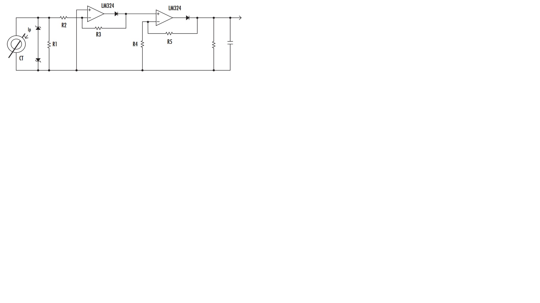

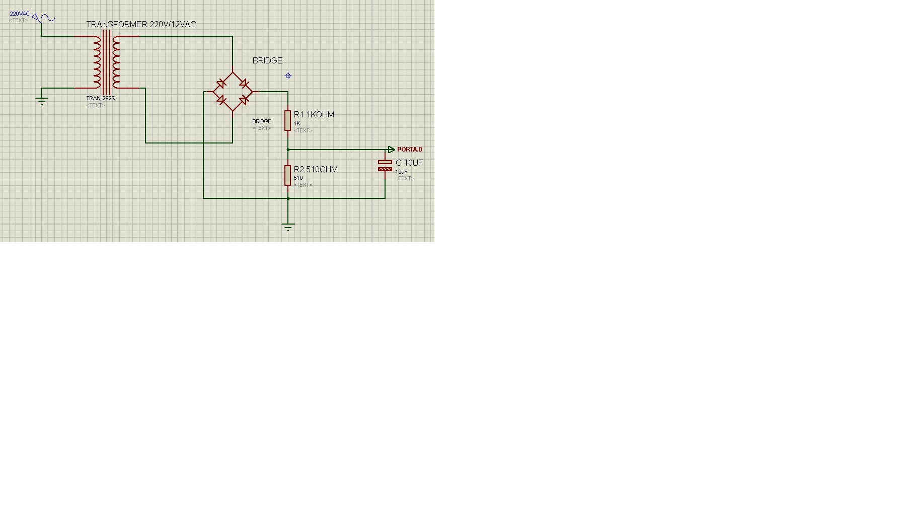

Hello,
Here is the circuit for voltage ADC in:
Here is the circuit for current ADC in:
I just need the specifications of resistors/capacitor of the current ADC in.

Hi betwixt and others
Can OP use this circuit for voltage measurement ? (Considering the method mentioned by betwixt).
@KlausST
I have never done a AC RMS voltage or Current measurement using PIC. I use PIC and I know that you don't use PIC. If possible please provide AC Voltage, Current and PF measurement interface circuit for AVR and also C Code for it. I will port it to PIC for the OP.
Test this circuit. Use exact resistor values. measure all the voltages and post it here. You have to vary the current from 0 to 10A for your CT primary and it will give 0 to 50 mA at secondary then post just the voltages you get across the output of bridge rectifier and the two resistors for some random values between 0 to 10A. Don't connect it to PIC.
If the voltages vary properly then it can be connected to PIC and used with my code.
The voltage and current measurement circuits that I have provided doesn't work with KlausST's method.
You can't use 1k resistor across the CT's output because 50 mA * 1k = 50V.
@KlausST

The CT ratio is 2000:1 of 10A/5mA NOT 10A/50mA.
I can't apply the resultant resistor voltage to PIC, it must go through a precision rectifier, then enter one of PIC's analog channels.
The precision rectifier that I've previously uploaded, needs its parameters to be set up.
Can the voltage ADC image be used also? Or it must be an op-amp based circuit?
Then use 1k resistor for CT Circuit. The voltage measuring interface circuit is for betwixt's method and not for KlausST's method. Build both voltage and current measurement interface circuits and measure the dc voltages across the resistors for some random value of mains voltage and current and post it here.
If the voltages at the output of these circuits are within 5V dc then you can input them to PIC RA0 and RA1 (RA0 voltage and RA1 current) and use the attached project to test it. You also have to use ZCD circuits at RB0 and RB1 for PF measurement. The ZCDs should give the signals as shown in the image otherwise it won't work.

Sorry - I'm travelling at the moment so I've scribbled this and photographed it on my mobile phone, sorry the quality isn't good. I'll write more later. Brian.
