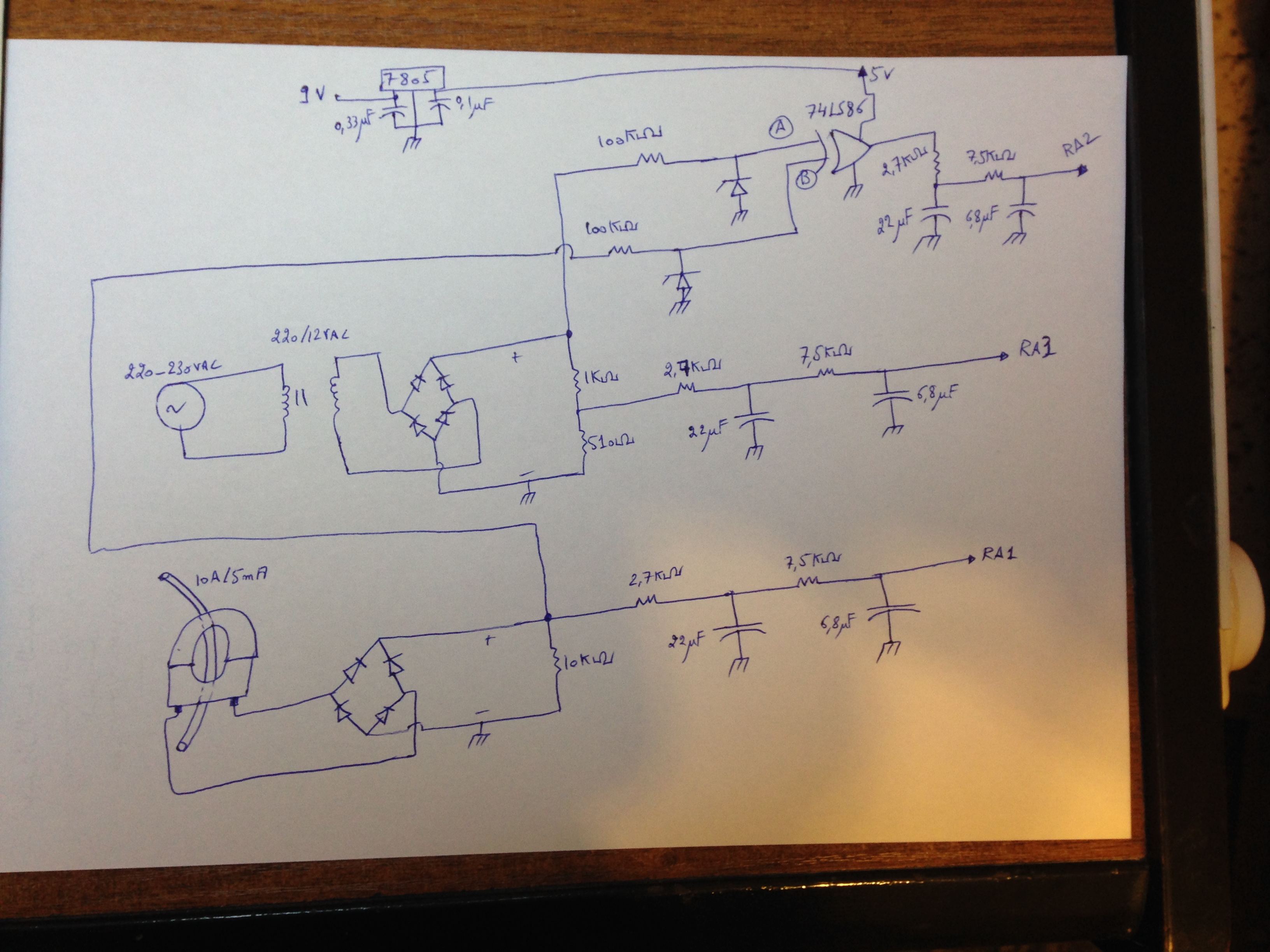

Here's the final of what we've been up to:
Following is the analog schematic for V, I, P, and Phase angle measurement using PIC18F4520:
Notes about the total P,V,I,pf circuit:
1) I've fed the 74S86 from another supply voltage than the PIC's supply, since it consumes too much power and affect PIC as well as LCD functioning.
2) I've connected a 10K resistor as a burden for CT, because at this level, the maximum load I want to test is of 1A
The following is the CODE for the above attached image, using cursed Oshonsoft compiler:

What I ask for is the following:
1. How to make voltage reading [whether by hardware/software/both more stable and accurate
2. How to fix the Cos() function in Oshonsoft compiler
The cosine after the code that I've posted, is almost stable for all loads, at 0.995 or 0.993 for the 200W light bulb, as well as the 60W fan. This is not true, and I hope we can solve this.
Thank you!!
First you have to discover where the error is. Can you see the instabilities with a DVM. Or is it stable?
If the analog value is stable, then the problem is on the microcontroller side. Either Vref or GND (maybe VCC) is fluctuating, the ADC timing is wrong, or the value is processed wrongly.
Klaus

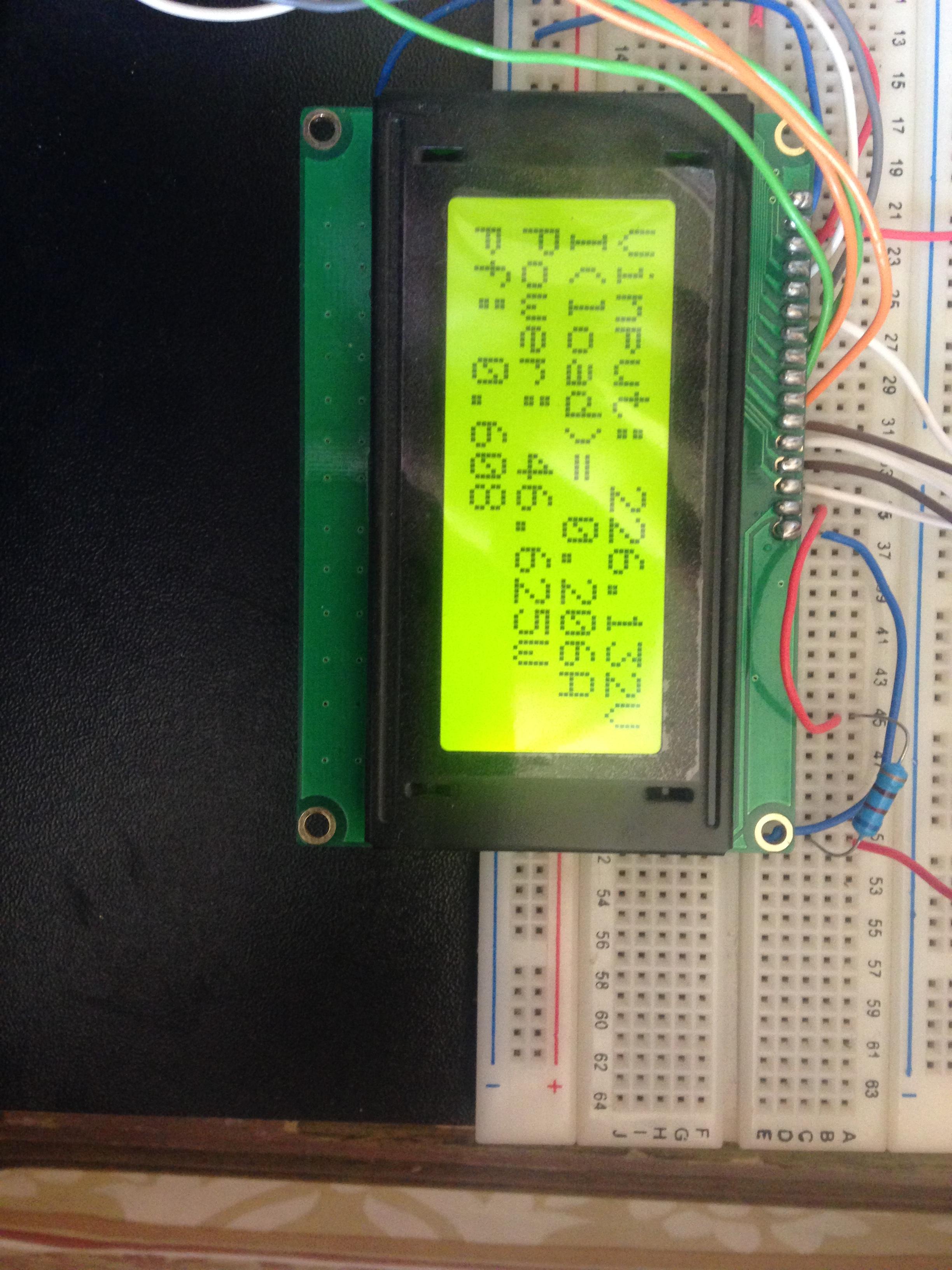

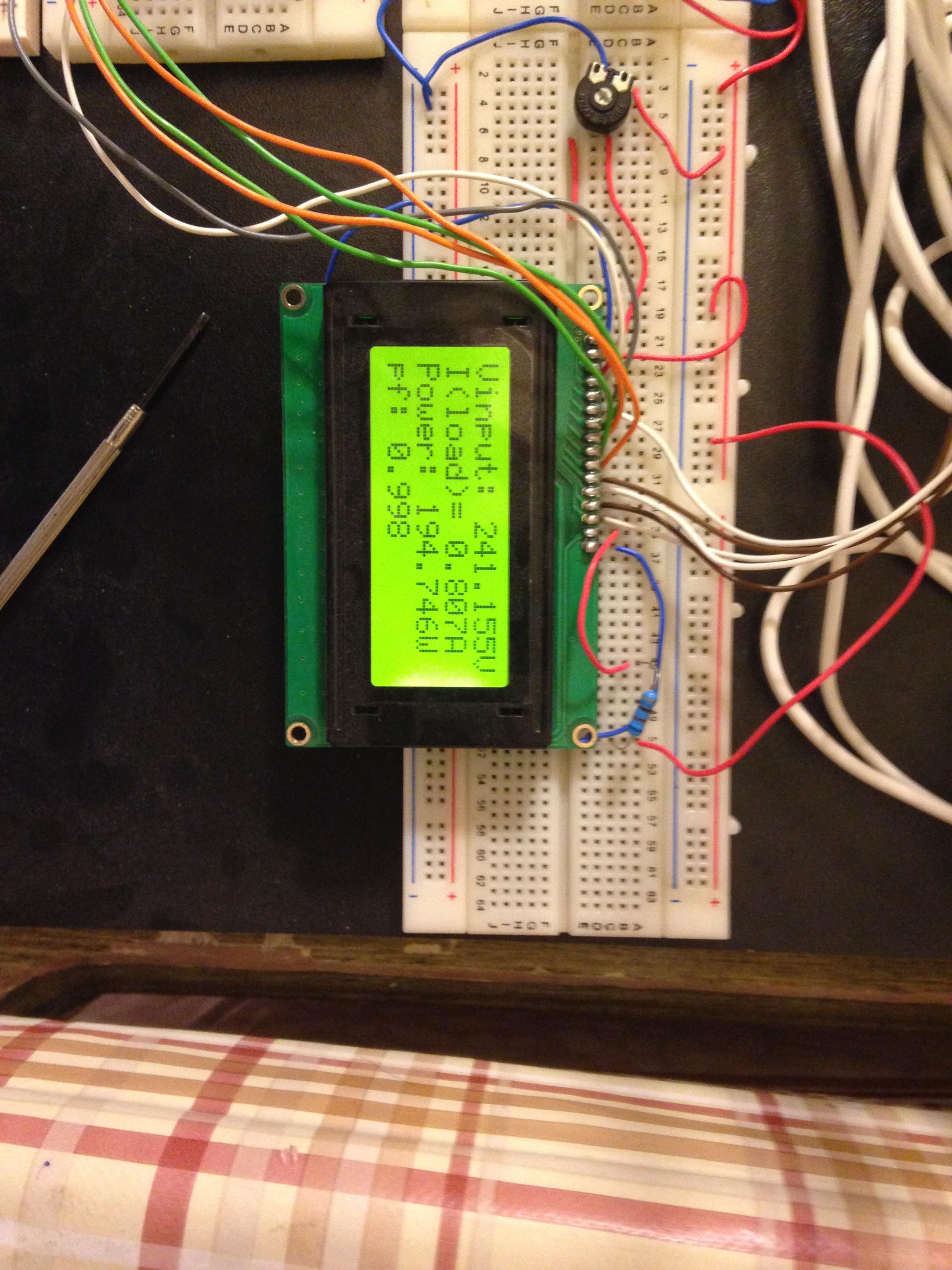

Hello,
I`ve made a test to determine Oshonsoft cos() output code, and the results were same as betwixt concluded, it proceeds the cosine value in Radians.
I've made the following:
y = 60
cosy = Cos(6)
Lcdout "Cos(60) = " , #cosy
The result was: -0.952 << This is the identical result of making the cosine of angle 60 In radians.
Since I want the result in degrees, I've made the following: Transforming degree angle to radians and having its cosine.
For example: 60 in degrees is same as 60 * pi/180 in radians, where pi/180 can be noted for a Single variable as: "0.0174539"
So, Cos(60) in degrees have the value of 0.5 and using Oshonsoft the 60 degree must be multiplied by "0.0174539" where also same result as in degrees take place.
Cos() function problem is solved
I've tested the system for the 200W light bulb, this is the observation on LCD:
I've tested the system for the 60W fan, this is the observation on LCD:
So far, the most accurate ADC measurement is the current measurement [thanks to KlausST circuit improvment]
but there is problems with ADC measurement of Voltage, as well as the phase:
the V value shown on LCD, fluctuate from 216VAC to 225VAC when real supply voltage is around 220VAC
the phase shownn on LCD, also fluctuate from 35 to 50 degrees for the 60W fan load.
How to make these two non-accurate ADC measurements more precise?
The 220VAC to 12VAC voltage transformer could sometimes be applied to a 230VAC supply, instead of 220VAC, so its ratio number is not precise for all time. Maybe this is the only problem?

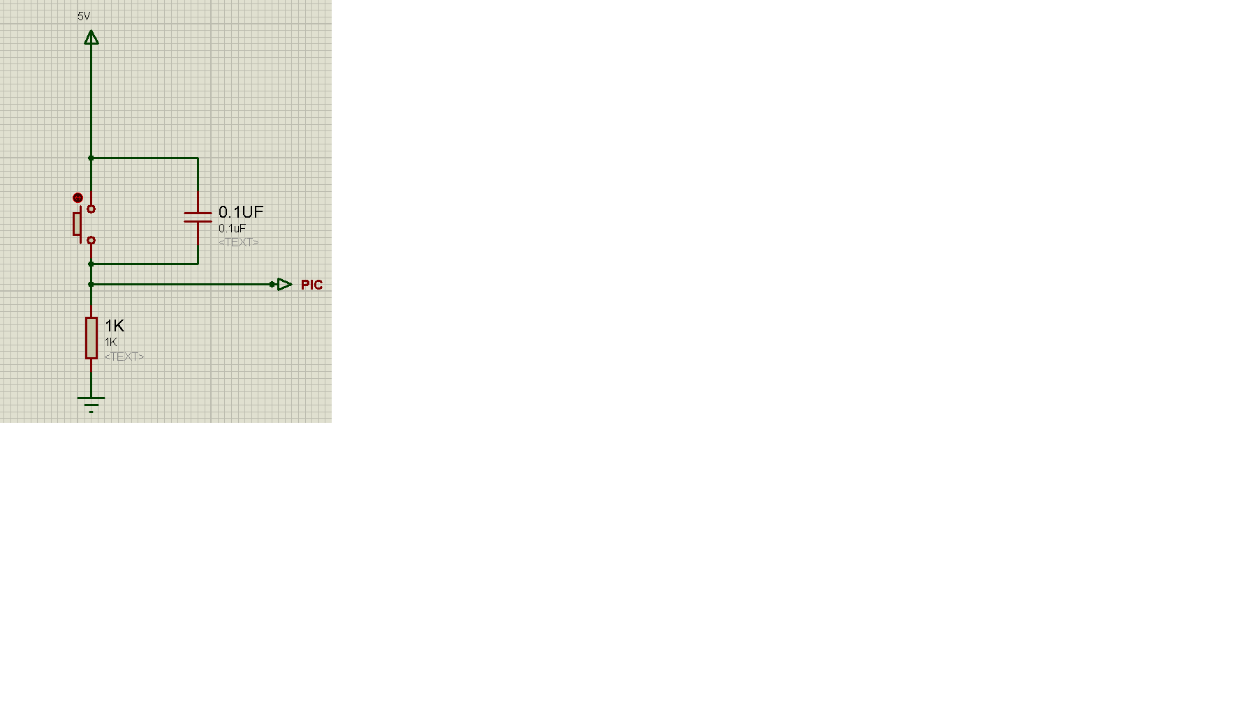

This is not a problem, what I`m asking about is the RC de-bouncing circuit for such types of push-buttons:
It is rated at 10A, will the following de-bouncing circuit helps:
Thanks
The circuit is simple.
But it is unsymmetric:
When the button is pressed an incalculable high current discharges the capacitor immediately. The voltage at the port pin rises extremely fast. The high current pulse causes EMI.
When the button is released the capacitor is charged ... slowly ...with the resistor. The voltage at the port pin falls slowly.
I'd use an additional series resistor, may be 4k7.
Push button and your 1k is connected like in your curcuit. Then the series resistor to the port pin.
The capacitor instead at pushbutton --> directely to the port pin.
Klaus

You could try increasing the ADC sampling time to improve accuracy. I can't guarantee it will help but if you switch channels too quickly, some of the previous charge on the sample and hold capacitor can remain and cause a wrong reading. You can check it by increasing the "Define ADC_SAMPLEUS =" setting. Typically when the value is too low for the selected conversion speed, you start to see some interaction between the voltages measured at the inputs, for example, if AN0 increases and the next channel you select is AN1, you see an increase in that too.
The debounce may be adequate but I would increase the resistor to 10K and wire a 1uF capacitor across it, also add 100 Ohms in series with the switch so it's contacts are protected against charging and discharging current. The input pins of the PIC only need a tiny current so it is quite in order to use larger value resistors for pull-up and pull-down. How much debounce time you need will depend on how rapidly your software reads the switch input again and of course the actual contact bouncing time. You might be able to get away with just adding a delay of say 1mS after detecting the switch is closed or opened.
Brian.
Well done!
Brian.
Hello Brian and thank you
What causes PIC not to detect a button once pushed?
As you see in the attached image of debouncing circuit, its connected using a pull-up resistor, so when pressed the pic must detect a high logic on that pin.
I've connected the output of switch to portb.0 and coded:
If PORTB.0 = 1 Then etcc
But the pic even when switched the button didnt respond, although voltage at input pin is high
I tried to longer lasting the push, also same results
Is it because of what you've told me about PIC18F4520 processors of default analog enabling state after switch on or reset?
Or?
Thanks
ADCON1 has to be configured and debounce delay has to be used in code.

80mS is overkill, most switches will settle in <10mS but how long is needed in the program depends on when the switch is next checked. The debounce is only important if there is a risk of the the input being read more rapidly than the contacts settle and it being seen as in the wrong state during the bounce period.
Khaled, look at table 19-2 on the data sheet, it tells you the bits you have to set in ADCON1 to make the pins analog or digital. They default to analog when the PIC is reset for safety reasons.
Brian.
@betwixt
I use mikroE development boards and I use 80 ms debounce delays in mikroC Code and they work fine on the hardware.
