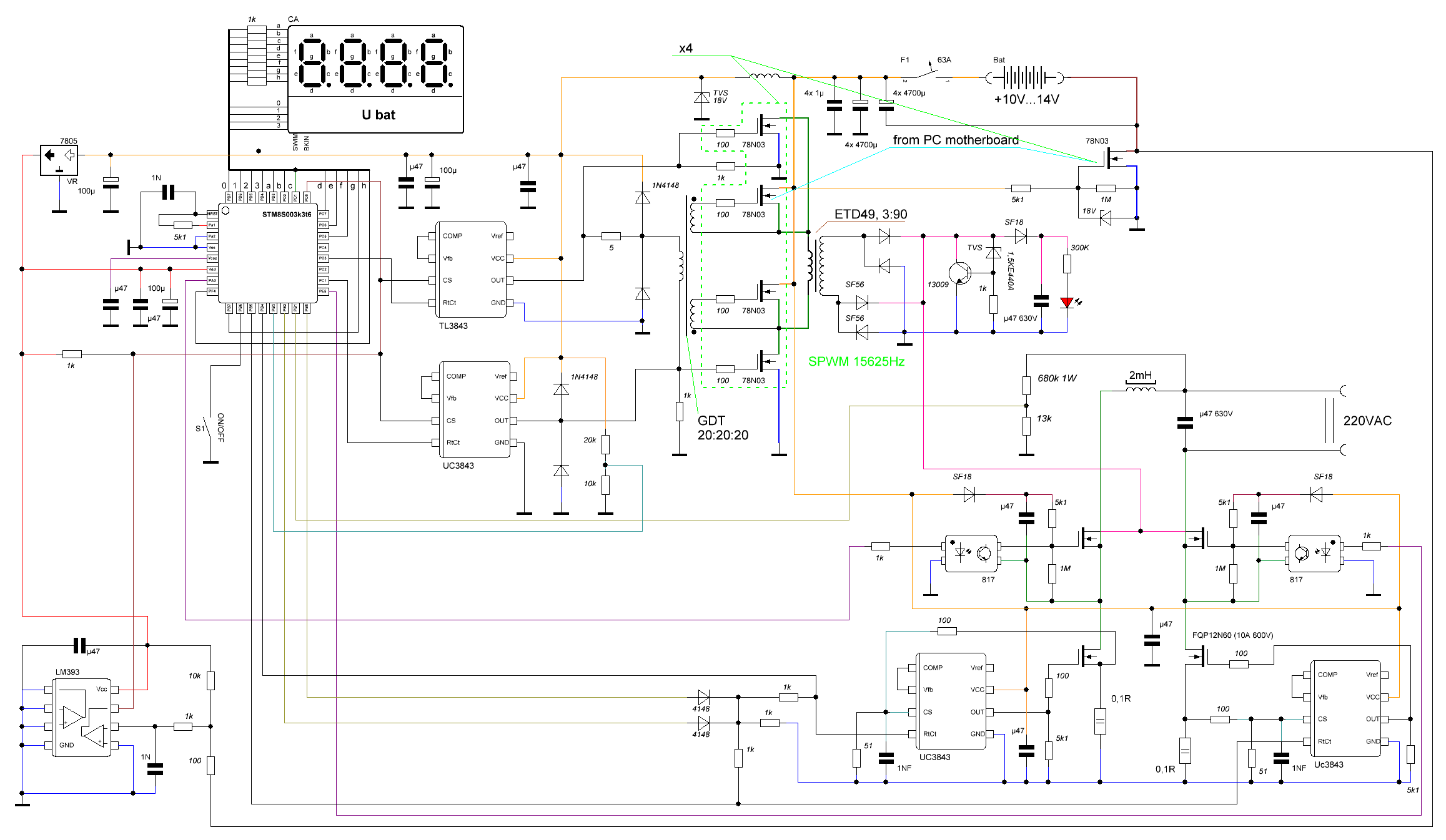

with ATMega8 i have preferred to do scheme like that (not tested) -
Sir do you have a full version for this? I want to try it but it is impossible if there is no voltage correction or feedback. Thank
Worked version of converter already mentioned at message #378.
Tested only with small ACIM load.
  • c hex pcb schm _ fbus_pplf swi.rar
final version. tested with "Kress WS710" angle grinder.

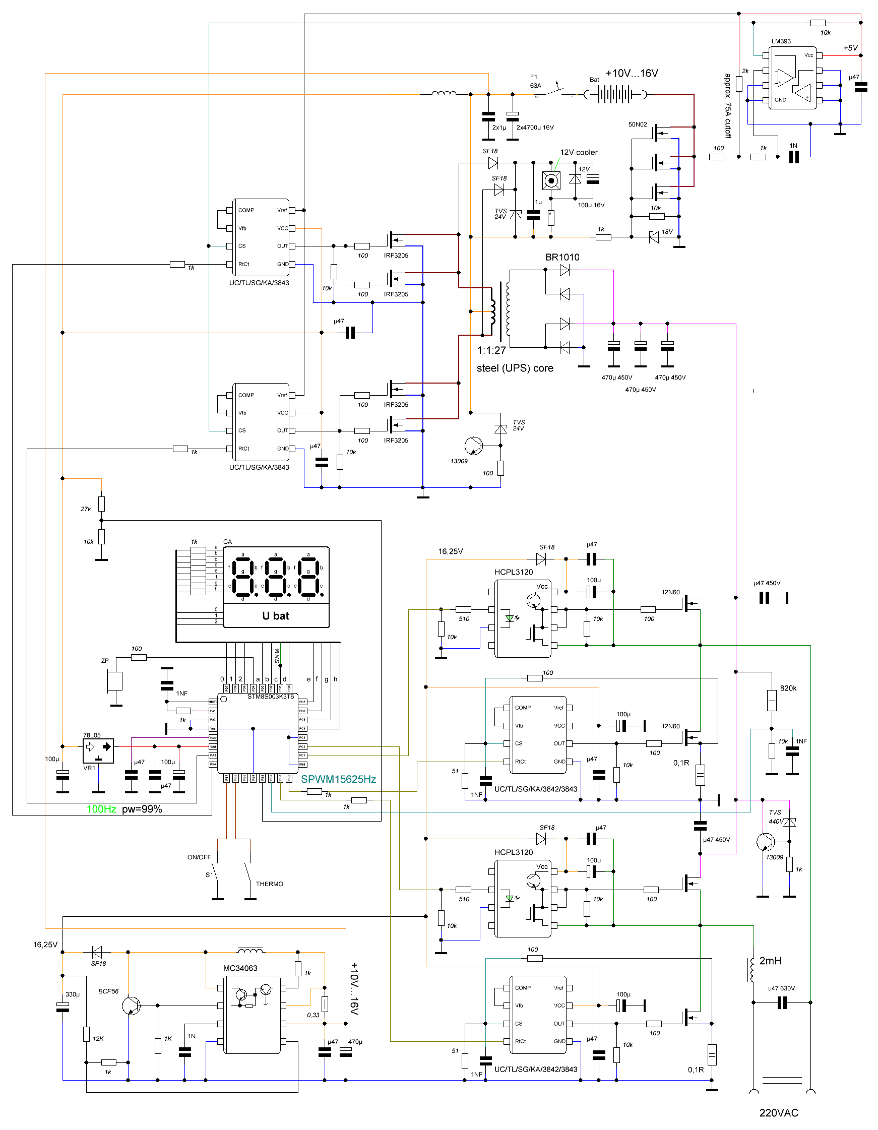

i think it is possible to double output power
  • hex_v2.zip

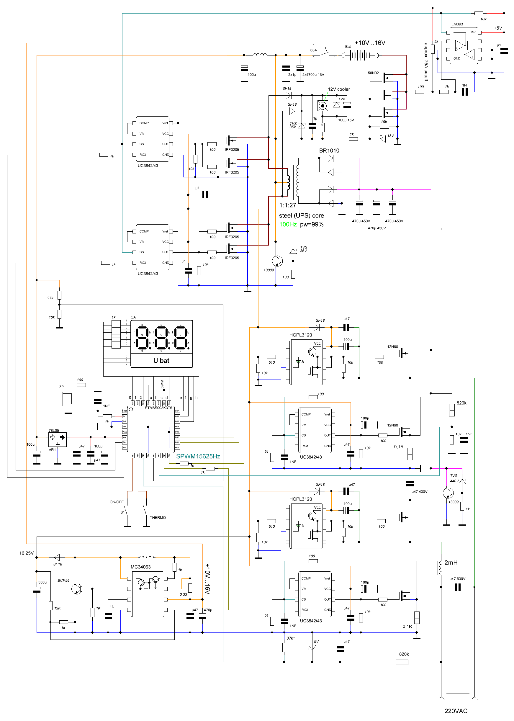

Something similar, but with high frequency DC_DC stage
  • c hex.rar

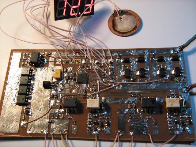

worked version (tested with 100W ACIM load)
  • c_hex_pcb_schm.rar
apropos - a 1,5kW project with switchable (depends on load) DC_DC channels in step_up stage. not ready yet )
