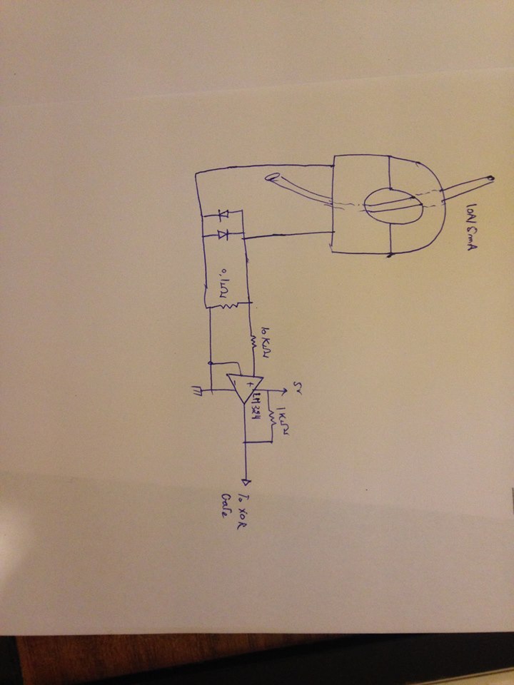

The problem might be from the CT circuit:
I`m using a 10K as a Burden, and here is the aspect:
"you are asking your current transformer to drive a load of several thousand ohms plus two diode drops.
There is a term "Burden" in metering jargon that refers to the load which a current transformer is asked to drive.
A current transformer should be operated with a load as close to zero ohms as you can achieve. You measure its output with an ammeter not a voltmeter.
The higher the "burden" the less accurate the current transformer. And the greater its phase shift. Here's why.
It has certain inductance even with only a one turn primary
and voltage across its one turn primary is L di/dt of course
and voltage across its secondary is larger by the turns ratio.
Now if current is Isin(wt) , voltage is Ldi/dt = L X I X wcos(wt) and that's a 90 degree error in your phase measurement.
The correct way to operate a current transformer is with its secondary so nearly short circuited that its voltage is insignificant.
(Ideally it'd be absolutely shorted but zero ohm wire is too expensive)
That lets it produce current in secondary that's in phase with primary current
we usually measure that with an ammeter
Here is the improved version of CT circuitry:

I don't think the pf problem lies in the ct circuit.
The ct circuit works with the fan..it shows the current,
And it works with the capacitors...it shows the current.
The ct doesn't know about the phase shift between load voltage and load current.
Therefore i think it is a problem how you measure pf.
I don't say there is no problem with the burden...but that's another story.
Please try to solve one problem first, then the next. Try to solve it by verifying the signals step by step.
Klaus

Klaus,
The CT circuit is working fine regarding measuring the amplitude of current. But it is in turn introducing a huge phase shift, caused by large burden.
In its datasheet the rated burden is of 200Ohm, and with it you have around 10' <<< according to this, the phase shift will be >10' as long as you increase the burden, and in my case the burden is 50 times bigger, so the phase shift should have a larger error.
I put a 10K burden since I aimed to maximumly have a load of 1A:
With the CT ratio: 10A/5mA if I put a load of 1A, I have an output voltage of 5V, which is great for ADC input channel.
I thought that putting a 200Ohm as burden, would have a severe insensitivity, since maximum load of 10Amps (which is not intended for this project) would result in a 1V to ADC input, so for lower loads, I thought that maybe the PIC won't be able to detect the <<1V voltages.
But from another part, increasing the burden revealed an increase in phase shift error that affects power factor measurement. From one bright side I had a sensitive current amplitude measurement circuit, especially thanks to your RC circuit, but from the dark side, the phase shift got majorly inductively affected.
So regarding your step by step analysis:
1) I have an error while measuring pf for capacitive load due to phase shift created by CT inductance
2) I still couldn't figure the right capacitance (that lies generally below 1uF) to correct power factor of an inductive fan, that its power factor can be accurately measured by the system.

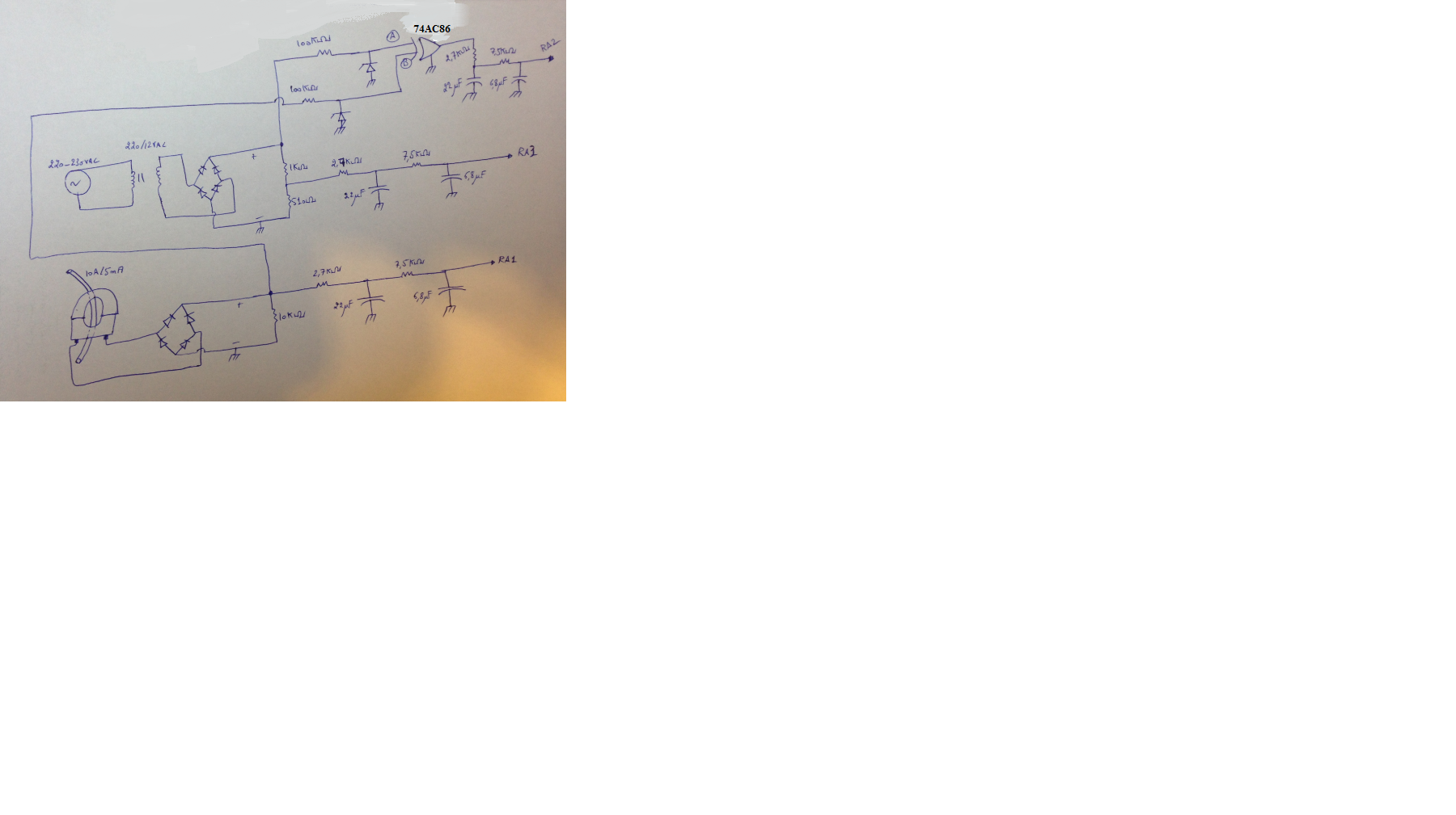

Dear Brian,
Thank you!
I plugged 12uF with two 100K 2W series bleeding resistors across it. This was my load.
The resultant phase was 0. I grabbed a DVM to see the output of the XOR gate, that you said it shall be around 2.5V:
I saw it almost 0V!
The voltage input was around 5.5VDC for first channel of XOR gate, and the current input was around 3.5VDC for second channel of XOR gate, hence 1 XOR 1 = 0 and this is the 0 I`m seeing on the third pin of 74HC86N that in turns shows on LCD.
It is assumed to output a high logic, but it showed 0 instead.
This is the error.
Thank you

@betwixt perhaps there is a problem with the inputs to the XOR circuit from this:
Caution!
The two input voltages are waveforms (rectified AC) so the DVM will not measure them properly. Each signal should be clipped at Zener voltage to protect the IC but still going to zero periodically. If you picture the two waveforms exactly in step with each other, as you would get with a resistive load, the XOR inputs would go to zero simultaneously (0 XOR 0 = 0) and go high simultaneously (1 XOR 1 = 0). It is when there is a phase difference the XOR output goes high. That's how the circuit works, the phase difference produces pulses at the XOR output then the RC filter averages them so you can measure a steady voltage with the ADC. The bigger the phase difference, the wider the pulse will be and so it's average is also higher.
You really need an oscilloscope or logic analyser to check the waveforms. You also get best resolution when the waveforms have 50% high, 50% low logic levels. The accuracy is reduced if the logic low only occurs briefly near the zero crossing point because time in which the waveforms can overlap is smaller.
I have lost track of the schematic you are using at the moment, can you post the part between the AC input and the XOR gate again please so I can be sure we are talking about the same circuitry.
Brian.
edit: sorry - it is only when I posted this first I could see the image in your previous message. Can you try making a small modification please. Instead of the XOR inputs coming from the output of the bridge rectifier, can you wire them to the top of the transformer secondaries (as in the diagram) through a diode in each wire please. The diodes should have cathodes (+ end) toward the 100K resistors. What I am trying to do is make only one half cycle of the waveform reach each XOR input so they see nearer a square wave than pulses.

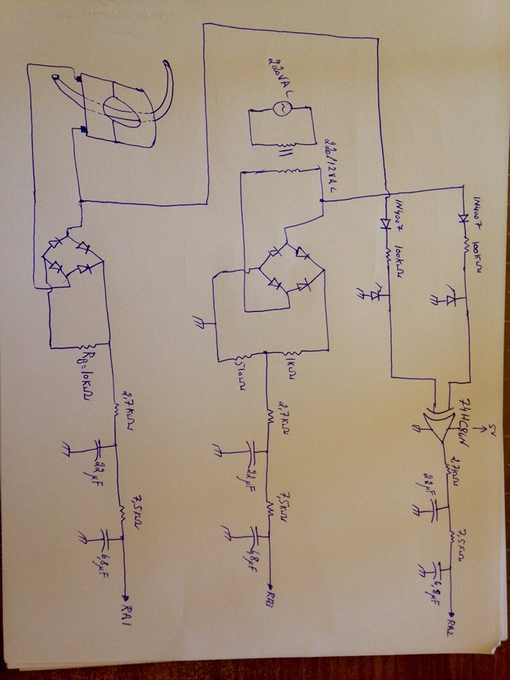

Hello,
@betwixt:
I've changed the circuit:
Into the following:
I've seen a more satisfying results as:
1) 200W resistive bulb showed a phase angle of 43deg
2) 12uF cap bank AND 60W inductive fan showed an almost equal phase angles of 22deg

You have put very high capacitors in the output section. I suggest that you replace the 22uF capacitor by 0.2uF (or 0.01 uF; my suggestion) ceramic capacitor (in all the sections) and also remove the 6.8uF capacitor completely.
22uF capacitor with a 10K (say) will give a time constant 220 ms which is too large - we need to read the values as soon as the result changes - the time constant should be around 1 ms or less. That means that even though the output of xor changes, it is not seen by the PIC.
Also replace the bridges with low drop type diodes (this change can wait).

I think the circuit is working in a reciprocal way:
When 200W resistive bulb is connected, theoretically, the inputs of the XOR should be both high (1) and hence the output (corresponding to phase angle) must be equal to zero. But using this circuit (attached previously) what I`m seeing is around 4.5VDC at the XOR output that corresponds to high which should be low.
Maybe the XOR IC is provoking this? Here is its nomenclature:
74HC86N
AC668 06
Un03180
**P.S** This is a new noticed problem, that shouldn't be present. The remaining problem must only be improving the power factor of the 60W fan to 0.85 LAG using shunt capacitance whose value must be calculated with PIC and displayed on LCD.

Hello c_mitra,
I removed the large 22uF from the XOR circuit output and replaced it with a 10nF, also removed the 6.8uF completely.
The result was the same.
It showed a 43° for a purely resistive load.
Note that before you told me to plug 12uF across the main to see the resultant pf, the system was working good:
showing 0.000 as a phase for the 200W bulb, and 43° for the fan.

Let me understand:
Now (with reduced capacitor values on the three ports) you are getting phase as 43 for a 200W bulb and a phase of xx (what is the value) deg for a 60W fan.
What is the phase you are getting for the 12uF capacitor put across the mains? (with the new values)
Once you make this point clear, we need to see the software part.
