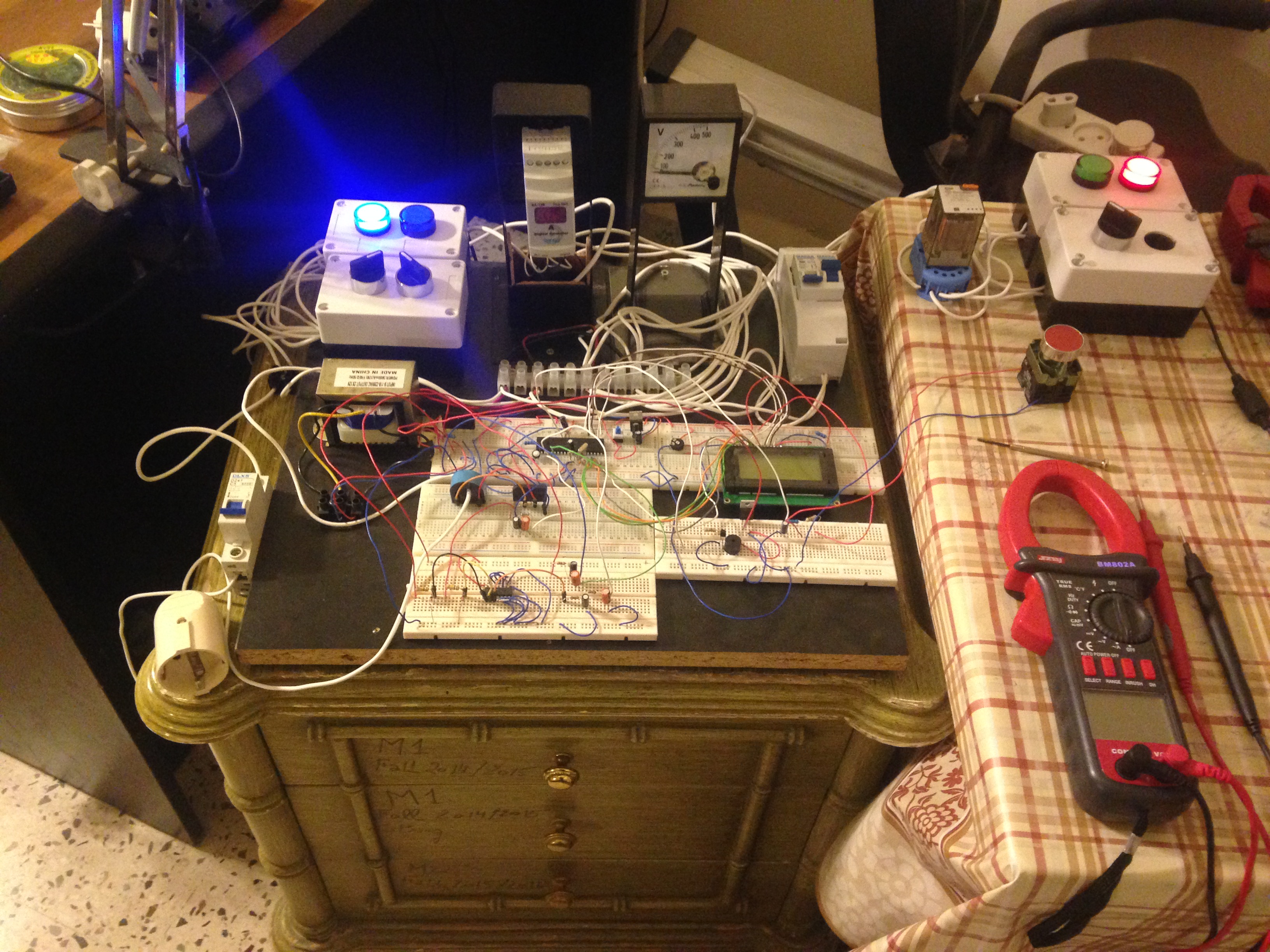

When unplugging the load, either by removing it from socked, or by switching off its MCB, the system behaves as if the user had pressed the push-button.
Thank you

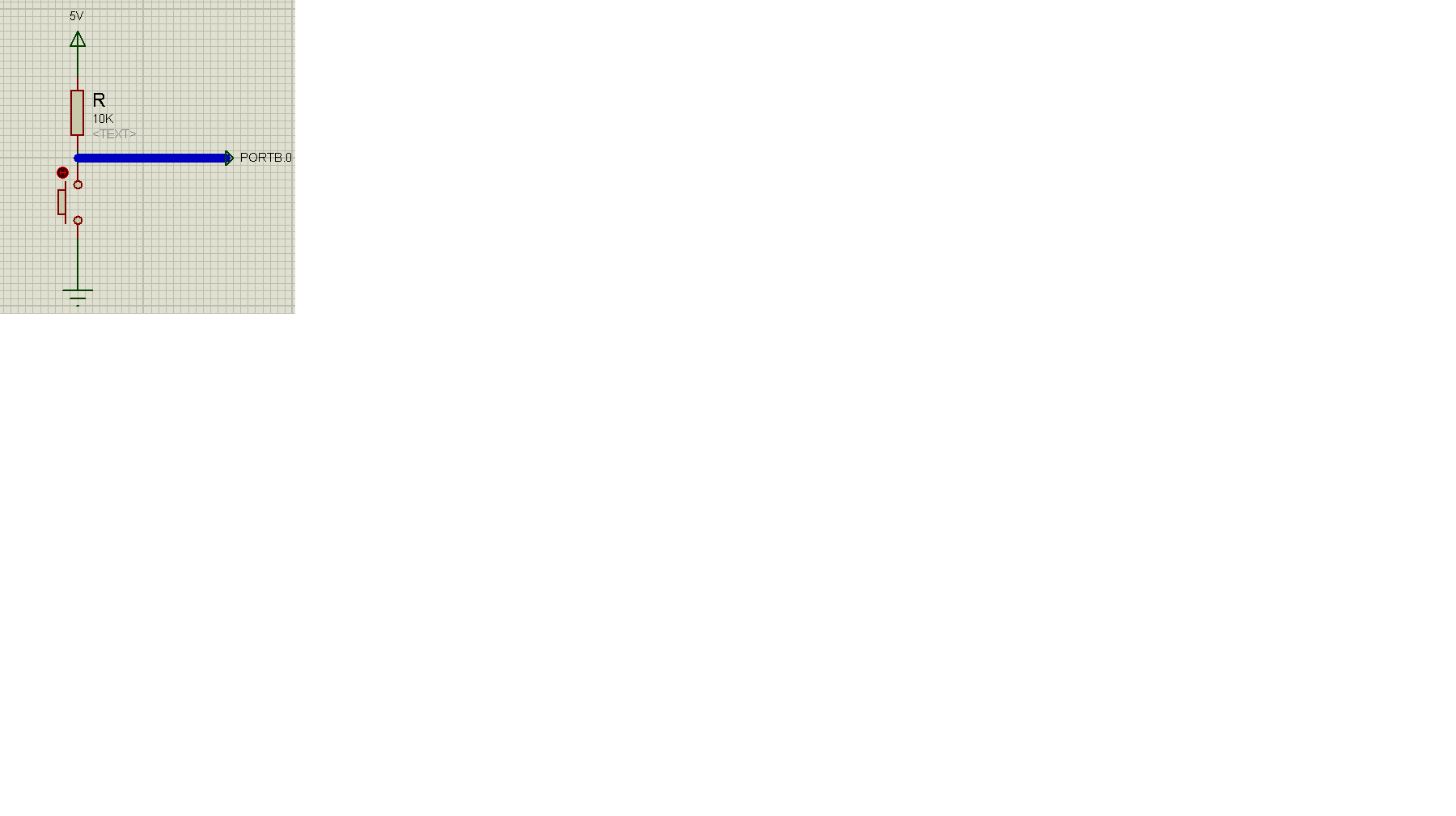

I've changed the push-button circuitry from using a pull-down resistor, to a pull-up resistor like the following:
I've used a DVM to test the voltage at the wire heading to PORTB.0, it showed a 4.96VDC when switch was not pressed, and 0V when switch (push-button) is switched. The image of pressing the push-button between VDD and VSS as a short, is maintained by the 10K resistor.
I also changed the ISR code, to detect a Low instead of High:

I see the problem. If you change the code back to "On High Interrupt" and "Enable high" it will probably work again.
In the ISR, "high" and "low" refer to the interrupt priority, not the polarity on the interrupt pin. The PORTB.0 interrupt is always high priority so when you changed the code to "Low" the ISR would never be called. It would still generate an interrupt but instead of your ISR it would go to some other routine decided by Oshonsoft which is probably just a "RETFIE - return from interrupt" instruction.
You are right in thinking you have to change the edge that triggers the interrupt so instead of looking for the rising edge when the switch connect the pin to VDD, it looks for the falling edge as it connects it to ground. That means bit 6 of INTCON2 (INTEDG0) needs changing from 1 to 0 so the new value should be 0x80.
The meeting - it went well but 9 hours of travelling for a 2 hour meeting was very tiring!
Brian.
Thanks for your reply Brian!!
You mean I still use a pull-up push-button, with On High Interrupt & Enable High but change INTCON2 = 0X80 and see what happens when I disconnect the load?
Yes, all I want you to do is reverse the switch wiring so it pulls the pin low when the switch is closed and also change INTCON2 so it looks for the falling edge instead of the rising one. Everything else should be as before. PORTB.0 always triggers a high interrupt but if you don't change INTCON2, the interrupt will be triggered when the switch releases instead of when you press it.
Brian.
Brian.
Hello Brian,
Done that. Reversed the switch, hardware (attached previously) and within code.
Result: Same.
>>>>>When disconnecting the load, when 'here' loop is acting, the system acts if push-button is pressed.
Problem is still there.
Thank you

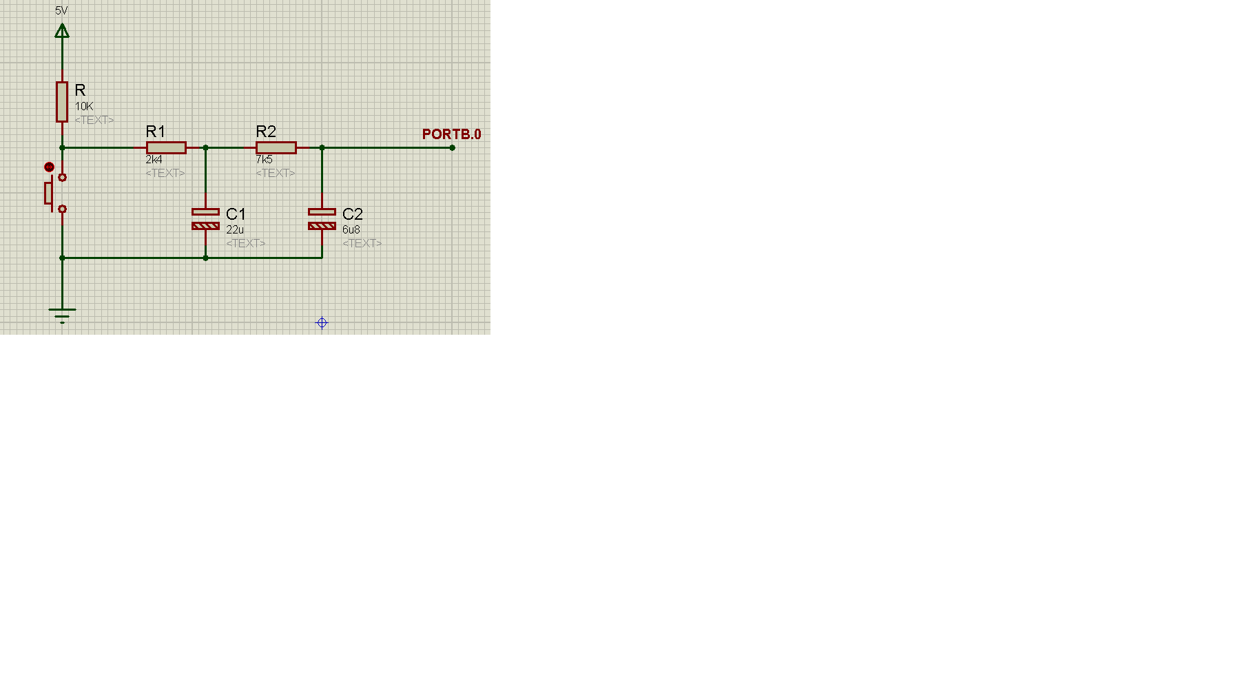

Add current limiting resistors, and de-bouncing capacitor to the new pull-up pusu button then trying again maybe?

When you disconnect load manually, from its socket, no spike/interference are there, and code functions as it should be.
only when you turn off the load by turning off its circuit breaker, it produces a spike, and system sees it as pressing the push button.
These results are better than before:
before even if you disconnected load manually out from its socket, system sees it as push button pressing.
Can I consider this level of project as bug-free and move on to next task?
Thank you
I think the software is OK. If the circuit breaker 'tricks' the system into thinking the switch was pressed it still points to an electrical issue. I would leave the switch on the ground side of the circuit, it is generally safer to do that because the switch wires do not carry supply voltage. You could filter the switch signal again with the RC network to be doubly sure it isn't picking up interference on the wiring.
The only other way the interference could be getting in is through the power supply itself. You already have the correct decoupling components fitted but it is possible the whole supply, including ground, is carrying a spike. It's difficult to tell which path it travels through but you might be able to try fitting an interference filter in either the power feed to your unit or the power feed to the circit breaker to see if that helps.
Brian.

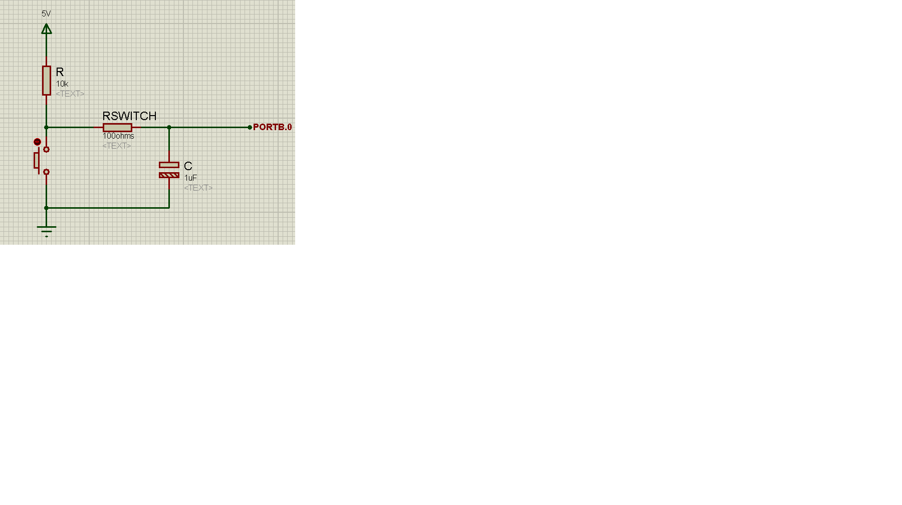

So you were saying that the optimum switch circuit would look like:
And for the capacitor, once determined its parameters (capacitance, rated voltage of operation, ....) I can connect one terminal of it to the load socket, and the other terminal is judged by PIC's switching interface, which is most likely to be an open-relay switch that connect the second terminal to the other side of the load at PIC's order connection/disconnection.
For security, only a short of 100k between cap terminals would disable all kinds of risks
Thank you
Added:
What is the rated power of the 'bleeding resistor', and are there any solid-state switching method (IC) to connect the cap during the whole AC cycle as open-relay switch does?
Switch circuit:
Interchange 100R and 10k.
Switch current = 100R current = 5V / 100R = 50mA. Power = 5V × 50mA= 250mW.
10k power is low.
Time constant = R × C = 10k × 1u = 10ms
Klaus
Klaus
No, don't interchange the resistors but the 10K should be on the other side of the 100 Ohm resistor. If you short out a capacitor, even a small one like 1uF you get a spark, the 100 Ohm resistor is small enough that it has negligible effect on the output voltage when the switch is closed but large enough to prevent the switch contacts being damaged.
As the switch closes, it is quite normal for the impact of the contacts to make them bounce back, it all to do with the elasticity of the materials. As the contacts bounce the logic level would rise and fall rapidly. The signal is connected to an interrupt input which means it will react to the first transition of the signal from high to low and then ignore any further input until the ISR is finished and the interrupts are enabled again so to some degree, the software 'de-bounces' the signal anyway. The capacitor is there to help filter out rapid signal transitions and to help prevent other signals being picked up on the interrupt pin wiring.
A larger capacitor will make a better filter but it will also introduce an other problem: consider what happens when you turn the PIC supply off. If the switch is open, the capacitor charges up to supply voltage, when the power is turned off, the PIC and any other component on VDD will discharge the supply voltage fairly quickly but the charge on the debounce capacitor can only trickle away slowly through the 10K resistor. This can make PORTB.0 have a higher than VDD voltage on it which although unlikely, can damage it. If you use a larger capacitor, connect a Shottky diode from PORTB.0 to VDD with its cathode end toward VDD. In normal use it will be reverse biased and have no effect but if VDD goes down, it will make a path to safely discharge the capacitor.
The 'bleed' resistors across the capacitors have to withstand the maximum voltage across the capacitor and their power rating should be at least (V*V)/R Watts. That takes into account the worst case of the capacitor being fully charged when it disconnects, in real life the probabiility is the voltage would be lower so there is an even bigger safety margin. Example: if the capacitor disconnected at 220 V RMS peak it would have Sqrt(2)*220 = 315V across it so a 100K resistor would dissipate (315*315)/100,000 = 0.99W. You could use a higher value to reduce the power loss but the capacitor would hold it's charge for a longer, its a compromise between safety and efficiency.
Brian.

Hello, and thank you all for your replies:
I tried the 'optimum' switch, using 10K pull-up resistor & 100R in series with the PORTB.0 and a 1uF electrolytic capacitor between the 100R and GND:
https://obrazki.elektroda.pl/8254750900_1460670834.png
When disconnecting the load, from its socket, it triggers a false interrupt.
I tried the old simple 10K pull-up alone, and disconnected the load, also a false interrupt had been triggered.
Yesterday, with same code, circuitry, and load as today, I tried the 10K alone with the push-button, and removed the load form its socket, no false interrupt was triggered.
The false interrupt triggering is not continuous or stable, sometimes it occurs, other it don't whether with the 100R and 0.1uF or without them.
The only difference between today and yesterday is the supply voltage:
Yesterday it was over 210VAC today its below 196VAC.
