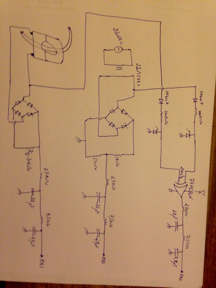

I see problems with the circuit:
* the XOR needs input voltage of 0.7V ... 2.0V, this is not really "zero"
* the zero cross /XOR circuits can't work properly with the rectified signals.
(For the XOR circuit one needs input signals with mains frequency and constant 50% duty cycle. With rectifying you get 2 x mains frequency. And with varying current you additionally get varying duty cycle. Below a minimum current there will be 0% dury cycle.)
But:
Both circuits give good signals for voltage magnitude and current magnitude measurement.
I don't recommend to change the filter RC values.
Klaus
When 200W resistive bulb is connected, theoretically, the inputs of the XOR should be both high (1) and hence the output (corresponding to phase angle) must be equal to zero. But using this circuit (attached previously) what I`m seeing is around 4.5VDC at the XOR output that corresponds to high which should be low.
No, that isn't right. Both INPUTS should be going high and low at AC frequency but it will not be a sine wave so most DVMs will show a wrong voltage measurment. The output should only be high when the inputs are DIFFERENT. (EXclusively one OR the other is high) XOR logic is like this A B OUT 0 0 0 0 1 1 1 0 1 1 1 0 So with the voltage waveform at 'A' and the current waveform at 'B', if they are in phase (both 1 or both 0) the output should be zero. Any phase difference in the waveforms will make A go high before B (or the other way around) and the output will be '1' during the time difference. The output high time is therefore proportional to the time difference (= phase shift) between them. The RC network is to average the length of the high and low output into a measurable voltage so the ADC has a chance to read it.
* the zero cross /XOR circuits can't work properly with the rectified signals. (For the XOR circuit one needs input signals with mains frequency and constant 50% duty cycle. With rectifying you get 2 x mains frequency. And with varying current you additionally get varying duty cycle. Below a minimum current there will be 0% dury cycle.)
That's why I suggested using a single diode from each transformer, it will ensure the voltage drops to zero for half of each cycle so the XOR inputs are nearer 50:50 high and low. The fix for minimum current is simple, just add a high value resistor (~2M) between the XOR inputs. It will ensure there is always voltage waveform at the inputs but will easily be overdriven by any real signal from the CT. It will give a zero phase reading if the current is too low but that is inevitable anyway, there will always be a current that is too low to measure. Brian.
That's why I suggested using a single diode from each transformer, it ...
If you want to do this, then the other side of the ct needs to be grounded. But it isn't, it is floating somehow.
Klaus
No, that isn't right. Both INPUTS should be going high and low at AC frequency but it will not be a sine wave so most DVMs will show a wrong voltage measurment. The output should only be high when the inputs are DIFFERENT. (EXclusively one OR the other is high) XOR logic is like this A B OUT 0 0 0 0 1 1 1 0 1 1 1 0 So with the voltage waveform at 'A' and the current waveform at 'B', if they are in phase (both 1 or both 0) the output should be zero. Any phase difference in the waveforms will make A go high before B (or the other way around) and the output will be '1' during the time difference. The output high time is therefore proportional to the time difference (= phase shift) between them. The RC network is to average the length of the high and low output into a measurable voltage so the ADC has a chance to read it. That's why I suggested using a single diode from each transformer, it will ensure the voltage drops to zero for half of each cycle so the XOR inputs are nearer 50:50 high and low. The fix for minimum current is simple, just add a high value resistor (~2M) between the XOR inputs. It will ensure there is always voltage waveform at the inputs but will easily be overdriven by any real signal from the CT. It will give a zero phase reading if the current is too low but that is inevitable anyway, there will always be a current that is too low to measure. Brian.

Are you saying that using the circuit I've attached and branching a 2M one side to first input of XOR and second side to second input of XOR is the solution?

this is the 2M between XOR inputs.
Do you have any concerns within the circuit? I`m too worried that this is supposed to be done 2 months ago, still didn't improve any power factor :(
Thats right. Something occurred to me though, it may not be a problem but it is worth a minor change to be absolutely sure: add a resistor of about 100K from the cathodes of the new diodes to ground. The reason is: when the diodes are forward conducing they lift the voltage at the input pins of the XOR gate high but when the polarity reverses, there is nowhere for any voltage stored in the circuits capacitance to discharge to. The resistors will provide a path to ensure the input pins go back to zero quickly.
Incidentaly, if you use Shottky diodes the circuit will be able to work down to lower currents. Something like a BAT85 diode will drop ~0.3V instead of the 0.6V of a normal silicon diode.
The idea behind the 2M resistor is that if there isn't enough signal from the CT, the XOR will never see it as a logic '1'. The voltage input will still be following the AC waveform though so the XOR truth table says A = always 0, B = alternating 0 and 1 so it falsely gives the impression of measuring 90 degrees. The resistor is to provide a 'weak' link so in the absence of any real current signal, it follows the voltage and gives 0 degrees as the reading. Any 'real' current signal will be able to overcome the weak link.
Brian.

I tried the 2M between first and second channel of XOR, I think result returned better:
for the resistive lamp, it showed a phase of 0.000
for the cap bank, it showed a phase of 0.88
for the inductive fan, it showed a phase of 2.22
These values are divided by 14.869 then by 1.6 as the following code shows:
Adcin 2, phase
Brian.
I've added the two 100K from both new diodes to GND, but the results turned unsatisfactory:
The phase for the resistive load turned 40, when removed these two newly branched resistors, it turned back to zero.
Also, without the resistors, when connected a 100W resistive bulb instead of the 200W I see a similar phase of the inductive load, and I don't know why this happens, perhaps at lower current, CT circuitry tends to behave in a different way.

It must be grounded, in any case.
But according schematic of post#326 it is not.
The negative output of the rectifier is grounded.
Klaus
I do not understand; the output of the current transformer does not have a DC path to return anywhere- I expect it to come to ground.
I just simulated the ct circuit.
I have to admit it works better than I thought.
If - only IF - the ct works about perfect, then with a secondary current of 0.15mA RMS should give good results. Not perfect, but good.
But below the 0.15mA, lets say 0.1mA, it is not able to give good results.
According the simulation the "digital" voltage signal at the XOR input is about 46% duty cycle. Not perfect.
Error calculation: imagine a perfect 50% duty cycle XOR-ed with a 46% duty cycle. Expect no output change from -2% to +2% phase shift.
This means +/- 7.2° around pure resistive load there is no change in output signal.
Please give the exact type and manufacturer of your used ct.
Considerations:
* It is expectable that the ct does not work perfectly with the 10k burden.
* consider a 1k or lower burden.
* consider a comparator with 200mV threshold to detect the zero cross for the current.
Klaus

Some ideas to improve your ct measurement:
* choose an appropriate ct
* route the "load wire" ten times trought the ct hole.
* use an amplifier at secondary side
Klaus
