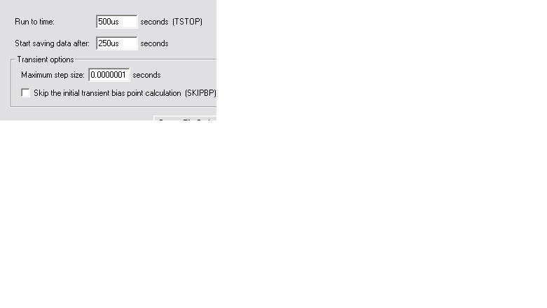

What is the value of maximum step size in your simulations ? ;-)

Here is my both attachments i.e. resistor at node of emitter to ground and simulation profile. How to change steps?
Shayaan , are you designing an audio amplifier ? if yes i don't think that there is any human available that can hear 5000KHZ ( 5MHZ ) ! change it to 20KHZ if you don't want make a transmitter ! .
And change your alignments to these :
