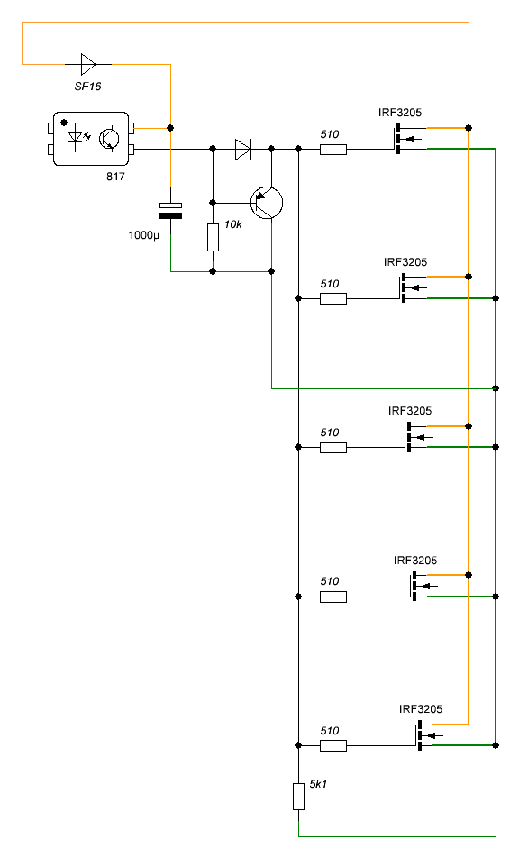

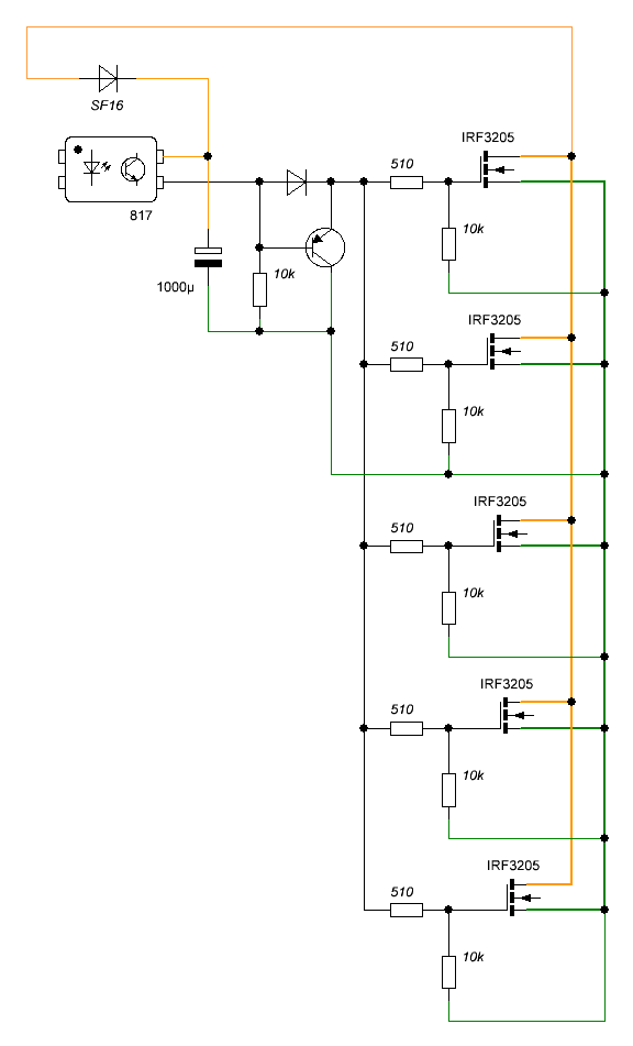

Ok I want to use this scheme for modified sine wave (square wave) for 50Hz, My question how you are driving the upper mosfets, in case if the frequency is 50 Not able to charge pump the capacitor.
will this driving stage able to drive 4-5 mosfets in parallal.
Try to enlarge capacitor for charge pump, may be it will be work.
May be - if PC817<->gate resistors be increased to 510 Ohms and G_S to 5k. Depends on mosfet parameters, but probably it will work for 50Hz.
Thanks!
I suppose the SF18 is ultra fast diode.
and I suspect there must be duty cycle limit for the charge pump to properly function.
May be schottky diode is better in this case - like SS16, SR160
To charge 1000uF capacitor it is necessary time beside 150 us (t~3*(R*C)) - 1/60 of half-wave duration. Possible 220 - 470uF capacity will be enough. And this capacitor is not completely lose charge in each cycle, so necessary recharge time is shorten.

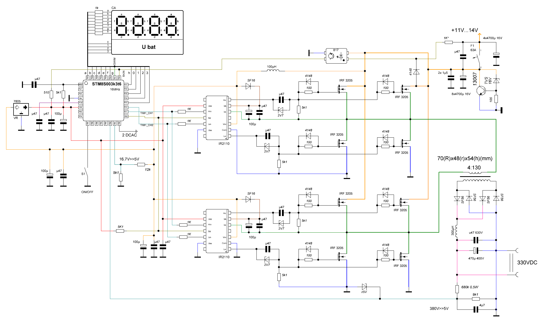

I am sorry, but this is an most usual transformer with ferrite core without air gap. That circuit has output DС voltage stabilizer.
whats new in this new design. and what is the purpose of the discrete voltage regulator comprising 13009.
This circuit will suppress voltage spikes above 16.5V on power rail. There is also an interesting circuit which behaves as broken fuse detector and protects FETs and stop inverter to operate at lower voltage while capacitors discharge, I guess.
nothing especial simply one more converter )
yes, this circuit for voltage spikes supression.
This attempt to use resistance of breaker as shunt resistor. Possible thought not very ingenious since this resistance not stable - it is necessary to try.
