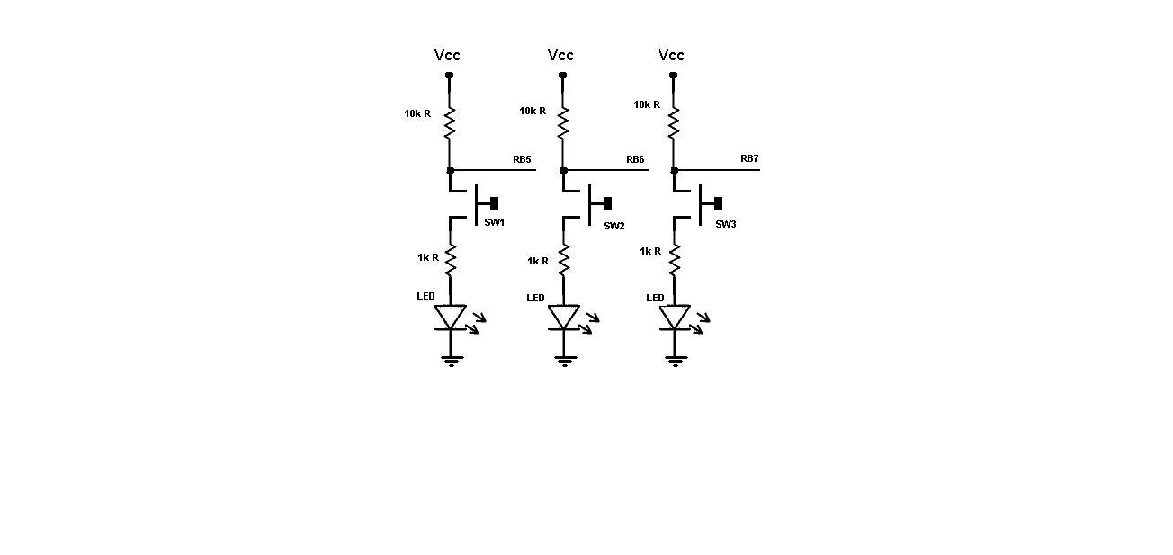

hi......the circuit shown below is to give input to portB.if we press sw1 the label is printed and so on....i wanted to no if the circuit is correct and i wanted to no y 10k resistor is connected to switches and 1k resistor is connected to LED...pls help us soon

can anyone tel me how will be the output of this program..............pls help us soon
yes i wrote the code....... its working perfectly in simulator one character after the other........
but i want it to be like label
name
class
college
will it print like this or label
n
a
m
e
dont no how to c the output
