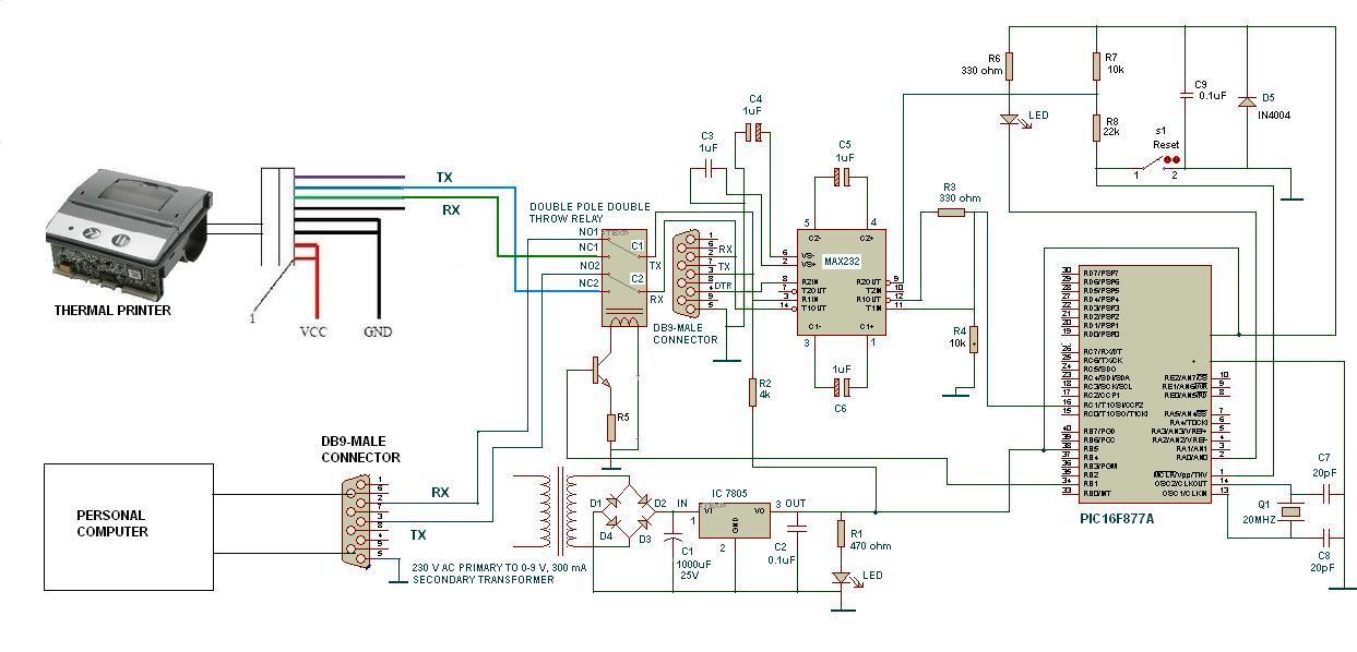

please check the previous link the schematic is opening please check and tel us if its correct pls pls

pls check the schematic and tel us if its correct so that i can go for soldering and programming ..........pls help us soon its very urgent
why are you connecting pin 4 (DTR).. pin3 of db9 should be connected to pin13 of max but it is not at all connected.... check max 232 circuit properly...
The RS232 interface at the PIC side is mysterious. I would expect dedicated RX and TX pins (hardware UART) connected to the MAX232.
You also managed to confuse simple things as a transistor relay driver. Unless you have unsaid special intentions, you should go for the text books standard common emitter configuration with current limiting base resistor and a free-wheeling diode for the inductive load.
pls check with this schematic i have corrected a bit.
Looks better now. Did you check, that the thermal printer can be operated with 1 or maximum 1.5 A from 7805 voltage regulator. Some devices have a rather high peak current.
hi....i m sending u the details of the thermal printer i m using.This printer can be operated with 2amps can u pls tel me if i hav to do any corrections in my schematic for 2amps.....or this schematic is fine to continue with my project....this printer has a charger connected to it.......pls reply soon.......
If the printer is intended be powered by the 5V supply shown in your schematic, a voltage regulator with higher current rating should be used. Also the 1000 uF capacitor should be enlarged to e.g. 4700 uF and a transformer with sufficient current delivery connected.
The printer current consumption depends a lot on the firmware - there are many tricks which can reduce the current from 2A to 200mA (on the price on slower printing speed).

the thermal printer i m using is a ready made printer with a charger so i dont hav to bother about the power supply for it...i just hav to connect it to relay for data....can u pls tel me if i hav to connect pin no 1 and 2 to ground and pin no 3 and 4 to vcc of power supply of my circuit....or i just have to connect RX and TX of printer to NC1 and NC2 of relay....pls help me soon i m really confused.....
If so, it can't be identified in your schematic
We can't know. Check the documentation shipped with the printer. Or ask the supplier.
