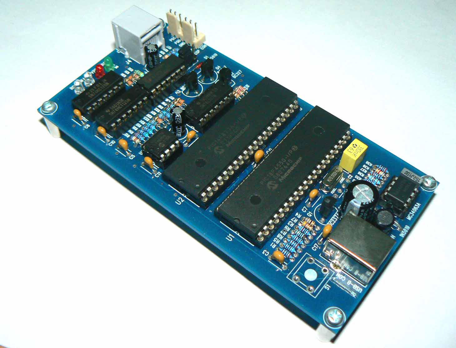

i have built icd2-usb potyo version . i can use it as programmer but in debugger mode it can't not . mplab shown message
Programming Target...
...Validating configuration fields
...Erasing Part
...Programming Programming Executive
...Verifying Programming Executive
...Programming Program Memory (0x0 - 0x1FF)
Verifying...
...Program Memory
...Verify Succeeded
...Loading DebugExecutive
...Programming DebugExecutive
...Debug Executive
...Programming Debug Vector
...Debug Vector
...Programming Configuration Bits
.. Config Memory
Verifying configuration memory...
Connecting to debug executive
ICD0083: Debug: Unable to enter debug mode. Please double click this message for more information.
MPLAB ICD 2 Ready
How I fix this problem !!! please help me
Added after 6 minutes:
one thing that i miss is all resister value 4.7k in potyo schematic i replace with 5k because the shop don't have this value..
resister 5k that i used cause a problem in debug mode?

Thank for all . Now I can debugging target board. The problem is my fault in schematic. :D
I just wanted to say thanks to all of you guys who helped make the ICD2clone. It works !!
I've build "potyo2 (09/18/2006)" from http://icd2clone.com/wiki/Main_Page.
At first using MPLAB 8.10 I had problems connecting to the ICD2.
ICD0021: Unable to connect with MPLAB ICD 2
MPLAB ICD 2 Ready.
I had to go down to MPLAB 7.40 before my ICD2 was recognized and a firmware downloaded.
Now it works with all versions of mplab (7.40 and up).

Hello, i wrote some posts about it. If you follow exactly it must work, at least works for me each time i tried (yes, i reprogrammed the icd2 clone from scracth several times to test if steps were correct)
Build and programming steps:
About "debug" mode errors:
And i found today this post about firmawares:
Ciao

The kit, schematic & firmware on my site all function great. Since you built your own version using your own PCB layout I can't possibly know what you did wrong.
For the meager $9 I charge for the original Inchworm PCB why would anyone lay out and drill their own?
