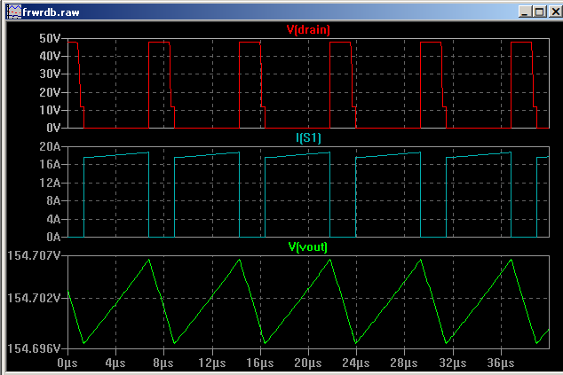

Here it is scaled for 80% duty cycle,
In regulation,
Previously,
I suppose it largely comes down to what sort of leakage inductance there will be in the transformer.

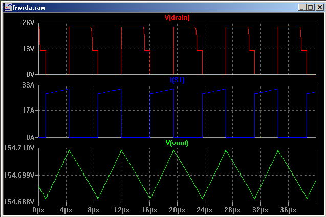

For comparison these are the single switch and two switch forwards,
The waveforms as shown are not really meaningful but they look pretty. You'll have to run the analysis and poke about to see what are 'spikes' and what the rest is. I've lost 'faith' in trying to adjust the clamp winding in the single switch one, the clamp diode suffers huge currents. These are both running at 50% duty cycle.
Using an RCD clamp on its own is likely to be a non-starter unless you really really want to throw away some power.
Leakage inductance cripples things basically raising the drive impedance on the secondary so, unless filter inductors are made large or the transformer is wound to produce excess voltage on the output, and stress the diodes, then you can't 'force' the power through.
As a 'fix' I've lowered the winding inductances which would happen with a gapped core but I'm fairly certain that leakage is, to a certain extent, independent of this and in fact may be made worse so my reducing those values in proportion is probably incorrect.
I have included a 'residual' RCD clamp on the single switch version on the assumption that even the primary and clamp windings will not experiece 'perfect' coupling. It wastes 2W.
Overall there is not much to choose in terms of performance. Might as well accept that there will need to be some input filter to make life easier on the battery. The single switch is simpler. I know you do not like 'complex' transformers but as I say the clamp winding comes for 'free' you're winding the primary anyway and it's just a matter of soldering its ends to some pins.
Models attached... off to do some more thinking.

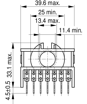

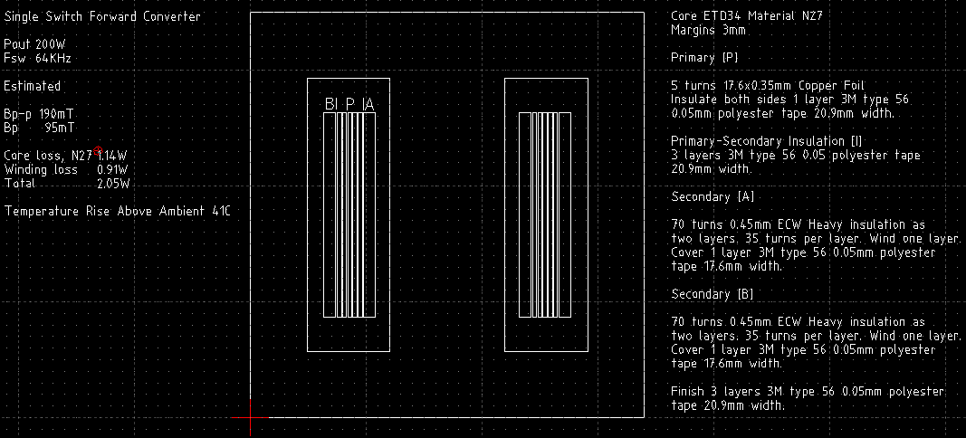

QCAD drawing,
I would be uncertain about regulatory requirements for such devices so I have just assumed 3mm margins for 6mm clearance/creepage.
You will have to decide how to terminate the windings. In the case of the foil primary, which carries high currents, I would note that the bobbin,
Has a notch on the upper circumference and would recommend you use it for flying lead-outs from that particular winding.
It is what it is and as I say it is not necessarily correct but I am not prepared to fiddle about with things to make it, apparently, simpler or 'cheaper'.

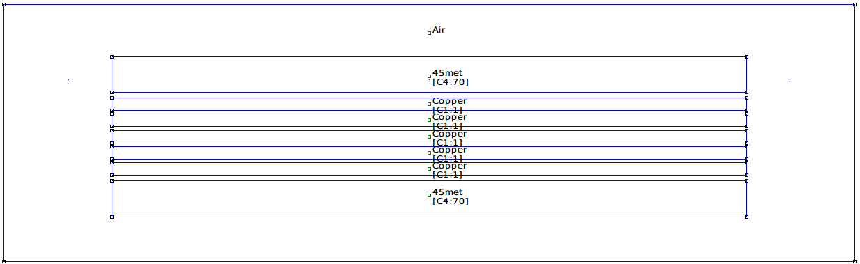

The basic, approximate, core/winding model was produced in QCAD to get a DXF file which FEMM will import. Then I added the various block labels within FEMM. The concepts behind the program are so far above my head as to be almost inconceivable.
Page 41) of the manual under 2.3.11 Block Integrals describes how to determine self and mutual inductances based on what is effectively, to my mind, stored energy. There does not appear to be a 'reasonable' way of extracting 'leakage inductance' or rather one that I would understand. As a result I 'cobbled' one together...
Overall model was,
One winding section..
There are four 'circuits' involved. This one shows C1/C4. The other side uses C2/C3 which are the same magnitude currents but reversed. Those currents are set to 'cancel' according to turns ratios. Ideally you would expect the result would be that no overall energy is stored. The assumption is that any that is measured would be attributable to leakage inductance and therefore indicative of its value..

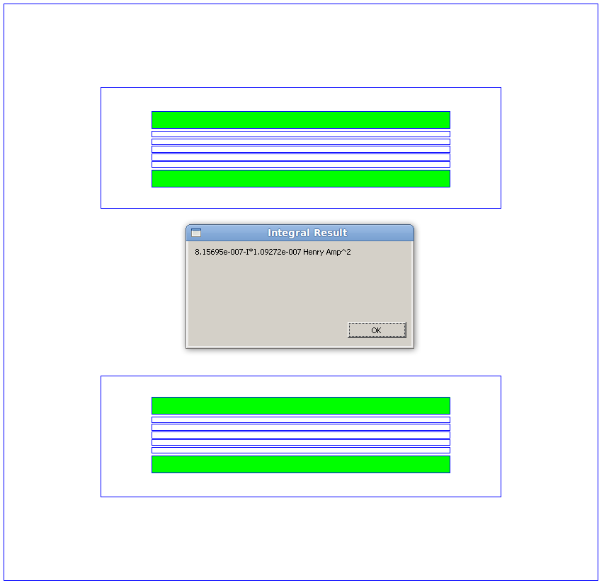

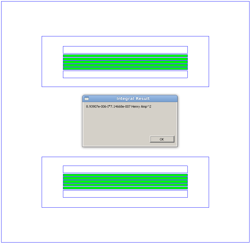

Doing the block integrals my assumption is that the indicated inductance, based on such energy, is indicative of the leakage inductance associated with that winding..
For the secondary,
Working out the magnitude as SQRT[Re^2 + Im^2] and dividing by 1A^2 gives 823nH.
It is a value I might be wary of and as a result question my methodology. FEMM does give reasonable answers when checking other things and I would not doubt those results using the described methods. In this case since it is me 'guessing' then the results may not be guaranteed.

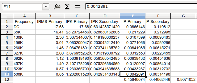

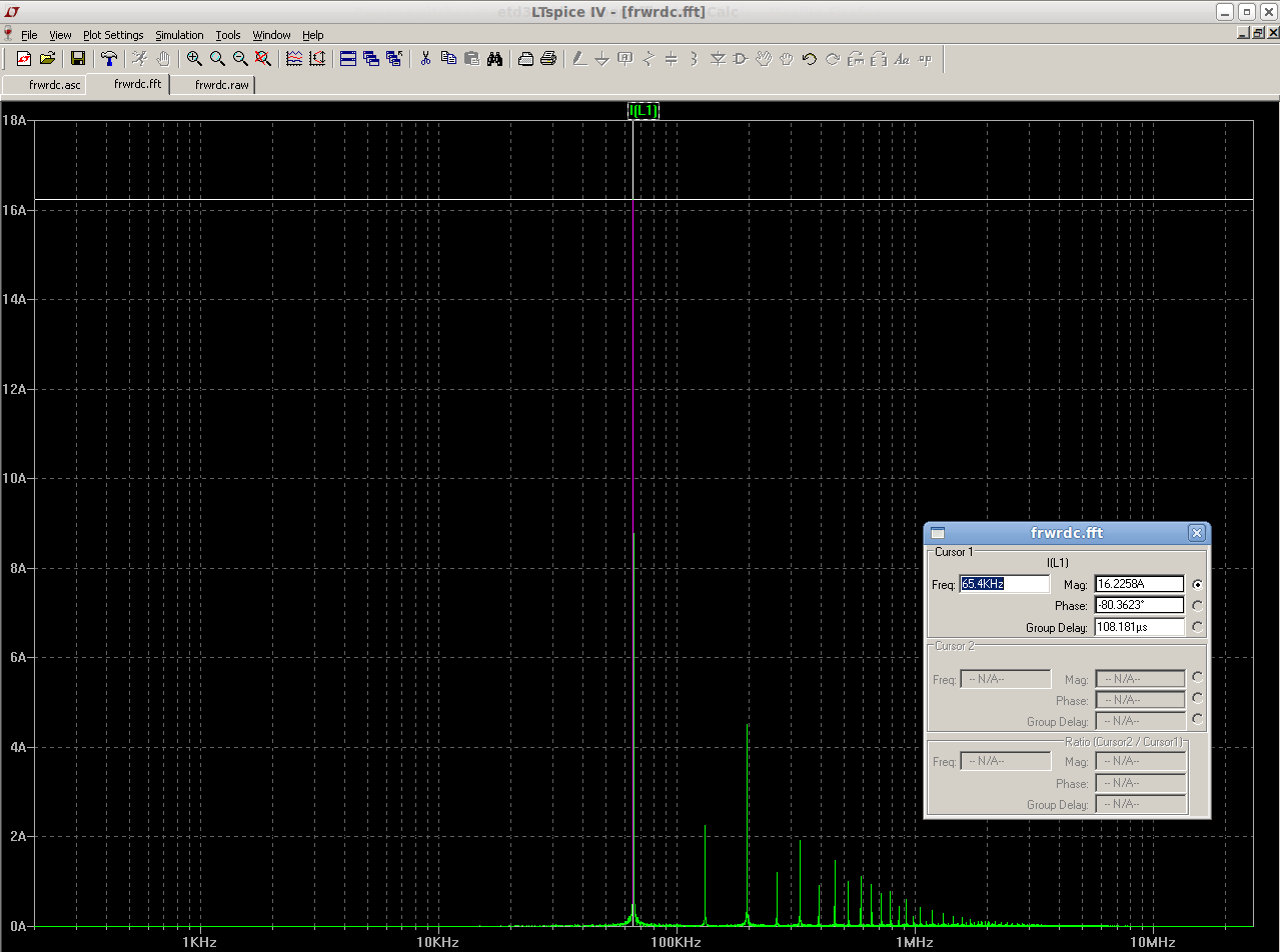

FEMM also takes care of skin and proximity effect although once again I might be using it incorrectly. Putting the values so far back into LTSpice and running a transient analysis lets you do an FFT to determine relative contributions.
Slight danger is how you might, or I would expect to, translate from LTSpice results to FEMM. There must be a DC component for which I have used the 'average' value,
Then for the AC components LTSpice plots RMS whilst FEMM uses peak so they need to be converted,
and put back into FEMM for each frequency of interest then summed to get the overall result. I have just used values for the primary current and assumed the secondary will be proportionate according to the turns ratio.

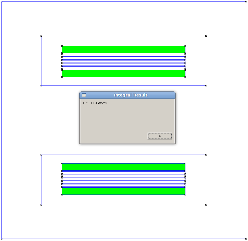

The block integral is for 'Total Losses'.
Regarding core loss I have just calculated a Bpeak excursion and used the manufacturers data sheet graphs to get an approximate value for that based on Bpeak and the switching frequency. I don't doubt FEMM could give something more accurate but then it depends on the driver and the methodology.

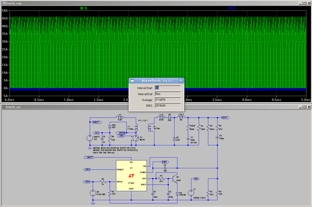

I have a 2-switch forward converter similar to your "frwrdd" that you provided for me. If the current sensing that you implemented in simulation using "B1= V= I(S1)/40" is replaced with a current sensing resistor, such as a 1mOhm resistor, I experience large turn-on spikes of current up to about 360A. It then levels off to around 30A within about 7ms. However, I can't seem to lower it before then. I even went back to your original circuit to experiment, and I can't get it to go down there either.
Am I doing something wrong or is this a major flaw to the design? I'm assuming that large of a spike would destroy the fets, and I'm not buying a 360A rated fet.
I figure there is a solution but I'm not experienced enough to find it, well I haven't yet anyway.
Please someone help me out. Thanks!
