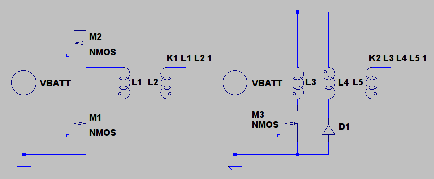

Upon further research, it seems like the most common method is to use a push-pull topology to convert the 12VDC to 12VAC at high frequency, use a hf transformer to step-up to ~110VAC, then rectify to ~180VDC. Then this is inverted using H-bridge to 110VAC at 60Hz. Also, a LPF is used either after the rectification or the H-bridge to get a sine. So the high frequency operation is in the front-end to step up the input voltage. Later, in the H-bridge the desired output frequency (50/60Hz) is used. Otherwise, a large transformer is needed if not using a high frequency front-end.

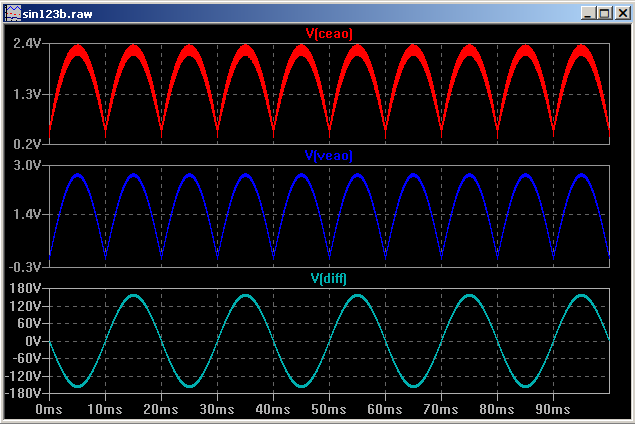

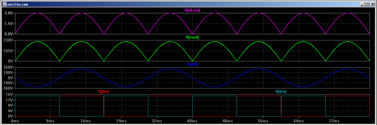

Hopefully the following waveforms make sense. Do you have LTSPice?

This is the output of the above circuit?

It probably is 'sophisticated' but it is the best way I can think of coming up with a 'pure sine wave'. Perhaps it looks complicated but as suggested much of the control is buried in the UC3827.
Not all of the signals come from it. Just the drive and control for the primary side switches. You will still need to generate the sine/half sine and the 50/60Hz drive for the secondary side bridge.
That's how I model 'ideal' transformers' in spice. Coupled inductors with values set as inductances according to squares of turns ratios.
Here is the model.. I've just realised I have done silly things elsewhere.

Downloads.. Quick/Slow check.. As delivered it does what it says on the 'tin'.
You've been having a 'play', haven't you.
Genome.
Genome, thanks! I had a hang up but I'm back at it. Just downloaded your circuit and I'm going to take a look at it.
Yes, everythink O.K. Unfortunately I have been simulating the text from the code window before you managed to provided a zip file. It has a few "µ" symbols replaced by "?".
Genome, your circuit is pretty awesome. I really only need a modified sine, and I understand the H-bridge. Where I am having trouble is the input stage. I need to decide how I am going to convert 12Vdc to ~155Vdc for the H-bridge. My original plan was to use a half-bridge converter. My problem is I have to design all of this by myself, including the transformer. I wanted to keep it as simple as possible, like only 4-pins on the transformer, such as a 2-switch forward converter.

Rather than using a two-switch forward, if you wish to go down that route, you may be better off doing a single switch forward converter..
Using either you run into possible problems in that duty cycle is limited to 50% so say you wanted 120W output your would be drawing 10A average from a 12V battery but it would be as a 20A square wave. The push-pull circuit would relax that. In this case power losses are increased but I suppose you just scale accordingly.
With the two switch topology you have ... two switches in series and therefore you will double the losses when compared to the single switch version. In the single switch version you still have to allow for transformer reset which will place 2VIN on the drain of the switch so its voltage rating needs to be higher. Since you are operating with low input voltages that need not be such an issue...
Of course since you are no longer using the upper switch you don't have the added complexity of generating a level shifted supply for it.
What you will need is a clamp winding, L4 in the above diagram, to allow for transformer reset back to the input supply. This needs to be tightly coupled to L3, the main primary and whilst it seems like the complication of an added winding it carries little to no power and you can almost get it for 'free'.
Assuming you are not forced to use foil for the primary and stick with Enamelled Copper Wire then it is likely that you will be winding the primary as a twisted rope. That is a number of strands of wire in a twisted bundle. You would pick off one of those wires and use it for your clamp winding. So for example, 7 in the bundle, 6 for the primary and one for the clamp.
You may still require a dissipative clamp or you might rely on using an avalanche rated Mosfet.

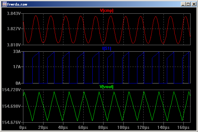

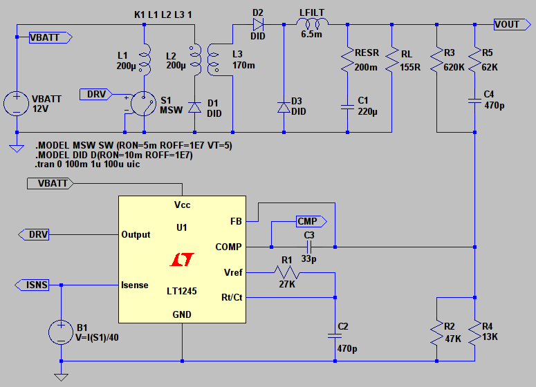

The basic circuit model would be,

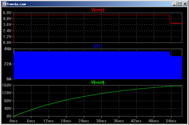

Start up,
Regulation
I've sort of picked some values out of my hat on that one but the model is attached if you wish to play. Current sensing might be an issue that would be simplified with a current transformer. Otherwise to avoid the 1V limit imposed by the controller if you were to use resistive sensing you would pre-bias the ISNS pin from the reference. You may still end up with excessive losses or noise problems though.
Genome.
