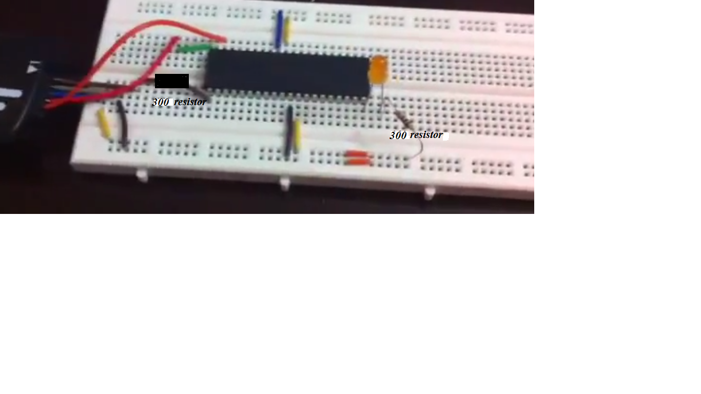

I bought PICkit2 as you told me.but I can not make the LED flashing
I want to achieve the project as shown in the following video
Blinking light using pic - YouTube
my project,work without using the component,
I mean without
- crystal oscillator, 4 MHz
-100 NF capacitor
-470 NF capacitor
I mean just with (PICkit2, led, PIC18F4550, pc, breadboard) I can have led flashing
if you can tell me or send me the code I use mikroC for hex file
here is my code

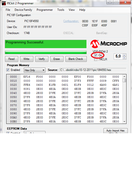

The code seems to be ok (not sure though, i don't use MikroC, there may be something wrong with port definitions). When done programming did you click 'bring MCLR to VDD'? (or Release from reset).
And while flashing led may work without these components, anything needing more frequency accuracy (like USB) won't.
thank you ,but where I click bring MCLR to VDD,i dont use any components
just (PICkit2, led, PIC18F4550, pc, breadboard).
As in the picture
no more no less
I use mikroC and PCkit2 program to load the hex file
thank you
thank you very much really and I swear I appreciate your help.
for the option you told me it "/ mrcl" I have already done, but still it does not work I do not know what's the problem

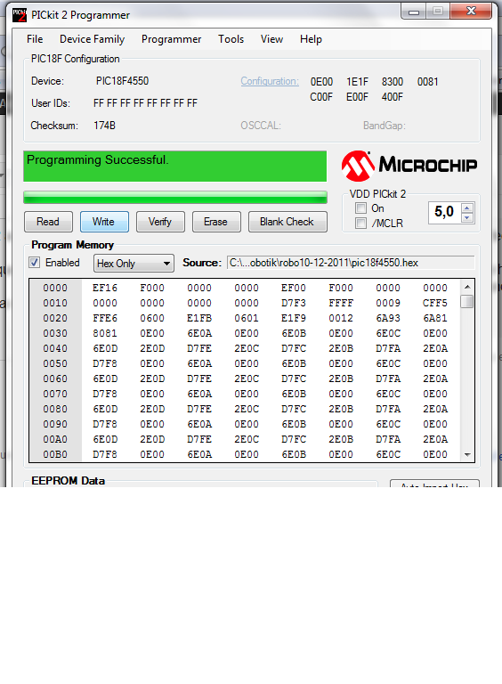

firstly I connect PICkit2 to my pc
Secondly I run PICkit2 programmer
PICkit2 program displays
PICkit2 found and connected
peak device found
Third file ----> import hex file ------> write ----> Successful programming then hold device in reset

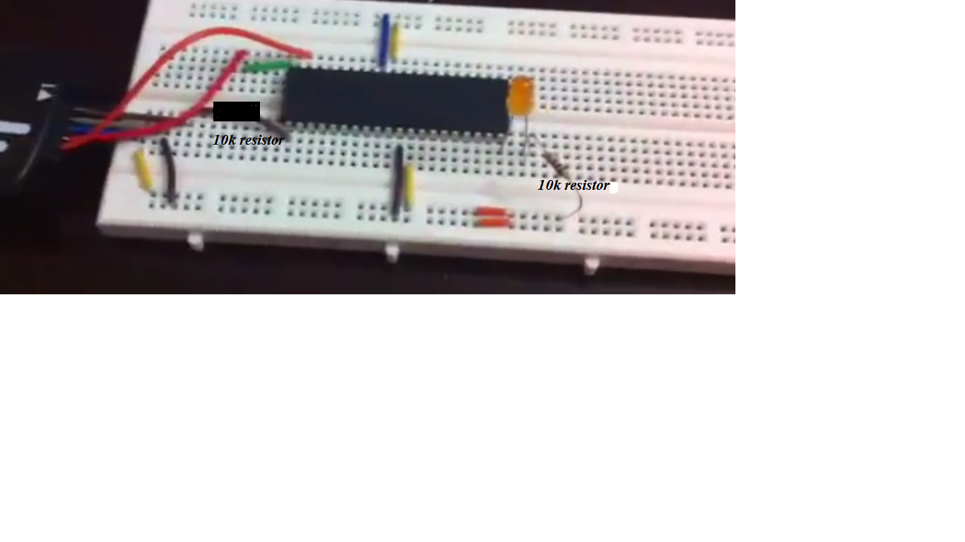

you have to connect MCLR resistor or else it will not work. connect 10k resistor, one end to vdd and other to pin 1
thank you very much
I did what you told me but still does not work
what the problem please help
replace led 10k resistor with 330ohm or not more than 1k.. then check
hello,thank you very much
i did replace led 10k resistor with 300ohm
what I need? i need a LED that has less than 2 V
or I need to configurate my picket2 or two pic
Please help me I follow all that you told me
it does not work
and I begin to give up
please help

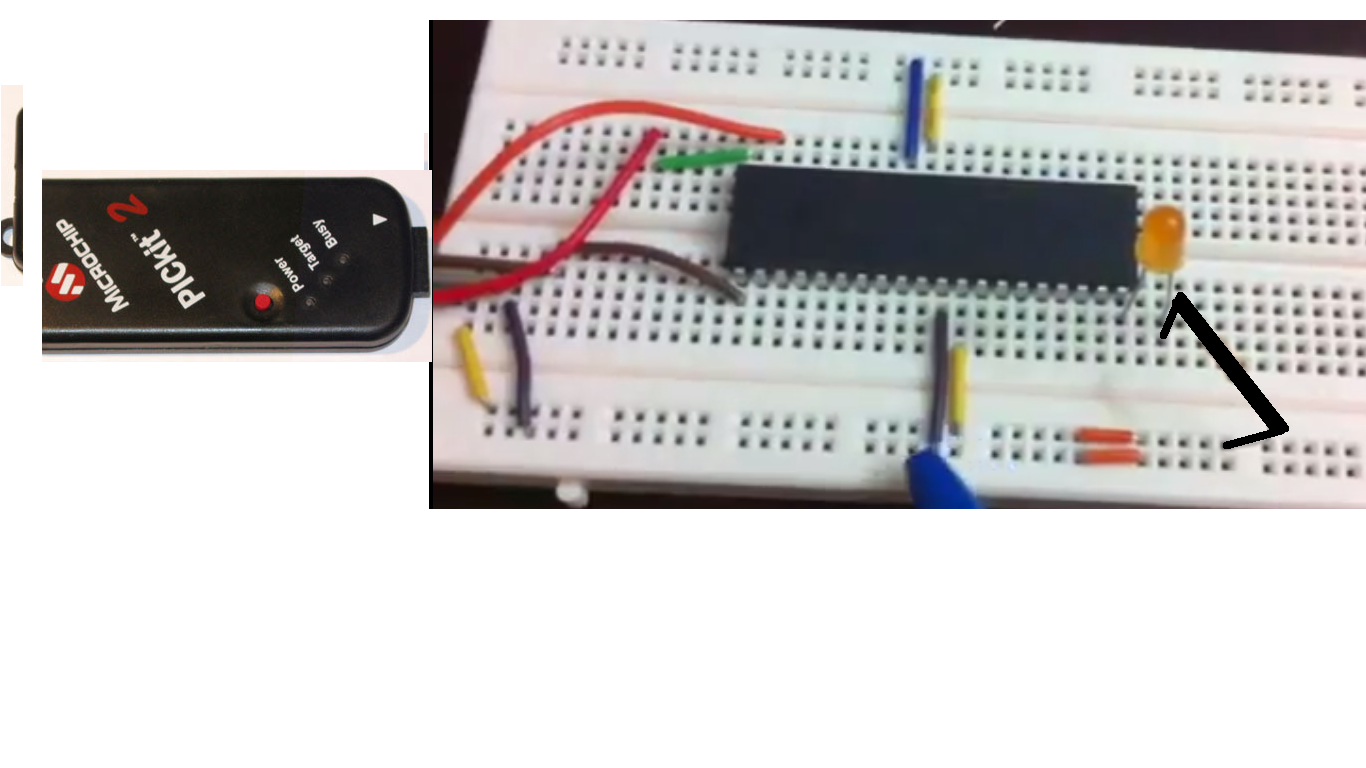

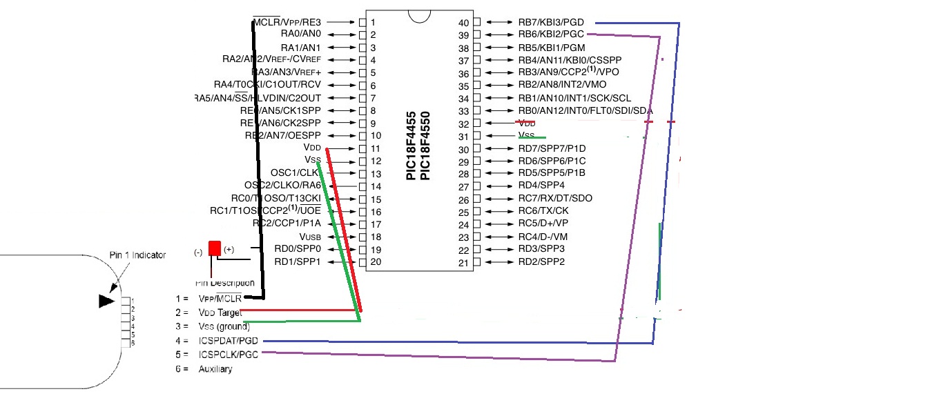

hello everyone especially "poorchava" and "devil6600", etc.
firstly I bought a new pic : PIC 18F4550
then I bought as you told me: PICkit2, and
2 resistors of 300 ohm, led and breadbord,
and I realized the following diagram as shown in Figure
and like the following video

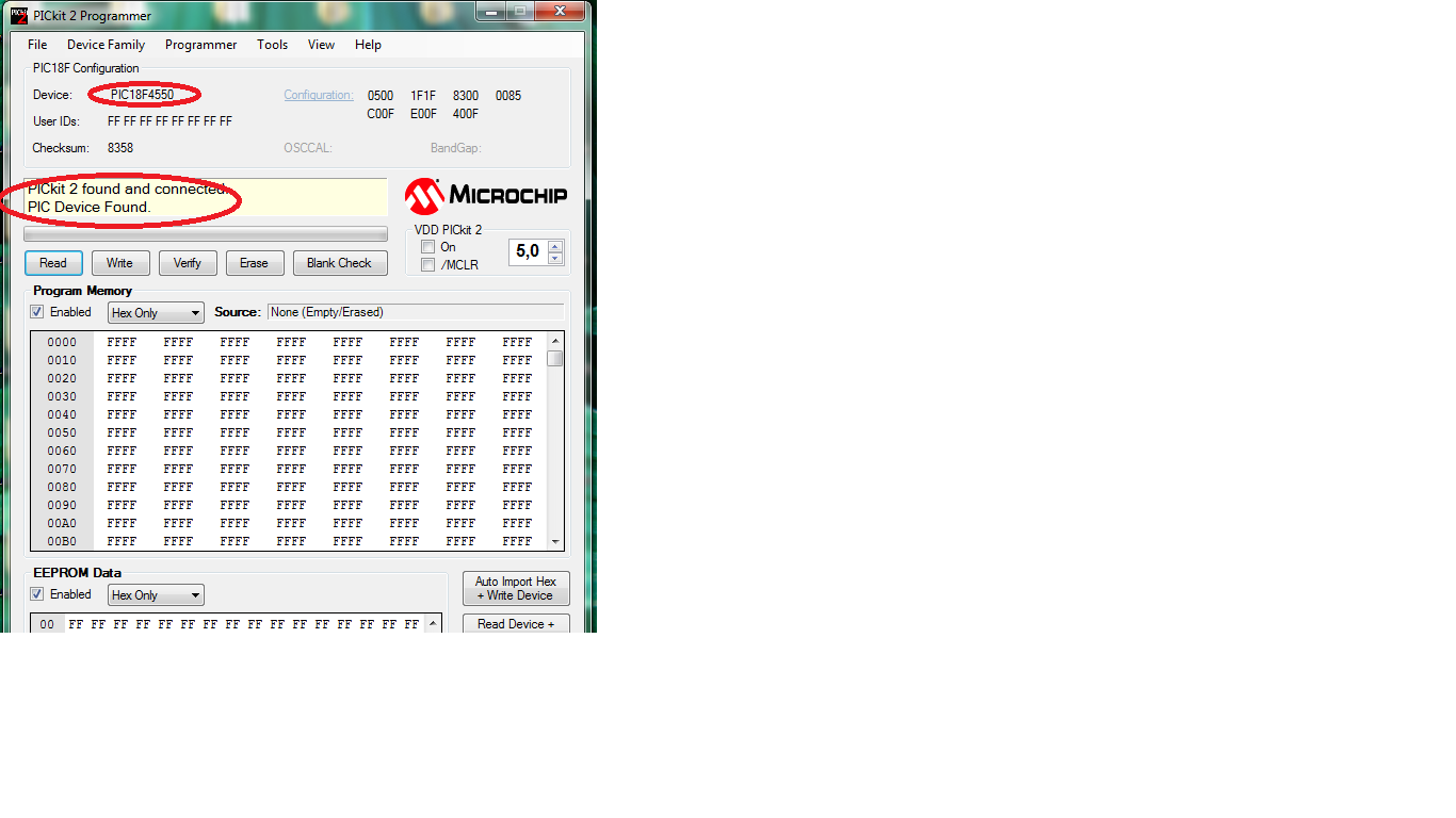

Once I realized this scheme, I have connected my pc to my PICkit2
and I run PICkit 2 v2.60
I have this resulat as shown in Figure
which means that all is right until now because it has detected my PIC 18F4550 and it is connected
then "import the hex file" that I executed in proteus and it works then "write" then "on"

Whats your crystal frequency also check with multimeter Voltage on MCLR pin it must be around 5V and also on supply and ground.
Hope this helps
---------- Post added at 08:07 ---------- Previous post was at 08:04 ----------
Where is your crystal oscillator, have you used internal oscillator, while using internal oscillator you have to also adjust the OSCCON register
May be to OSCCON = 0xF2;
I am not sure, i will post the code when i come back to my home..
Hope this helps

Your pik-kit2 is writing program to controller or not..
thank you very much realy thank you
but nothing heppens
when I execute PICkit2 v2.60 it detects my pic and it is connected, and I click on the button "write" -----> Programming Successful. that you means about (Your pik-kit2 is writing program to controller or not)
as I have already montionné in the previous message
certainly there is an error that may be my pic or PICkit2 is damaged
can you please give schema maybe I'm not well connect the components and the software that you use
thank you
I hadn't used pik-kit2 in my life, my using 20times cheaper programmer than pik-kit2 and it works fine for mine..
Try changing your Controller,
If pik-kit2 is showing the Programming Successful message than it means programming is done..
