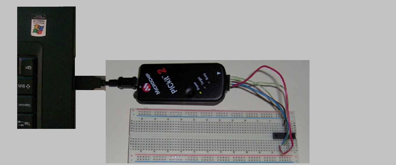

thank you poorchava,but I can connect directly my pic to pickt2 and pickt2 to my laptop in order to program my pic?? and use PICPgm as Bootloaders to download program into MCU
Yes, you can attach the PICkit 2 directly to your PIC to be programmed and to your laptop via the USB port.

thank you a lot,but
I mean as shown in the picture
and thank you
Yes, that is basically the configuration needed. Be aware that MPLAB cannot be installed in Vista or Windows 7 directly, Microchip is currently developing the new version MPLAB X and is available in Beta version now:
It may require the PICkit 3, so check the documentation if you plan on using MPLAB X.
If you want to use MPLAB in Vista or Windows 7, you'll need to implement a virtual machine with a program like VirtualPC and install Windows XP PRO.

poorchava,can you please give me an exact link to buy PICkit 2 like yours (usually cd of MPLAB is accompanied with PICkit 2) ,to ultimately realize the implementation
shown in the picture in my previous post and thank you
I can't give you an exact link. I've bought an original Microchip made Pickit 2 (i mean not a clone, though they function identically, because the code is open now). Mine looks exactly the same as the one in your photo. You can get it from Microchip Direct, but depending on your location the shipping and handling fee might be very high (even higher than price of pickit itself). I have bought mine from authorized distributor in Poland. Product Search - microchipDIRECT the part number is PG164120. Don't donfuse it with developement board of number DM164120-5.
If you plan on experimenting further with PIC, then consider Pickit 3 as it supports all of the devices produced, which Pickit 2 does not.
Anyway, I've been running ordinary MPLAB 8.xx (different versions, builds, updates etc) on my PC with Win 7 32-bit Proffessional and my netbook with Win 7 64-bit Home edition. Never encountered a single problem.

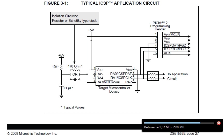

Ok, so there are few things which need to be connected to PIC in order for USB to work.
-crystal oscillator,4 MHz or multiple of it
-100 nF capacitor from each power pin to ground as close to the PIC as possible
-reset circuit as in the following schematic
-470 nF capacitor from VUSB pin to ground which is needed by internal voltage regulator
-USB D+, D- and GND connected

its because 18f4550 have an internal oscillator, if you do not connect external oscillator it uses internal. but if you are using internal oscillator then i don't think you will be able to use USB communication.
thank you , but nothing happen
have you used 10K resistor at MCLR pin, as shown in the schematic posted by poorchava in the above post?
check if you have assigned proper pin to the led
in your led toggle loop place a delay of atleast 50 miliseconds after changing pin state, so you can see led blinking. something like this:
