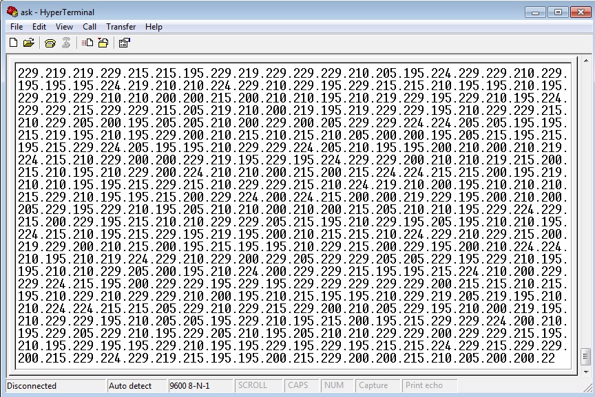

I still can't figure out the problem. When I change the input voltage, the characters in the hyperterminal changes, which means something is working. Might there be any problem with ASCII conversion? Please help....
You forgot to set the ADCON2 register.

The output is as shown in attachment below. In this case, input voltage was 2.7V, so it is showing value in range of 200, I think its problem with decimal places. I checked with other values as well, the values are quite similar (except the decimal place) but when input voltage was 3.2, it was showing like 664.698.679.664 etc.

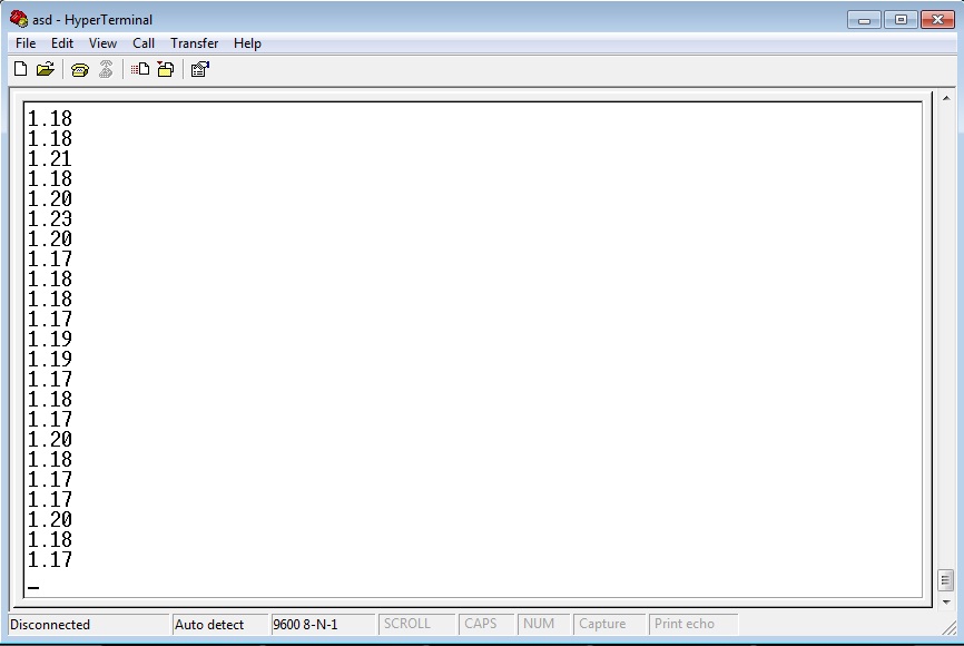

But still the output is not correct. I've attached a screenshot of hyperterminal when the input voltage is 3.72, its still showing weird values and nothing in front of decimal. What should be done? please help..

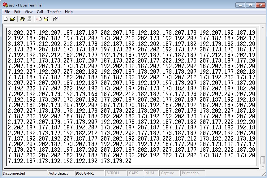

Here's the screen shot of hex value when input was 3.72 V. What might be the reason for wrong display in hyperterminal? please help...
---------- Post added at 11:37 ---------- Previous post was at 11:28 ----------
Here's the corresponding hex value for the data in hyperterminal. What might be the problem for incorrect display in hyperterminal. Please help me...
I think the last character does not show because TXREG gets filled, that is while() doesn't work properly. Try adding empty instruction cycle in while loop.
while (PIR1bits.TXIF == 0){ Nop(); }
This should work in MPLAB.

I used 400 ms display. Still I couldn't get the right value. I have attached an screenshot of the output when the input was 2.133V. Where shall i put the empty instruction cycle in the code to get it right. Please help...
I think Nop(); is also for delay. What can I do to get the correct output? Please help.
Nop() is one empty cycle. It's used when you have to have a command in some place without actually doing anything.
Use the command as I posted:
I see you removed brackets, which is OK, but than you need to remove the semicolon at the end of the while statement
while (PIR1bits.TXIF == 0)  //semicolon removed from here
    Nop();
With that semicolon in place, you've got the same code as before, only one empty cycle after.
Without the semicolon, while statement will execute Nop() over and over again.

But still result is the same. When the input is 3.715 V, it is displaying .17
I think I am doing something wrong because you said you got it right with the same code. Since, the input is 3.715V, the output should be 6 characters including "0D" for carriage return but I am getting only 4 characters in the hyperterminal including "0D". Can it be due to wrong configuration bits because in the configuration bit, the oscillator input is 20 MHz, but due to the internal oscillator, the overall frequency is 48 MHz? Please help.

The output was as attached. So even the last character is not displayed in hyperterminal. What might the reason be? Please help..

The value in hyperterminal changed but still its not correct. I have attached a screenshot for the input voltage of 3.712V. What might be the problem? Please help.
