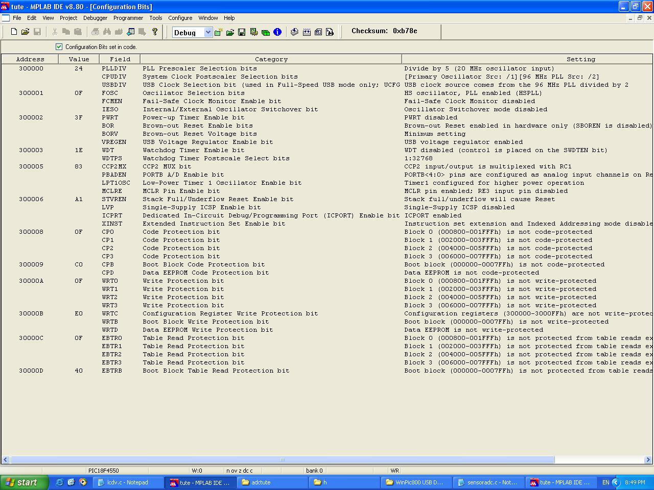

I am using 20 MHz crystal oscillator and i've also attached the configuration bits. I tried to check the outputs by putting leds in port D but in all the cases, the leds are behaving the same way. Some LEDs are blinking, some are glowing and some not glowing. What might be the main problem behind it? and how to solve it? Also, I want to view the digital signal in hyperterminal using UART. What modifications should I make for that in the code?

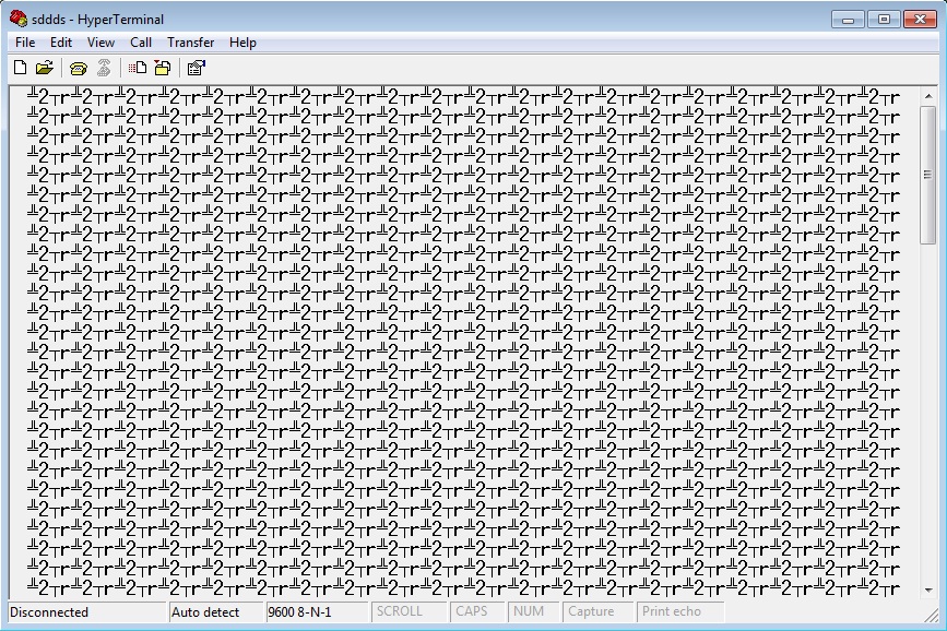

I am still not getting the digital signal in hyper terminal. I think there's problem with serial communication because even when i tried a simple code, it didn't show anything on hyper terminal. Here's the code:
#include <p18f4550.h>
void main(void)
TXSTA = 0x20;
SPBRG = 20;
TXSTAbits.TXEN = 1;
RCSTAbits.SPEN = 1;
while (1)
TXREG = 'T';
while (PIR1bits.TXIF == 0);
The 'T' didn't appear in the hyper terminal. Is there any wrong with my configuration bits? the configuration bits are same as previous case. Please help..
I think your SPBRG is not right.
For 20MHz, 9600bps => SPBRG=32
and for 19200bps => SPBRG=15
Ya it is 32. But I thought I should change it into hex, so I put 20. However, I tried to put 32 as per your recommendation but still its not working. Can it be due to configuration bits problem? Please help...
You have PLL and PLL prescaler set. I've never used 4550, so I don't know how it all works with the MCU and USB, are they on the same frequency or not.
I didn't take the PLL into account for SPBRG earlier. Find your MCU frequency (it's not 20MHz with the PLL enabled) and use that for SPBRG calculation.
Anyhow, try disabling prescaler and PLL and see what it does. That will be 20MHz. Than when enabling PLL again, adjust the SPBRG according to new frequency.
The issues you are experiencing are due to the fact the PIC18F4550 is running a FOSC of 48MHz not 20MHz.
If you examine the Configuration Bit Settings in the screen shot provided you have the following settings:
FOSC => HSPLL, HS Oscillator with PLL enabled
PLLDIV => Divide by 5 with 20MHz input
CPUDIV => 1/2 (Primary Oscillator/96MHz PLL)
The FOSC setting utilizes HS Oscillator Input with PLL enabled. The PLLDIV of 5 is the prescaler to derive the mandatory 4MHz input to the PLL, which in turn produces a 96MHz Clock. The CPUDIV settings of 1/2 indicates if the PLL clock output is used, divide it by 2 and use the resulting clock as the system clock (FOSC).
Reference: PIC18F2455/2550/4455/4550 Datasheet, Section: 2.2.4 PLL FREQUENCY MULTIPLIER, pg 27

Thank u so much for your suggestion Bjuric. I tried the following code:
#include <delays.h>
void Read_ADC(void);
void Send_Value (void);
unsigned long voltage;
void main(void)
	TRISAbits.TRISA0 = 1;		//RA0 = input for analog input
	TRISAbits.TRISA2 = 1; 		//RA2 = input for Vref input
	ADCON0 = 0x81;				// Fosc/64, channel 0, A/D is ON
	ADCON1 = 0xC5;				//right justified, AN0 = analog, AN3 = Vref+
	Read_ADC();
	TXSTA = 0x20;
	SPBRG = 77;
	TXSTAbits.TXEN = 1;
	RCSTAbits.SPEN = 1;
	Send_Value();
void Read_ADC (void)
	voltage = 0;		//globally defined as unsigned long
	ADCON0bits.GO = 1;		//start converting
	while (ADCON0bits.DONE == 1);		//wait for EOC
	voltage = (ADRESH << 8) | ADRESL;		//combines two bytes into a long int
	voltage = voltage * 5000;			//Vref is in milliVolts
	voltage = voltage/1023;			//10 bit ADC
	char ch;
	ch = (voltage/1000) % 10;		//extract thousands digit
	ch = ch + 48;			// now it is in ASCII
	TXREG = ch;
	TXREG = '.';		//We need a decimal point
	ch = (voltage/100) % 10;		//extract hundredth digit
	ch = ch + 48;
	TXREG = ch;
	ch = (voltage/10) % 10;		//extract tenth digit
	ch = ch + 48;
	TXREG = ch;
	ch = voltage % 10;
	ch = ch + 48;
	TXREG = ch;
But there's still some error. I've attached what I received on hyperterminal. Where might be the problem? Is there any problem with ADCON registers? Please help me. I check the input voltage as well as reference voltage as well. They are all fine.
