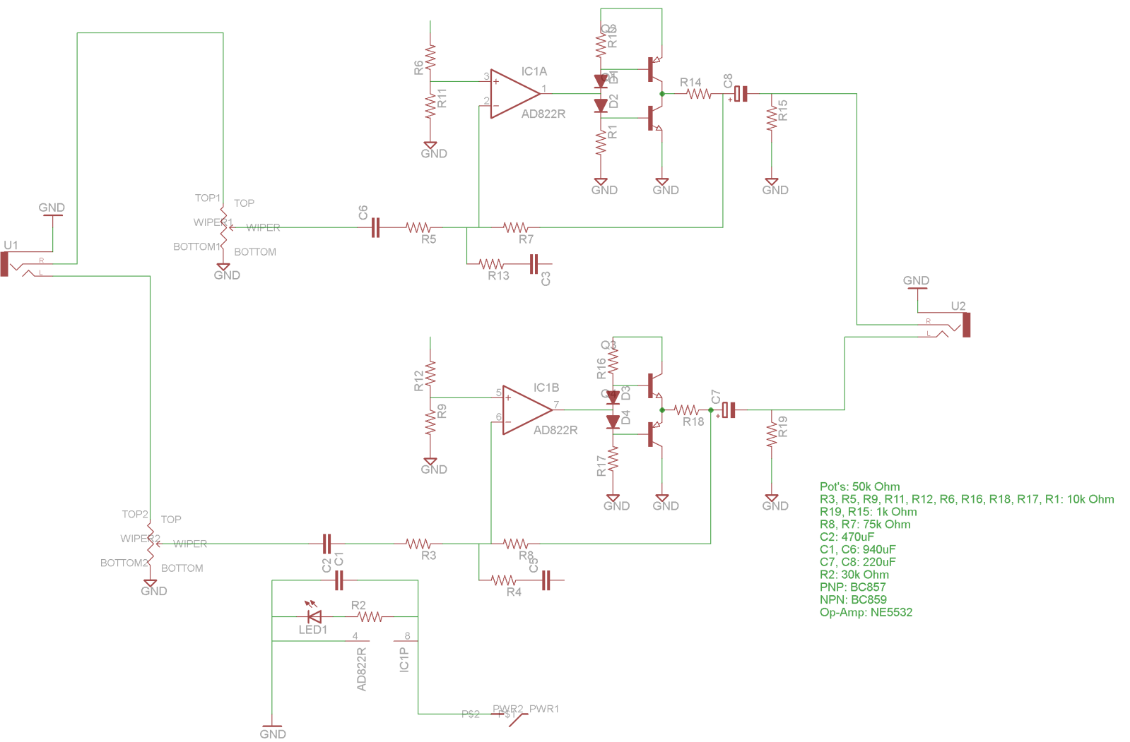

Your NE5532 is a preamp, not a power amp. It might oscillate at a high frequency if it is loaded with the capacitance of a shielded audio cable that connects to the power amplifier. The series 100 ohm resistor has no effect on the response into the 10k ohms input resistance of the power amplifier but it isolates the output of the preamp from the capacitance of the audio cable it is driving.
The power amplifier (that you do not have) drives a speaker or drives low impedance (32 ohms) headphones.

I've made a new design using the NE5532 as an input stage with BJT class AB output stage. It will be powered from a chassis mounted center tapped transformer. The input, output, rectifying caps and feedback/non-inverting input resistor/100nF IC capacitors all have their own ground path. It might not be ideal that R6, R14, R7, R12, C6 and C3 have their own ground path, but I was thinking that this path won't carry much current so it won't really be an issue. I've also increased the trace width of many of the traces. Can I hope for my first noise free non battery powered amplifier with this design? :p
NB: R15 and R16 are 0ohm jumper resistors.
That's probably a huge improvement but still has a few potential problems:
1. The output stage bias isn't fully stabilized, you are relying on the voltage drop in the two diodes being the same as the Vbe of the transistors to set the class A region of operation. The op-amp will pull the appropriate transistor into conduction and mostly cancel the distortion effects but for best performance I would use a circuit that stabilized it's own bias point and allowed you to adjust the quiescent current.
2. You may still have a noise problem! The output stage has current gain which is great for driving your headhones or even small loudspeakers but it has no voltage gain. You are still relying on the op-amp to boost the signal voltage as before so if the gain caused problems before, it still will.
If you add an extra stage before the output transistors you can fix the bias problem, isolate the op-amp from the feedback loop and give it some extra voltage gain in one step.
Brian.
I can see that there is an issue with the bias, but does it matter that much? Since this is a headphone amp, I don't really want it to enter class B operation so as long as I can find the right resistor values to give me the right bias current, I'm happy.

You are using a very high supply voltage of 34V for your headphones amplifier to blow away your hearing. Your schematic shows only 10V which is fine but will still play headphones loud enough to destroy your hearing.
You are using enormous high power transistors when little transistors will be fine.
R3 and R4 should each be 0.33 ohms and the bias resistors should each be about 22k. Then the idle current of each amplifier is about 20mA (for class-AB with no crossover distortion) and they each dissipate only 200mW.
R3 and R4 reduce the hFE of the output transistors so that they are better matched and they reduce the effect of temperature change which changes the idle current. The diodes should touch the output transistors for better thermal stability.

It is difficult unless you select transistors and diodes that have the same specs.
And what effects would increasing or decreasing the value of R3 and R4 have?
R3 and R4 should be 0.33 ohms so that they do not affect the output current much.
I also noticed something strange. My NE5532 get's really hot which I can only assume is because of too high supply voltage. The datasheet says +-15V as recommended supply voltage, but +-22V as maximum rating so I'm not sure :(
Your supply voltage is fine but should be reduced to limit the output power. Your opamps are probably oscillating at a high frequency due to a missing supply bypass capacitor, driving the capacitance of a shielded cable, driving a lower resistance than 1k ohms or a poor layout (input to output coupling).
EDIT: I forgot. Your huge very old output transistors are very slow so they add phase shift that might cause oscillation. Smaller and newer transistors are much faster with very little phase shift.
There is a further reason why the NE5532 might get hot: they have parallel diodes across the +/- input pins which limit the voltage across them to about 0.6V. In that design, there is a potential for both transistors to be held in a cut-off state, depending on the transistor types and the diode types. A normal op-amp would, through it's feedback, shift it's output to compensate for the lack of bias (although that may not be desirable) and bring the appropriate transistor into conduction. If the feedback resistors are too low in value, there is a risk of the limited input voltage being exceeded and the transistors failing to turn on. It's a very slight risk but there nevertheless. Personally, I would keep the power amp and pre-amp stages completely apart from a DC point of view but if you want to stay with that design, I suggest changing the NE5532 to a 'normal' op-amp such as the TL072/TL082 and keep the NE5532 for use as a pre-amp stage.

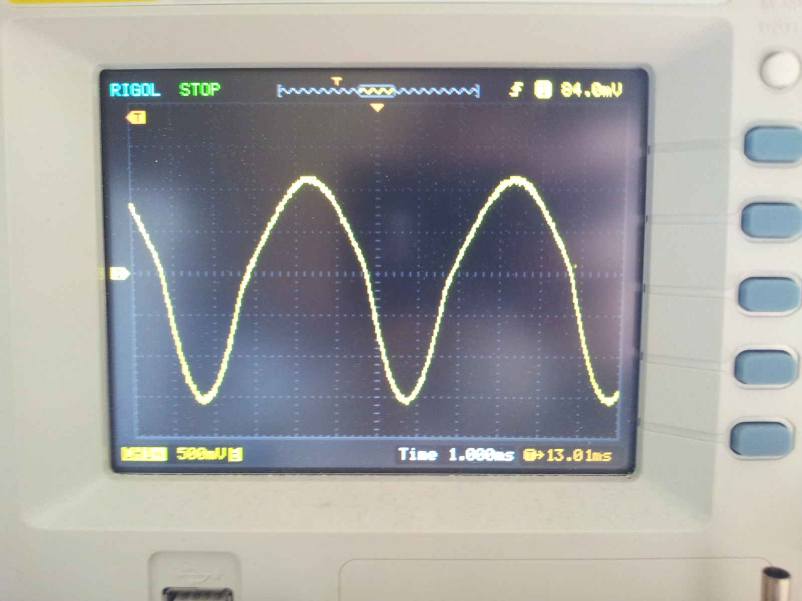

The responses in this thread has been so great so I don't want to let it go just yet. I've made like 50 of these Cmoy amps before (with NE5532's) and they have worked out great. Today I encountered a weird problem, I got distortions like these: https://obrazki.elektroda.pl/9654657000_1378587690.jpg. I then tried to make another amplifier, but to my amazement, the exact same thing happened. The only real difference was that I started using 220uF 16V output caps because I ran out of 220uF 10V caps, but replacing them with 330uF caps made no difference. I tried to get some help at an IRC channel, but it was difficult to get help fixing a circuit with an op-amp that is really not meant to drive loads of such low impedance's. I then decided to make one with a bjt output stage, but guess what, the exact same thing happened! This new amplifier can output more power and I have to turn the volume up higher to hear the distortion more clearly, but it's still the exact same thing. Every component is the same as the 50 other amps I've made, the NE5532's are even from the same reel. Here's a schematic and parts list of the new amplifier I made:
https://obrazki.elektroda.pl/9993570300_1378587719.jpg
It's not actually clear under which operation conditions the said distortions occur (load impedance, supply voltage level and voltage source impedance). Previously mentioned deficiencies of the circuit (e.g. missing bias divider bypassing) might also cause distortions.
Sorry, I guess I was in too much of a hurry. The load is a 62Ohm headset, the supply is a 9V battery (thus no bias capacitor). The distortion isn't that audible at lower volumes and it's also just audible in the lower frequencies.
The output above half supply seems to be lower than below half supply. Are both channels showing the same distortion? You have the output transistor connected differently from one channel to the other.
