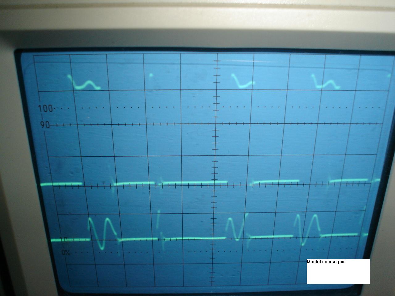

I test 3842 in non-feedback state and pwm was constant
Is this also true for output volatge/load conditions that caused instable behaviour with feedback. It's possibly not easy to vary the
control input in this mode, but it should be possible. If you can achieve stable operation this way, you basically proved the current
mode operation itself is stable. Then you can try to operate the feedback with PI compensation (C7 with a series resistance). C7
can be 100 nF or even larger, the series resistance should be in the low kohm range.

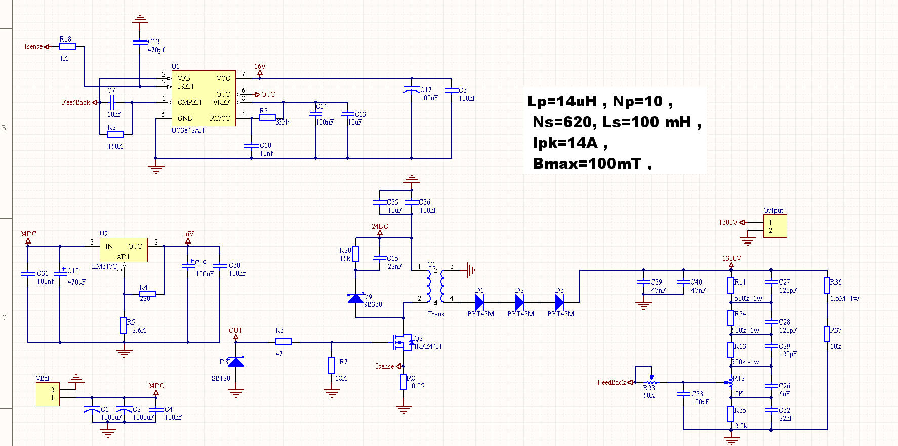

P.S.: I took a closer look at the circuit and found two points:
- With full load, the circuit is not operating in discontinuous mode. So slope compensation is needed for stable operation.
- The transformer windings ratio is unusually high for a flyback converter. Even at highest output voltage, the flyback voltage is still lower than the forward voltage. I guess, the dimensioning has been choosen due to the low voltage rating of the switch transistor.

Hi FvM,thanks you for consideration
yes, output has instable behavior when we have sound.
I test it with 37K load at output. but the current of source was discontinuous(perhaps) .it is the source pin of mosfet with 37k load and 1060 volt.in this voltage it doesnt have sound. and with this load(37K) the output voltage doesnt reach to 1250 volt. :cry:
its new schematic that I was remove snubber circuit that in parallel with mosfet and replace 3842 with 3844 and adjust RC of oscillator for 50 khz.

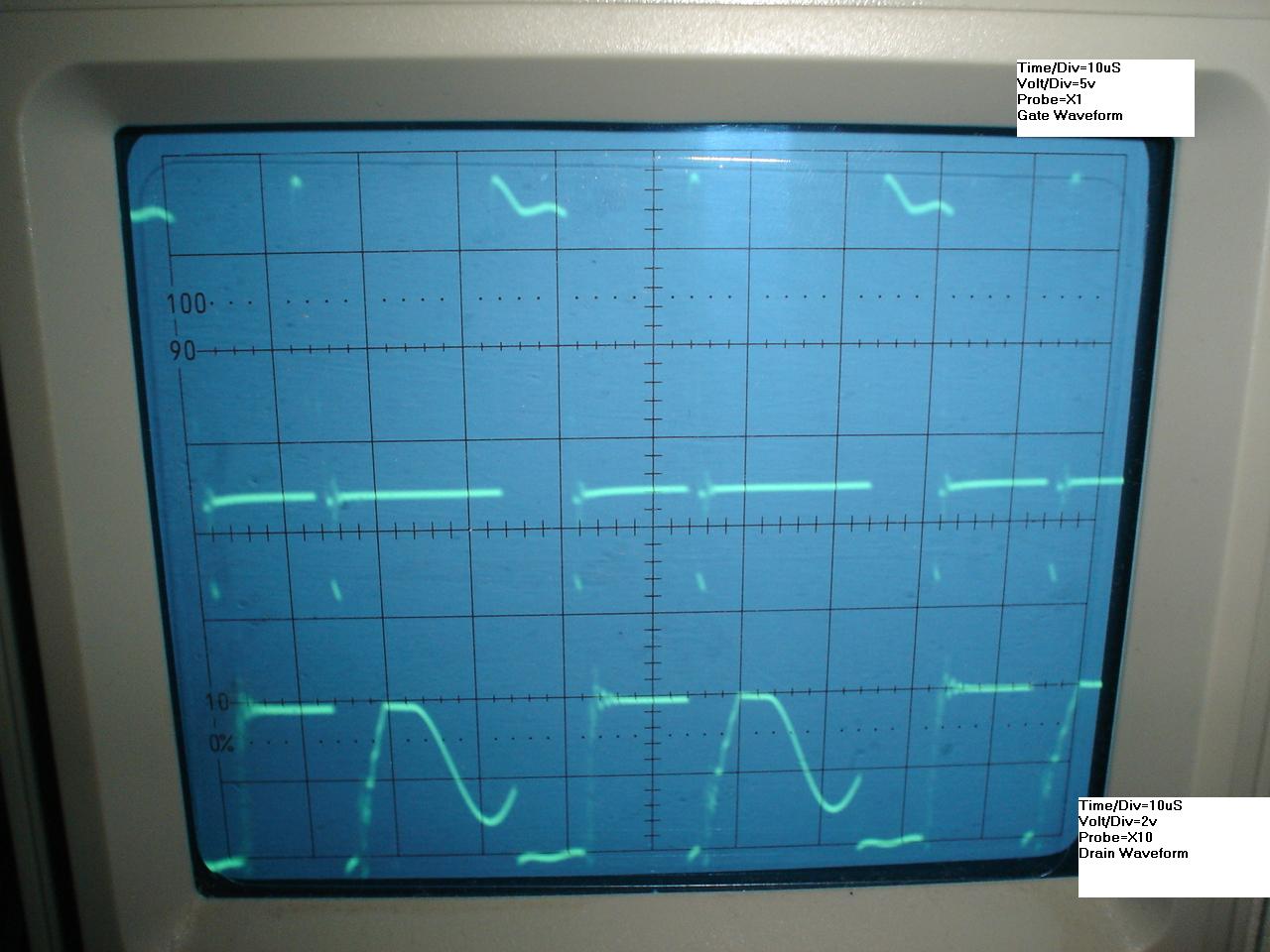

and its the drain waveform.
but I dont konw why it is like a sinus wave!!!?? can you guess from the picture that it work in DCM or CCM?
I guess that 620 rounds for secondary is high.I calculate that Ls=85mh but for considering dissipation I take it 100mh!!! is it false?
The "sine wave" following a rather short on-period is surely DCM, the other cycle looks rather like CCM. So I guess, it can be still a problem of basic current mode instability with missing slope compensation.
Dis you ever try to add a slope compensation circuit as suggested in UC3842 datasheet?

Hi
I change my oscillator capacitor with 4.7 nF and use one multi turn(10K) for its resistor. I adjust it to 50 khz. now duty cycle goes up to 50% and output voltage goes up to 1000 volt with 35k load. now the efficiency is 60%. how can I do it better?( for example 1250volt with 32K load) . one of my friend told me that use mosfet driver inside of 3844. can you tell me your idea about it?
regards
I don't think, that the losses are primarly caused by the gate drive, but you are slowing down the switch operation with the
47 ohm gate resistor. Reducing this resistor would be first measure to improve the gate drive and speed up switching.
I rather think, that most losses are created by avalanche breakdown of the IRF44.

Hi
now I replace the 60v schottky diode with 100v diode and 10nf capacitor with 4.7k and it works. the spike voltage of drain was 60 volt but before it rises to 75 volt.
but one question
the maximum output voltage is 1300 volt(Iout-max=40 mA). I use 3 very fast diode (BYT43M , 1000v) with two capacitor(47 nF , 1600V)
is it a correct rectifier or I must use one very fast diode with 4000 reverse voltage?
also I want to put 3 resistor in parallel with 3 output diode. how can I calculate the value of these?

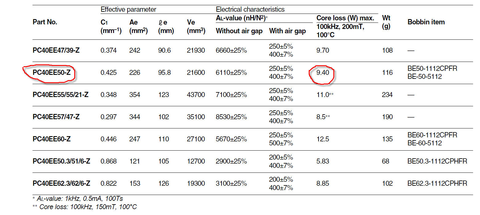

I use EE50/40. I want 50 watt at output. but now about 30 watt. at above datasheet says that about core losses( 9 watt). does it means that I should suppose output power at about 60 watt?
Serious connection of multiple diodes is no problem in my opinion, it should work without additional resistors.
Regarding core losses, you calculated 100 mT, versus 200 mT specifications for the losses, so you won't have more than
1.5..2W losses, which is more convenient. But in fact, you have to consider all loss contributions. Their sum is apparently causing
the efficiency problems with your design.
