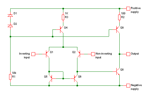

Here is a simple opamp circuit:
Q1 and Q2 are NPN transistors that make a differential pair.
Q4 and Q9 are NPN transistors used as current sources.
Q5 and Q6 are PNP transistors that make a current mirror.
Q8 is a PNP transistor used as a common-emitter gain stage.

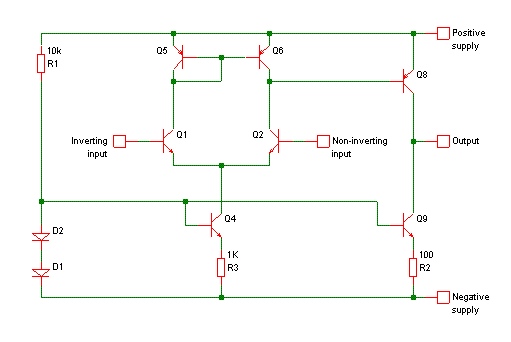

But we can also turn the whole circuit upside down and swap the PNP and NPN transistors, so it looks like this:
Now the differential pair and current sources are made with PNP transistors, and the current mirror and common-emitter gain stage are made with NPN transistors.

The answer is: It can't be seen from the schmematics snippets you are posting. You need to understand the purpose and overall function of the circuit to analyze the details.
Apparently not all transistors and diodes in the circuit are continuously in active mode, thus not all will expose a forward bias voltage of 0.7V. This must be also supplemented as a resevation to the discussion in post #17 to #20, which only applies to transistors in active mode, e.g. linear amplifiers.
To illustrate the point, take a look at Q2. It's base-emitter voltage is zero unless an AC voltage will be coupled to the base via C19. The AC voltage will be rectified and forward bias the base-emitter junction during the positive halfwave. If the AC voltage has about 50% duty cycle, e.g. a sine voltage, the average base-emitter voltage that can be measured with a voltmeter will be still around zero.
