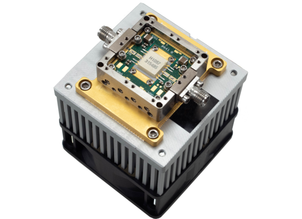

I suggest you review the recommended circuit
To avoid design/Assy failures on 1st evaluation of the $1200 RF FET board on Roger’s substrate with proper thermal attachment with wire bond connections and regulated control board ~$250 approx will achieve better use of your time to evaluate the design recommended by Qorvo starting at 5 to 8V for Vdd allowing increase to 12 or 15V when confident results are achieved.
Quantum-X Microwave has a lower cost eval kit about half the price.
https://www.mouser.com/images/marketingid/2024/img/135793161.png?v=070924.1056 From Mouser.
I don’t think you are ready to roll your own yet.
