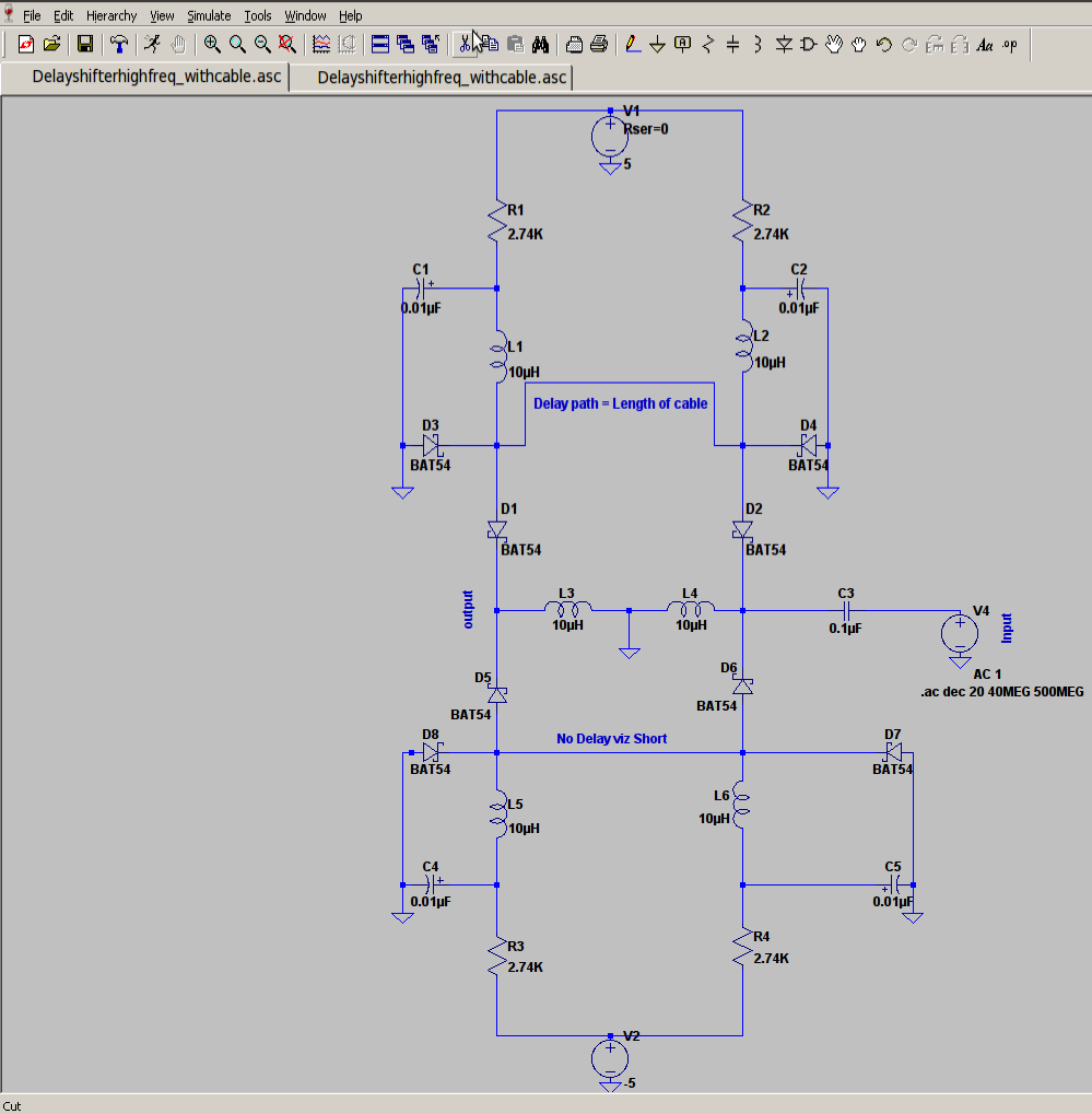

Hi friends can any one suggest a schematic of a wide band (30-500MHz) analog time delay circuit? I need a maximum time delay of 5ns with steps of few pico seconds. I will be very much thankful:-D.

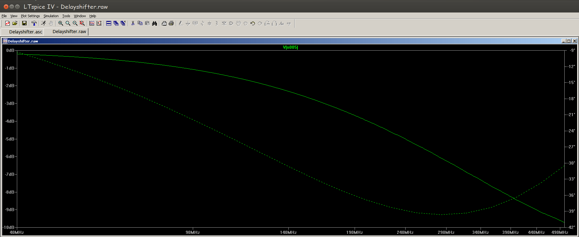

Hi I don't know how to do VSWR simulation in LTSPice. I Googled it and found nothing helpful. If you know how to do it can know explain briefly? Thanks in advance...
