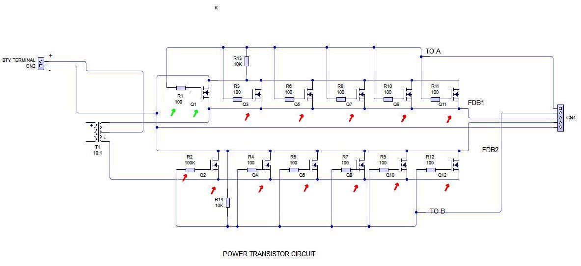

Why would MOSFETs heat up in an inverter while charging with the same inverter
All FETs are shown connected wrong way. This must only be in schematic drawn otherwise inverter won't be working. Similarly R1 And R2 be 100 ohm like other gate resistors.
When mains is restored, a relay connects mains input to mains output after disconnecting inverter output and also disconnects DC from control circuit.

It is not advisable to make 3.5Kva inverter using 24vDC , you are dealing with almost 146 A, which is too high. Battery voltage should be at least 60Vdc.
Because you are using a transformer of 146A capacity if the charging is not controlled using some circuit it will surely heat up. please post the charging circuit.

I have also faced this kind of situation.In inverter mode it was working fine but in charging mode both channels start heating
(sometimes it burnt).I have checked sg3524 osc. was off but there was about 0.3v present at the gate of FET's. Changing
the driver transistor solved my problem (it was a leakage current ). In your case replacing Q13 & Q14 may solve the problem.
Thanks
replace it with what other value?
Try to use "totem pole" driver,gates of fets become 0 volt during charge.

You can test weather a charging circuit is necessary or not by the following experiment.
1 switch off the inverter
2 remove the mains and battery
3 disconnent the Cn4 connector
4 short gate to sorce of power Mosfets
5 connect battery
6 connect mains
Now measure the charging current with a clipon ammeter and post , If the mosfets still heats up you will require some circuit to controll charging

I have simply used BC547 to sort out my problem.you can confirm whether our problem is same or not just remove Q13 & Q14 and start charging.Now check the heat sinks, "if it
still heating you need to revise the transformer & MOSFET Bank circuit".
Thanks
Check the outputs of the driver stage (to MOSFET gate) to ensure that no gate drive signals are generated.
It is best to observe the signal on an oscilloscope. You can also use a voltmeter to see if the outputs show a steady 0V.
thanks Tahmid,i used the multimeter and its reading -0.205v and when reverse the props its +0.205v

One more thing is that the outputs of the SG3524 should be pulled down. Either connect pull-down resistors from pins 11 and 14 to ground or connect pull-down resistors from bases of Q13 and Q14 to ground.
like what value of resistor ?
can someone post the a detailed transformer winding formula for 3.5kva/24vdc inverter
Use 1kΩ resistor from pin 11 to ground.
Use 1kΩ resistor from pin 14 to ground.

@ALERTLINKS the grounding in the above switching diagram,is it just to the chases[the inverter case]
It is 14pins 220Vac relay commonly used in UPSs. It contains four switches. As three of them are used, the fourth is paralled to increase current handling. Grounding is somtimes shown for neutral wire. It is not connected to ground or chassis.It is only indicative of neutral wire. If you need grounding, it is connected to third prong which goes to earth connection and is not shown in diagram.
