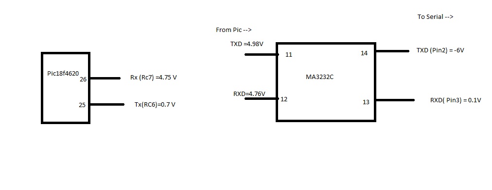

I just checked the voltage on the J1 ( serial port). Pin 2 (Tx) = 6.09 V and Pin 3(Rx) =0.1V . Does this seem right to you?
I tried using "Real term" and once it gave me an error "Break" suggesting that RXD line is broken. It relates to the V on Rx pin being 0.1 V . What V should be on Rx?
(By V I mean Volatge)

I measured the Voltage across relevant pins and here are the voltages :
Please let me know if you see anything unusual :

Test the MAXIM RS-232 transceiver chip on your PICDEM 2 PLUS by pulling the PIC18F4620 from the board and shorting the appropriate TX and RX pins of the DIP Socket, then perform the same loopback test from your PC.
BigDog
---------- Post added at 03:53 ---------- Previous post was at 03:49 ----------
I believe you'll need to jumper pins 25 and 26 on the 40-pin socket, to successfully create a loopback.
BigDog
Yes I just tried this and it works fine ! This means my board is fine but my PIC is faulty?

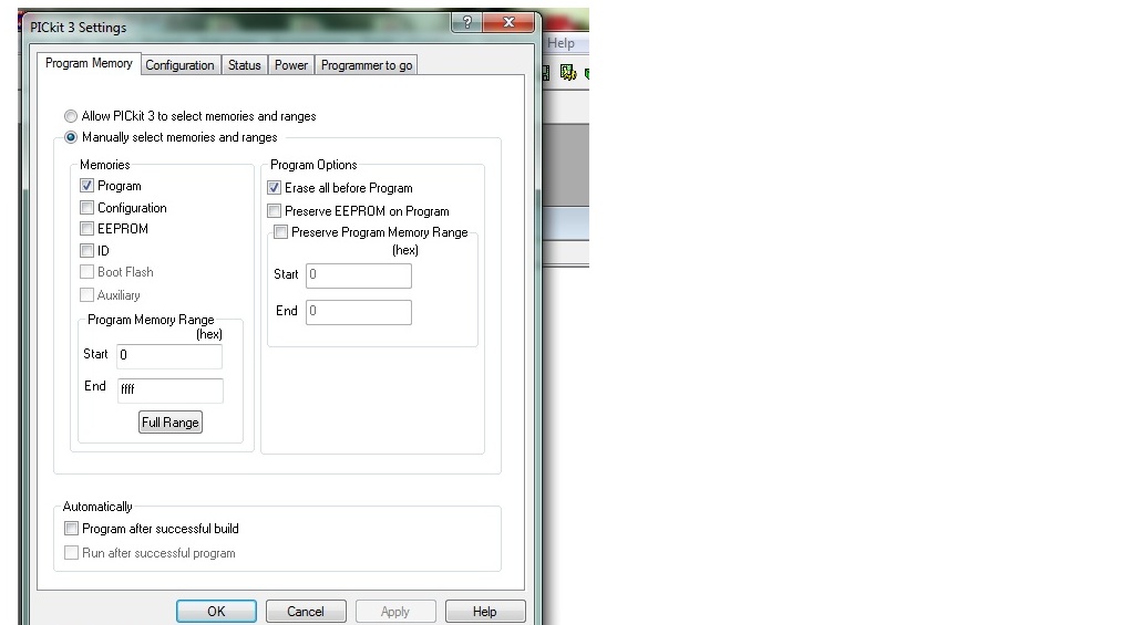

My Pickit3 Setting: Initially I had " Manually select memories and ranges" On and had selected -Program , Configuration, EEPROM and ID. Also Program Memory range was from 0 to ffff. With this the error was : 'Unable to open com3 , please check your port setting"
With just "Program" selected( as shown in the pic below), the above error doesnt come up nor does anything on the hyperterminal !
Whats the correct "memory setting" ?
I would recommend selecting "Allow PICKIT 3 to select memories and ranges."
While I do no have a PICKIT, I use a similar setting for most of my programming with the ICD2s and ICD3s.
Manually specifying these parameters can be quite tricky.
BigDog

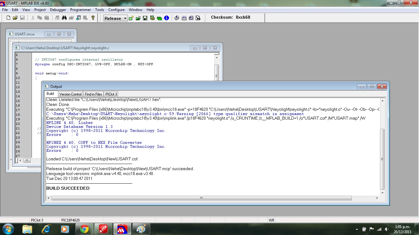

Are there any errors or warnings displayed in the build window? Can you post the contents of the Build Window?
The code obviously runs on your board, compiling it on your PC seems to be the issue.
BigDog
Here's the pic of the Build Window:

As i just noticed in the above pic, I do have a warning : Warning [2066] type qualifier mismatch in assignment
This if for the line: putrsUSART(" Hello World! ");
Normal. It is an implicit type conversion from "const char *" to "const rom char *", I receive the warning as well.
