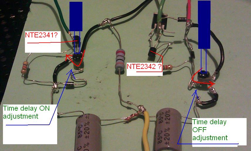

Here's what it looks like (2x2 inch board) until I put in fixed resistors:IMAG0170.jpg IMAG0171.jpg IMAG0172.jpg IMAG0173.jpg
Nice job, :cool: take care of ‘’cross wires’’, need to consider isolating that piece of wire.

Thanks. There's a lot more space between there than it seems in the picture. I might have to do it over anyway because its not working now. Relay won't activate. It did for a second, then it stopped. I've been going over it, trying to see if I missed a connection or something, but no luck. I just put it aside for a while cause I was up for hours trying to figure it out. Figured I'd come back to it with fresh eyes. Then I may see if I did something wrong. Other possibility is something went bad from constant heat (which I think is the case). Either way I'll figure it out and correct it. Either the pots or transistors. But I'll probably replace everything just in case. Thanks again for all your help mister_rf!!!
