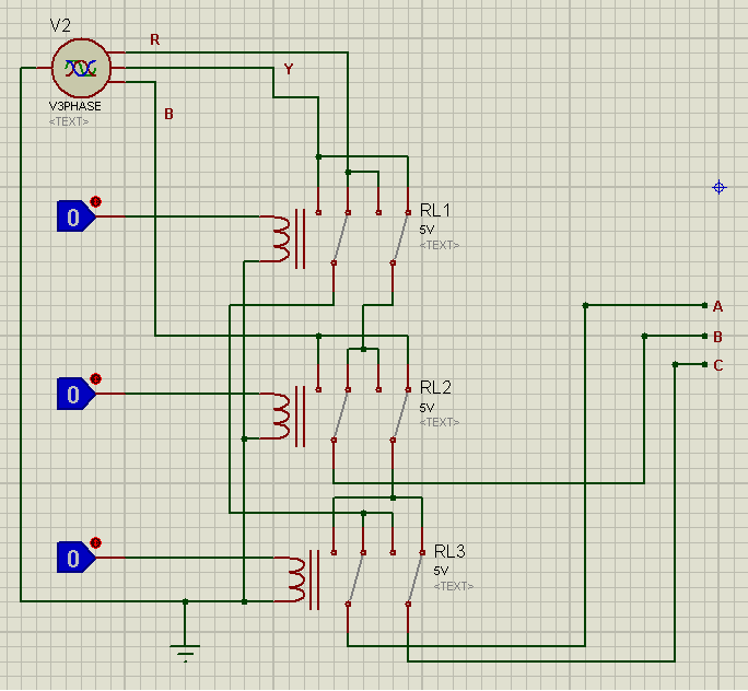

I have attached the relay circuit. My supply voltage is red, yellow, and blue. I always want phase red at pint A, phase yellow at point B, and phase blue at point C.
If any phase change its position then by switching relay i should be at the restricted points (as mentioned above). But this circuit is not working properly; Can you tell me that is wrong in this circuit??????????
As Prototyp_V1.0 explained, you only need to change two phases, so I don't see an understandable motivation for using three relays. The standard design for automatic phase reversal is to have two 3-pole contactors for the motor, one is energized with correct mains phase and the other with reversed phase. Phase sequence monitoring relays to control it are industry standard products.
When using double throw relays for phase switching as in your circuit, you have to care, that the "break" arc is extinguished reliably before "make", otherwise the relay will be distroyed quickly. Using separate contactors allows to keep an intentional deadtime during switchover.

The connection matrix between ABC and RYB has 6 possible states, all can be achieved with your relays circuit. So although, I don't see it's purpose for driving a motor, it's basically working.

I don't know what's exactly meant with this statement. As mentioned repeatedly, from the motor's perspective there are only two states forward and reverse (power off and phase failure in addition, of course). But if you have an absolute phase A (or time) reference, then the said six connection cases exist. In so far, the shown circuit is supposed to work.

I agree, the circuit CAN achieve all 6 permutations.
However, the circuit as posted has 8 possible states. Two are redundant.
When Rly B is energised, you have the same output state as when Rly A, B & C are energised.
When Rly A & C are energised, you havet he same output state as when Rly A & B are energised.
I wouldn't call that "not working properly".

They can't be "eliminated", they are just there, because two raised 3 equals eight. It get's more and more mysterious what you are trying to achieve.
As been said, one (DPDT) relay would be sufficient to reverse the motor. To be able to connect all phases at will, you need more than two relays, because 2 raised 2 equals four, which is less then six.
Yes, FvM, the redundancy is in 2 of the possible 'states' of the 3 relays, not in components in the circuit.
Nothing has to be eliminated, but the relay controller must be designed so that the 6 useful 'states' are possible outputs (and 2 'states' will never be used).
