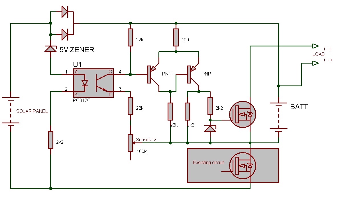

I got an another circuit, I am planning to use this circuit. This is microcontroller based charge controller. AND USES N-CHANNEL MOSFET. Using n-channel was my primary intention. They are cheaper & have low RdsON. (IRFZ44-0.024ohms, IRF9540-0.117ohms) so less heating.
I want to change the design in two aspects. Firstly I want to add a switching circuit (either relay or MOSFET) so that the load after battery should only be connected when the solar voltage drops below certain voltage. (load will be ON only at night)
Second thing is to add reverse protection for battery so that in darkness the solar panel should not draw any current from the battery. Here again I am planning to use n-Channel MOSFET in ground path.

It require only a diode in series with solar panel. Reverse polarity protection is required where battery is disconnected often and there is a risk to connect it in a hurry with opposite polarity.
It is better to include these features controlled by microcontroller but otherwise it can be connected this way.

Thanks, the circuit looks really good, I will try it. I can also use it in the previous circuit (using TL431). BTW that circuit is working fine now. The battery was faulty so no charging current & the solar panel voltage @16V appeared on battery terminals.
One more help please. I observed that the when using n channel MOSFET it does not heat as much but the diode needs a heatsink. So is that can I replace the blocking diode **broken link removed**.
One more thing, can I use the same MOSFET in your schematic as battery low cut-out?

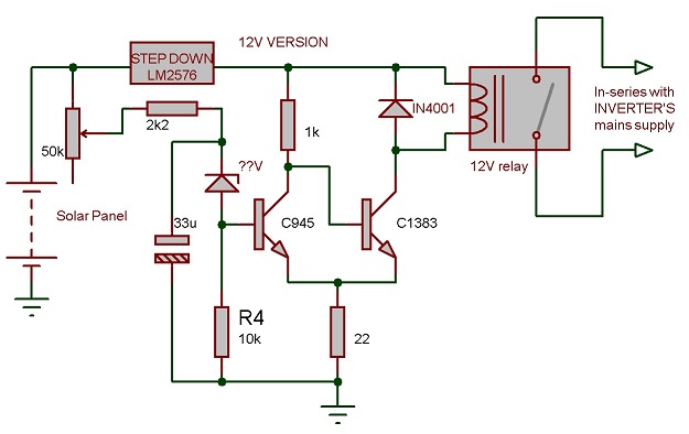

actually I have various types of system installed from 12v to 48v solar Panals (Voc from 21v to 84v) what I want here is to have such a system that when the solar energy is present the inverter should not be charging from utility electricity (in my Case WAPDA). such that the electricity bill could be reduced. I want to have a relay which disconnects the charger (MAINS) and just let go the solar charge by sensing the solar voltage and of suitable voltage from solar panel is found then switch off the relay.

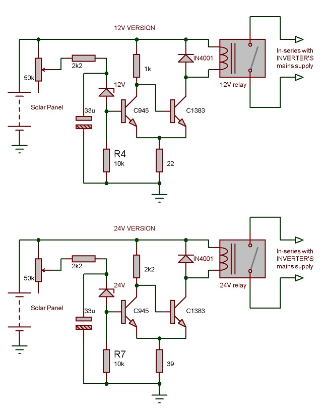

@ALERTLINKS thanks for the quick response, but how it would be done for 24v system and how did you calculate the 15v limit give me some hints so that I can adapt this system for various situations. does any NPN would do the job. and I also want this circuit to be run from solar panel with no voltage from battery or power supply

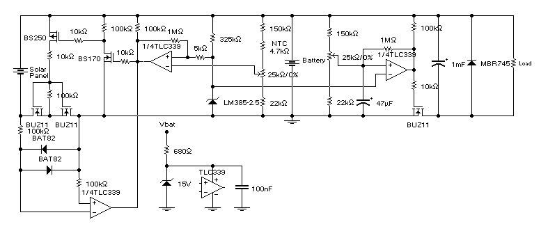

The only missing feature that I need is to control the load as per the ambient light conditions. For that I am planning to use the fourth comparator.I will connect its +ve input to the reference voltage (2.5V) & -ve to a voltage divider network across the solar panel. Its output will be connected with the rightmost comparator output. Will it be okay?
I have some points, please clarify if I am wrong.
1. I think IRFZ44 is better than BUZ11 in terms of current rating as well as RdsOn.
2. We can use LM339 as its current consumption (@1mA) will be a fracion of the overall circuit consumption.
3. Is the MBR745 necessary at the output, what is its purpose?
4. Is capacitor of such a high value (1mF) needed at output?
5. Should I use 78L15 instead of the resistor & zener?
6. Do you find any problems in the circuit? I am asking this question because the author has mentioned the following..
It has been working fine for a year now (unlike my first attempt), although I suspect an unwanted state still occurs every now and again. Suggestions for improvement are welcome.

Ok but the PV voltages are not 24 volt and and 48v their Voc are higher then the the battery voltages, so should I select my zener values according to the Voc or the required voltage of switching. another problem is that I want to use only 12v relay in each case, so weather I should use regulators or dropping resistors.
Zener diode is according to battery. Make a step down circuit with LM2576HV.
https://www.hobby-hour.com/electronics/lm2576-step-down-switching-regulator.php
It can work up to 60V. Feed this 12V to circuit and relay. Use zener according to battery. Only input on variable is directly connected to solar panel.
@vbdev. You are thinking on right path. I would consider using IRF3205 to support 20A-30A charging. In the present circuit it is considered to draw minimum current which is not necessary with big battery and high power. There is a resister missing which should be there.
@ALERTLINKS! You can count my One thanks, I am also biluding the circuit containing the TL431 but as from the original website ( Select the solar panel in such a way that its amps capability is within the safe charging limit of the battery you intend to use.) can I use Mosfets like IRF3205 for higher currents or how to parallel them for high ampare.
