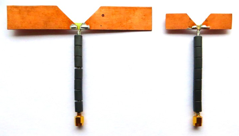

Cut piece of double-sided PCB 20-25mm wide 145 - 150mm long. Mark middle of the length on both sides. Draw middle line across antenna width. Remove copper strip on both sides 2 - 5 mm wide along middle line. Make sure removed strip is symmetrical to middle line you drew earlier. Do this on both sides of PCB. Cut notch in PCB, ~90 deg, again, symmetrical to middle line as it is shown on photo. leave ~5mm PCB width so it will not easy to break. Connect together copper on each side of PCB. How - make hole in each half close to middle line where copper is removed; push wire through; solder on each side. Take cable you plan to use with antenna. Use thin coaxial cable: RG316, RG178 - the thinner the better. (I use rigid coax.) No need balun or choke for tuning as you will keep cable perpendicular to antenna. Calibrate NA at the edge of the cable: O/S/L. Solder coaxial cable to antenna: central conductor to one side, braid to another side. Make small solder joints. Make sure coax connected symmetrically to antenna perpendicularly to it's edge. Refer to attached picture. Place antenna in such way that it sits in the air, no metal around. Make sure cable routed perpendicularly to antenna. (I usually place antenna horizontally, mounted it on narrow styrofoam blocks, cable runs down). On Network Analyzer you should see deep resonance at ~850MHz. Gradually shorten length of your antenna cutting away ~1 mm at a time from each side so your middle point remains in the middle, until your resonance moves up to 915 MHz. You are done!
If all done right you should have ~100MHz Bandwidth below -10dB return loss (way wider then 900 ISM band), gain 2dBi efficiency > 95% when copper is fresh (efficiency will go down a little when copper oxidizes.)
picture shows two antennas tuned for different bands.
I hope this helps.
