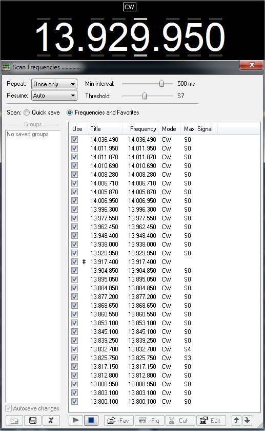

HRD (Ham Radio Deluxe) has an option for "Scan Frequencies".
Just connect HRD to your IC-R20 (it's in the ICOM list) and after that chose Scan Frequencies from the Scanning bar, tune manual the IC-R20 on desired frequency and press +Freq.
Repeat for all frequencies. The operation is much faster than you believe. After you enter all the frequencies for a band you can save them as a file, and use later.
HRD list shows the S (strength) level on each scanned frequency, and perhaps if you open the Digital Master you can see the signal in waterfall. The problem with waterfall window, has only 3kHz span.
Do you know why the IC-R20 scans so slowly when connected to HRD?
The scanning speed is close to a hundred times slower.
When not connected to HRD the R20 scans at about 10 s/MHz. To sweep 3 GHz will about take 8 h.
I thought I could use HRD to automate this but the scanning becomes very much slower. I set the baud rate to max - 19200
Is it because I have a serial CI-V cable?
Should I get a USB CI-V cable?

The speed is slower because of the data communication link. CI-V is a single wire system so it can only carry traffic one way at a time, it has to alternate between setting a frequency and returning the signal level so it can be displayed on the computer. I *think* (I have never checked) it sends the new frequency each time to the receiver rather than telling it to step by itself so obviously that takes longer and slows it down. In scanning mode, the receiver simply tunes to the next frequency and reads the strength of any signal it finds, when one exceeds the limit (squelch level) it stops scanning. Inside the receiver the frequency is set by sending a number to the oscillator circuit so all it has to do is add one to it to make the next frequency appear. A USB CI-V cable will not be quicker, the hold-up is the connection to the receiver and the data transfer which will still be at the same speed as a non-USB cable.

You can try the USB interface.
On my ICOM I am using a home made serial CI-V interface and the scanning speed is about 1 second for each frequency, even if I set the minimum time interval in HRD to 100 msec.
On HRD you can set the scanning modulation to any modulation supported by the remote radio. CW should give better information about the power level in that channel, and if something is there, you can use different demodulator available.
