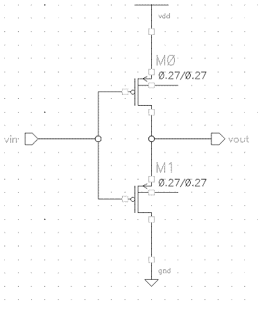

Hi All If we replace the nmos in inverter with pmos what will be the output i.e top pmos source is given to 3.3v supply and its drain is connected to bottom pmos source and bottom pmos drain is ground. Both gates are short and if input =0 what is the output.??

Is it possible to connect like this. Vin is 0V

I am asking just what is the output if we connect both pmos in an inverter configuration and apply 0 at the input.
You'll want to specify Vth of both transistors first. Assuming enhancement type for both transistors, the output voltage is literally undefined, somewhere between |Vth| and 0.
P.S.: The circuit function is changed from inverter to non-inverting buffer, of course.

why the output voltage is undefined if the gate of pmos is 0V then it will be ON and it should act like a pass transistor??
Since when a MOSFET is on with Vgs of 0 V? It would be only in case of Vth=0.
but the top pmos is haviing Vgs of -3.3V then it should be on atleast

I fear the confusion is caused by not posting a schematic.
I thought of changing both transistor polarities, would make sense at least.
A two PMOS transistor circuit is just nonsense, shorting the power supply with 0V input.

Nevermind, I think I cracked it. It was a gimp XCF file saved with a .png extension.
Anyway, here's the circuit the op uploaded:
It looks like a bad idea.
  • If the input is high, then both MOSFETs are off and the output is undefined.
  • If the input is low, then both MOSFETs are on. The top one will be switched on harder, so the output voltage should be pulled high. However a lot of current is wasted and the MOSFETs may burn.

What you said is right both the pmos will be ON but actually one will be in saturation and another in Linear and the transistors wont burn inspite of high current but that high current wil be in the order of uA.
we can make both the transistors operate in saturation by adjusting their W/L's
the operating points of both the MOS then be identical
that is the calibration or the ratings of the MOS must be uniform if variations are there then it would cause some problems
but i must agree that power loss will be high here
OK, but it still won't work as an inverter because the output is undefined when the input is high. You would get almost the same results if you left out the bottom MOSFET.
