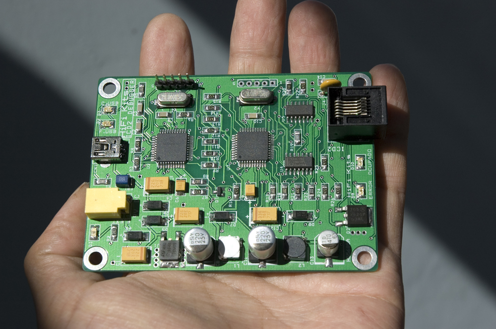

Hi Friends
Finally this is my ICD2 PCB, some ICs are in the bottom side...still testing for limitations, it works from low voltage as 2 .00 volts, tested with PIC16LF876, now no have problems for loss the firmware, it uses external power supply or USB power supply.
Thanks to all people who worked in this great project.....

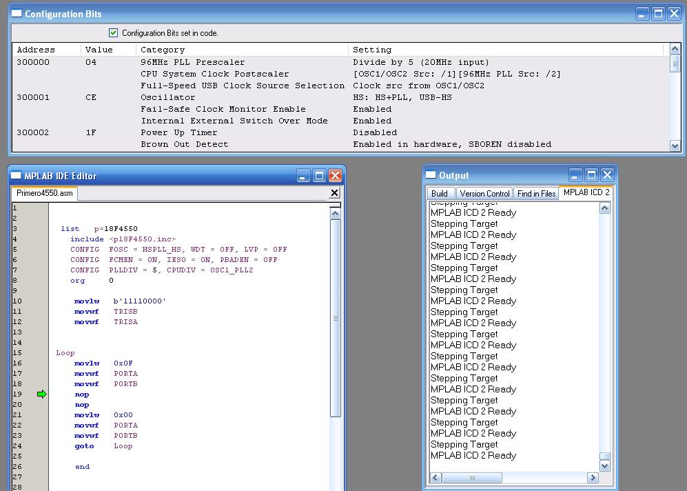

I am not very sure about the debugging part. I just build your Junebug. I have noticed an error in the schematic (+D and -D swapped according to standard USB type B connector pinout), I connected it anyway and of course it did not work. I quickly made a few measurements and finally decided to swap them. It works, can program etc. but won't enter into debug mode. This is testing with a 18F4550. So, my ICD clone and your Junebug are a pretty equal match if you ask me. If I program only and then release the target - all is well. Equal behaviour.
Done a quick test with a 16F877A too. Everything works, including debuging. I really don't get it. Tried with all kind of oscillators checked the debug ports to be enabled, the lot. No success.
Damn.:|
I am beggining to think what my problem is. Before you dive into this problem, let me point out that my Junebug is not entirely built to the specs. I use different transistors and a 100u inductor. The inductor should be bigger, but I really do not have anything else lying around. The ferrite bead is also missing, but that probably is no biggy. Electrolytes are off by 50%+ for the smps and 10x lower for the pic, but this again should pose no threat to the application. And ofcourse, I use 4550 in Junebug, yes, pins rerouted.
If it programs it should debug, you must have a running target PIC to use debug where programming does not require a clock on the target.
Thanks for the heads up about the schematic and USB+/- being reversed, (fortunately the PCB is correct) I'll update the manual ASAP.
The bead is optional and should not affect the Junebug, it's supposed to be there but my prototype was also built sans bead.
PS try to run the program in the now poorly named "Inchworm Quick Project" guide. It won't support the debugger but with a 16F877A target it should flash the LED (if it doesn't your 16F877A crystal isn't running, try lowering the caps to 18pf)
PPS the Junebug (and PICkit2) do not pull the target to 5V (the Inchworm & ICD2 do) so you must have a 22K resistor between MCLR & +5V on your 16F877A

Could you send or post your program what You want to debug, did You check fuses, wich error You see in MPLAB?, as Blueroomelectronics toll You, If you can program it mus debug.....I think the problem is in your software no in the harware...
Jose
OK, led blinky project. Just change the #include and add correct *.h and *.lkr files. Works for 18f458, 18F2455, but not for 18F4550. Try the last one.
Do not forget to configure the fuses! I do it in MPLAB, since I am new to the C18 compiler.

Your file looks corrupt.......
But
I have tested a small program with the ICD2, and it works ok, with PIC18F4550, as programmer or as debugger,
I turns on / off leds on portb0 to portb3 and porta0 to porta3, if you run, You will see all time on, but when you make debugger (animate), You will see ON/OFF the LEDs
Crystal 20 MHz

I would like to point out, that when setting fuses in MPLAB (say for a 4550 maybe?), that "Dedicated In-circuit Port (ICD/ICSP)" should be set to "Disabled" in order to enable debugging.
Both Junebug and PiCS ICD clone have been verified to work.
Jose should have seen my face. Anyway. I became suspisuous whn I read Jose's code and saw that he never opened the debug ports. But it worked. So I disabled them in my code and it worked.
