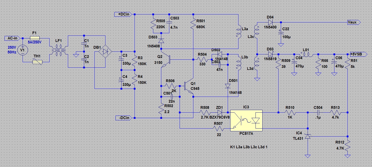

Sorry if this is a long post.
Overview:
I am working on a project where by I am rebuilding an existing working PC ATX power supply onto a new PCB so that the power supply can fit into the main unit of my overall project.
I have spent many days/weeks studying the existing circuit and drawing it in LTspice. I have also managed to find a schematic on the Web that is an exact match to the circuit I'm copying.
What I've Done so far:
I decided that rather than building the entire circuit first I would just build the input recifiers and the +5V standby circuits. As seen in the attached image. LTspice shows this diagram to work and produce voltages. As I didn't wind the transformer myself I have had to guess/Play with the figures for the inductance of the inductors. I attached a red LED and 330R resistor to the +5V circuit and a 12V 50mA fan to the Aux circuit.
First attempt:
The first time I applied power to the circuit the led glowed and the fan ran (all was looking good), shortly after this both transistors and a few resistors self destructed in smoke. After removing all the visiblly damaged parts I found that the resistor I had use for R502 was an 18K instead of the 2R2. I replaced both Transistors and all resistors and caps on the high voltage side.
Current State of play:
After trying the circuit again the transistors went up in smoke again. At this point I replaced all parts on the high voltage side except for the transformer, which I didn't make as it is the one from the original circuit. Now the circuit no longer produces any output voltage and the fuse and other parts are not going up in smoke.
My Question:
As there are some rather high voltages involed in this circuit I would like to know firstly what might be the root cause of my problem? Are there any ways to lower the input voltage to a safer level and still have a working circuit? Can I test smaller parts of the circuit? Like checking that the transistors are oscilating as expected to product the AC voltage required on the transformer, etc.

I've been looking at the circuit you posted, and trying to find anything that doesn't look quite right there.
There's three areas which I think might be worth checking:
The midpoint between C3 & C4 looks as if it should be connected to something (perhaps just a 0v reference).
I can't see where the standing collector current into the output transistor of IC3 comes from (perhaps there's a wrong connection around D501 or ZD1).
The resistor values on the base of Q2 seem to lead to the wrong currents (perhaps wrong values or wrong connections?).
It would be worth applying a lower voltage to DCin & DCout for testing that Q1 & Q2 are switching correctly. If you can watch their collectors on a storage 'scope you can check the relative timing and perhaps a clue to the fault?
I would recommend checking everything in the switching part of your circuit against the original - I'm not confident that it is correct and you shouldn't put yourself in danger testing a suspect high voltage circuit!
This will be the 0V reference for the main transformer when added later.

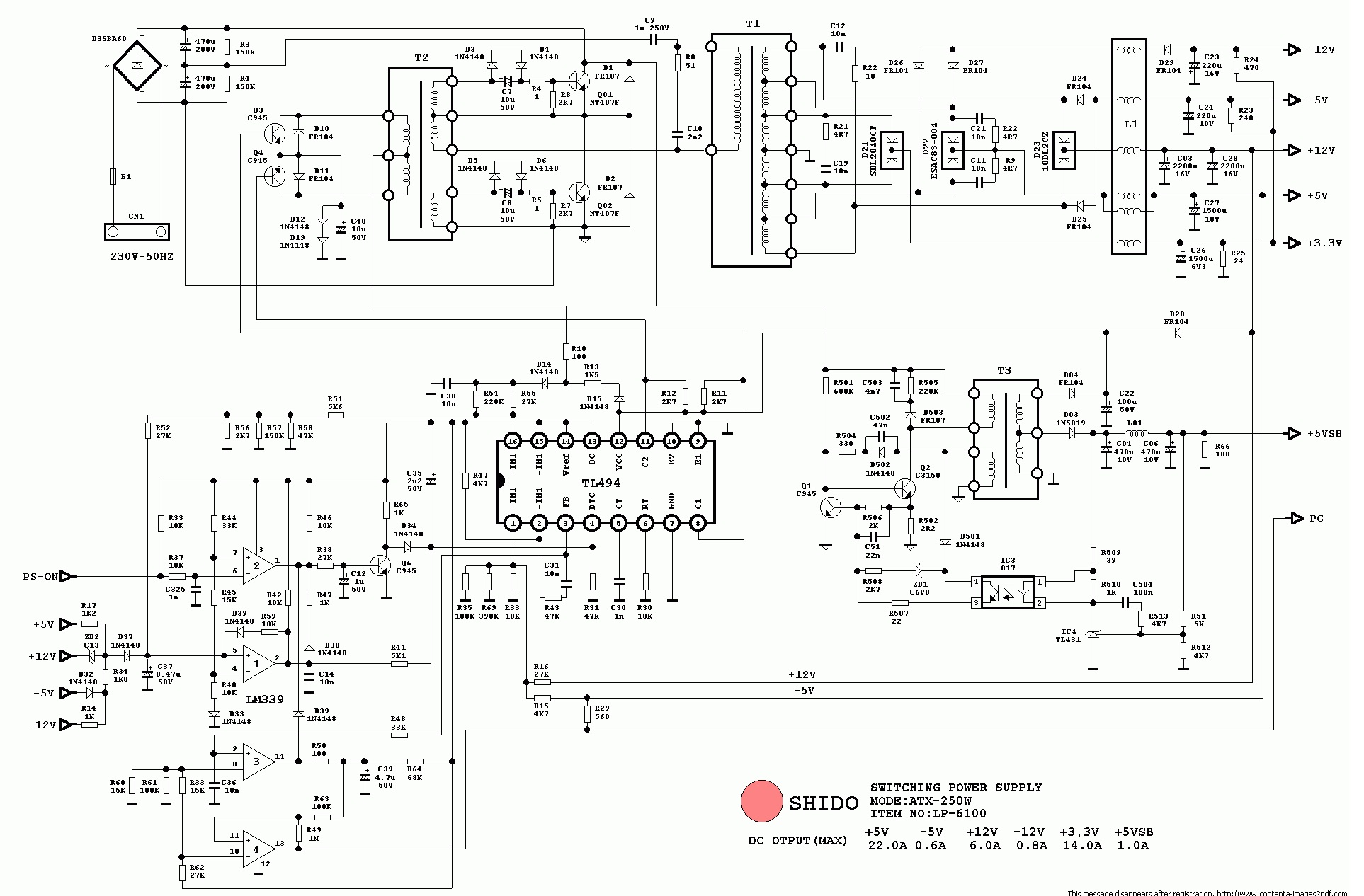

The schematic I have drawn matches the schematic I found on the net for the SHIDO ATX 250 watt power supply which I have also attached.

I would concur with E-design. The transformer may be perfect but if either L3a or L3b connections are reversed it will not oscillate. Try reversing ONE of them and see what happens, don't reverse them both !!
Brian.
I agree with E-design and betwitxt that if one of the windings L3a or L3b was cross-wired (out of phase), then it is very unlikely to oscillate.
However, after staring at the circuits for some time, I'm still struggling to see how it could work (If there is a circuit error then it is in the original 'Shido' schematic as well as in yours).
I'm still not convinced the currents around the bases of the 2 switching transistors can be correct, which is, of course, critical. Referring to the brief period when your circuit powered a fan and an LED, I wonder if that energy could have been transferred during just one, initial, switch-on pulse, and that there was not a period of full oscillations?
I am also still unhappy with the lack of current source for the optoisolator; although this wouldn't stop it oscillating (it affects the feedback loop of voltage control), it does suggest that there is a possible error in the drawing.
Finally, your schematic shows D03 as a zenner, though this will not be the cause the problem either - just an observation.
If a simple reversal of either of the winding terminals still doesn't fix the circuit, I wonder if you might benefit from re-checking against the original PCB tracks around the bases of the 2 transistors Q1 and Q2 and the collector of the opto IC3?
Good luck!
It should be possible to check that the circuit is at least oscillating by lowering the 680k bias resistor to say 68k and test the circuit on a lower voltage lab supply (~30VDC) with current limit.
Then at least you can look at some waveforms without everything going up in smoke in a split second.
If you can't do that put a small wattage (around 5-10W) bulb rated at mains voltage in series with the DC supply to the switcher. The cold resistance of the bulb will allow the circuit to operate under very light loads while the hot resistance of the element will limit current to protect the circuit under fault conditions. Old trick used by TV repair guys to help fault find switching supplies.
Operation:
At the moment of applied DC initial turn on of Q2 is via R501 (680k). With Q2 turning on we get regenerative feedback via winding L3b. In other words as the dot end of L3a is pulled down through Q2, the non-dot end of L3b will move more positive providing more drive to Q2 base through D502, C502 and R504. This will cause Q2 to turn on quickly. Because of this current, the voltage over R502 will increase. When this voltage is enough (around 0.6 to 0.7V), Q1 will start to turn on and divert base current away from Q2. With base current being robbed from Q2, it will start to turn off. This will cause the collector voltage of Q2 to go up. Due to classic flyback action all winding voltages reverse and L3b will aid in turning off Q2 through C502 and R504 at this time. The maximum current flow is limited by R502 and turn on b-e voltage of Q1 (Imax = Vbe/R502). The feedback circuit through IC3 will help turn on Q1 and hence turn off Q2 sooner to establish voltage regulation action on the +5VSB line.
I will retrace the original PCB circuit and check If I have the transformer pins connected correctly.
The fan and led both worked for about 20-30 seconds before the transistors went up in smoke that first time. Would this not have been longer than what the initial switch-on pulse could provide? If so then this may indicate that the transformer is connected correctly, I'll still check it to confirm.
D03 is a 1N5819 which is a 40V, 1A Schottky diode.
I will re-check the entire pcb, although the circuit is 99.9% identical to the SHIDO schematic other than a couple of component values, So far the only difference are the orignial circuit use 4.7 ohm for R502 and a 220 ohm for R507, I have tried these as well and the circuit still doesn't work.
I will try this after re-checking the intire circuit against the original.
I think I might try this as well after the using the LAB supply method.
Operation:

I understood, that you are referring to post #1 (single ended, self-oscillating) and #5 (push-pull, PWM controller driven)? There aren't much similarities in my opinion.
Post #1 contains the portion of the circuit from post #5, mainly the 5VSB and Aux power circuit used to power the main PWM. This is the section that I have built and am trying to get working. The entire circuit which I haven't yet supplied here is still a 99.9% match other than the odd component value that is different.

The C945 reads e-c-b and the 3904 e-b-c so make sure you get it connected correctly.
I was aware the pinouts where different and had updated my footprints to allow for the difference. The mistake I made was when I read the datasheet I misunderstood which way up the pins where viewed from. I read it as c-b-e instead of the correct e-b-c, hence why the 180 degree rotatiion of the device should fix the problem for this PCB. I'll have to update my footprint again before building the next board.
Kenneth
Hi Guys'
After rotating the 2N3904 180 degrees and re-testing the circuit with a 30V DC rail. I found that the circuit was still not working. This suprised me so I though I'd that a look at the transformer as it's about the only part that hasn't be replaced. To my disapointment I have found the one leg of the primrary coil has desolved the wire from the leg into the main coil bundle, all other windings appear fine, No short circuits.
So it look's like that's the end of the transformer. Is there any way I could repair this? for example, could I unwind one turn of that wire or joint another piece of wire to it so tha I can re-join it to the leg, I think I would have to at least unwind on winding to allow me to make any form of repair.
