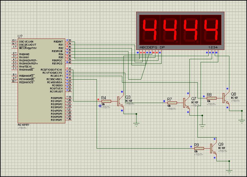

when i used the one that u said, it shows on 4 segments 1111,2222,3333,4444. while rc1,rc2,rc3 are OFF
Change this part to this:
do{
   for(i=0;i<4;i++){
   PORTC = 0 ;////This is the port which has the common cathodes connected to it via transistor
   PORTb = mask(disp[i]); ///////'This is the data port
   //PORTC.f(i) = 1; ////////////////'RC0 = 1st display, RC3 = 4th display
   PORTC| = (1<<i);//
   delay_ms(10); /////////////'Delay between successive changing. If other stuff are to be done during this time, use timer for delay
}while(1);
Hope this helps.

no wait
i changed the delay_ms(10)to delay_ms(1000)
now rc0 and rc1 and rc2 and rc3 are working sequentially but all segments are working 1111.2222.3333.4444

you used invertor in your simulation?could you tell me the number of that.
thanks
Type in inverter. On the left hand category selection, click modeling primitives, choose inverter.
Inverter wouldn't affect it as transistor in your circuit acts in the same way. It will work with transistor.
Hope this helps.
Tahmid.
---------- Post added at 19:54 ---------- Previous post was at 19:52 ----------
O, ok, I see. That's a simulation bug thing. Connect 2k2 resistors from each of pins 1, 2, 3 and 4 to +5v. That should do it.

hey man thanks a lot.i tried with inverter it works (on single seven segment) but it is not stable i try by changing the delay to make it stable.thanks so much.could you tell me why you used inverter?
I just did to simplify simulation. In real life, the delay_ms() function, the delay should be around 10. In simulation however at 10, it may or may not be stable. In real life, you have to use transistors to carry the current.
It works with transistor as well. See above post.
Hope this helps.
Tahmid.
sorry i wasted your time,last question could you explain this: PORTC |= (1<<i);

it is funny now i did the simulation without resistors on 1,2,3 and 4.it works::))

PORTC|=(1<<i);
Okay,
<< means bit shift left.
1<<i means shift 1 i no. of bits to the left.
That means, when i is 5, 1 is shifted to bit 5, so that bit 5 = 1.
PORTC = (1<<i); would mean that.
PORTC|=(1<<i); means PORTC = PORTC or (1<<i);
That means had PORTC held some value, it would retain the value for all pins except bit 5 which would be 1.
Here, it's not so important as we clear PORTC at start.
So, here either PORTC = (1<<i); or PORTC|=(1<<i); would work in the same manner.
Hope this helps.
Tahmid.
---------- Post added at 20:12 ---------- Previous post was at 20:11 ----------
If it worked without resistor, good. In real life, you won't need those.
