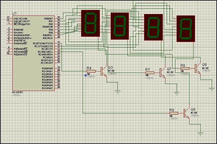

hi
i want to connect 8 seven segments to pic 16F877 so i want to use 74HC595 IC, but unfortunately i dont have the code in C (MikroC) language.
or any other way that i can connect 8 seven segment to pic.(each seven segment should count down different number, so NO multiplexing method)
Does any one have the code?
please
Thanks in advance.

sorry i made a mistake,4 seven segment.if possible for you to give me the code,i really thank you man.
I am working on adaptive traffic light control system in this semester
BTW thanks for reply.
I'll help with the code. Even for 4 seven segments you need to have them multiplexed.
how can i multiplex 4 seven segment?
each seven segment should be on, and counts down different number for traffic in each road.
sorry this my first project with pic and i do not know so much about different way.
i have 12 input from sensors, 12 output for red,green and yellow,so only afew pins left.:-(

i can not use this code in mikroC it gives error; PORTC.temp = 1
in mikroC we write portc.f0=1; or portc.f1=1; means RC0 and RC1 are high

I tried this code, but only one seven segment works.it shows on one seven segment 1,2,3,4

i changed the delay to 10, it shows only number 4.
---------- Post added at 19:17 ---------- Previous post was at 19:15 ----------
i think most of problem is with this part,because this command enables the seven segments.(PORTB |= (1<<temp);)
Can you see the outputs from RC0 to RC3 changing values, ie going from 0 to 1 to 0?
---------- Post added at 19:22 ---------- Previous post was at 19:20 ----------
Instead of 4 7-segments as shown in the circuit, just use a multiplexed one for simulation purposes. Type in 7SEG-MPX4-CC. This would make the wiring much easier.
