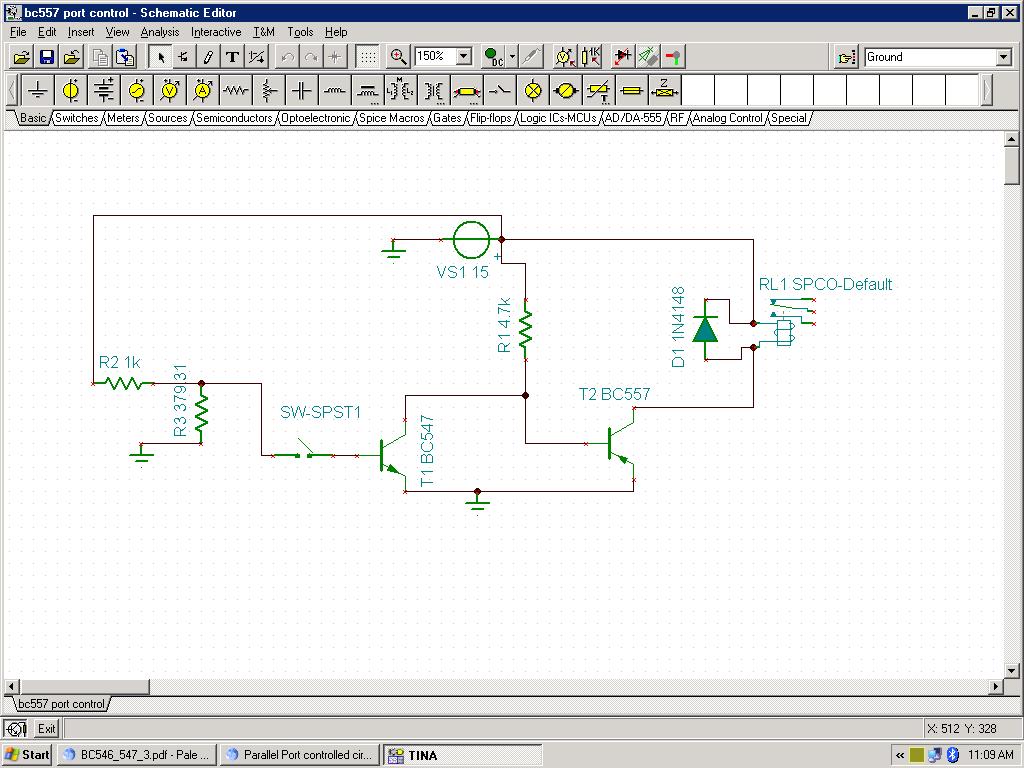

Working circuit made
I finally made a working circuit....
A big thanks to Mr.davenn for posting the circuit...
Also thanks to kerimf and fvm for actively helping me out...
thank you all for banging you heads for me..
Even if the original circuit didn't work but i learnt a lot from you all... I never knew so many things about working of transistor...so many calculations..
I made a small change in his circuit..
I used a one bc547 transistor and a bc557 transistor...
I simulated the circuit in TINA circuit simulator and it worked..
then I finally made the physical circuit and now the relay switches on as well as switches off as per the commands given through the software.
Re: Working circuit made
To be honest, I won't build, in order to control a relay by a data pin of the parallel port, the circuit 'exactly' as you have just posted.
But if it is okay for you then there is nothing to add I guess :smile:
Kerim
PS: at least, exchanging the connections of the BC557 emitter and collector will give a better result (collector to ground).

yes besh mohandes, there a lot number of ways of professionally doing it... using buffers, transistors arrays and what not..but this ok for me as i have some old electronics lying around for reuse..
If i ever need this type of interface in some serious application.. i will use something else..but this taught me good things..
and yes, you are right about that bc557 conn. exchange, i am not sure but does it provide lesser resistance?
thank you
If collector is at ground, the transistor current gain should be higher hence the Vec saturation voltage will be smaller.
You can verify what I said by simply measuring Vec of BC557 in both configurations in the real circuit ;)
