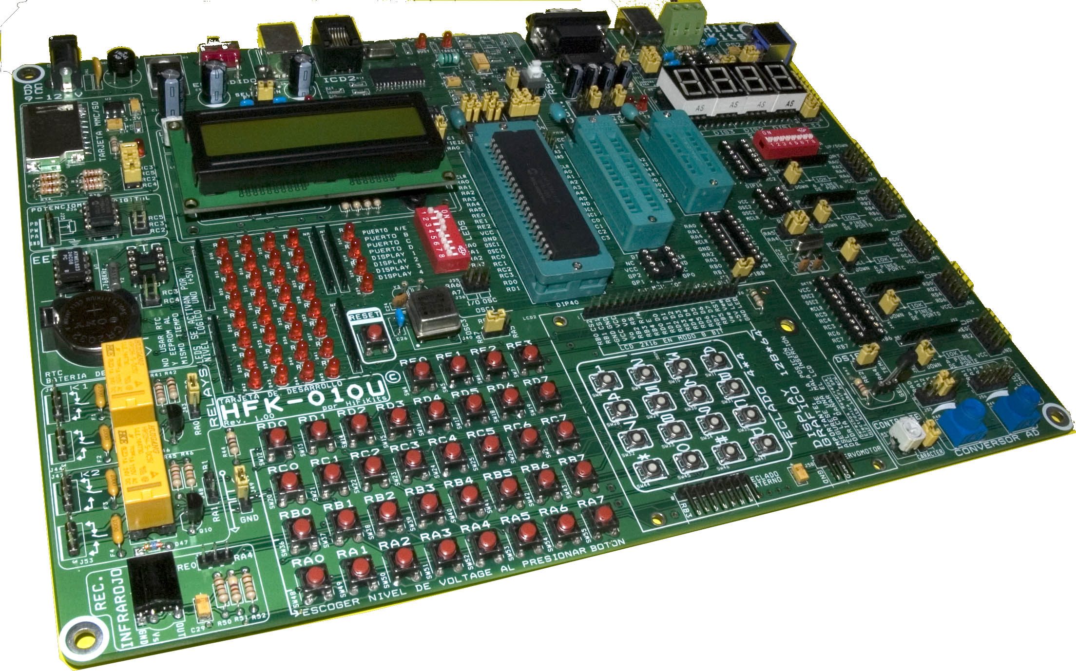

HI Friends
What Do you think about our development board?
It works wit USB programmer compatible with PICKIT2, and of course can program with MPLAB, support too ICD2 external debugger, have on board most usual periferic, and ZIF zocket for most popular PIC microcontroller, and You can chose work with LCD or DISPLAY with PORTB or PORTD, include on board KEYBOARD 4*4 or can use GLCD too, TSOP1738, RELAYS, RTC, DIGITAL POT., MMC/SD CARD, RS232, USB, RS485, ANALOG INP., LEDS, SERIAL EEPROM AND ANOTHER FEATURES MORE .....
OF COURSE HAVE ACCES TO ALL PORTS
JOSE
Re: easypic4
Jose Fausto,
It is quite a board, though at first it looks very similar to mE easyPIC4 dev board. Do you sell these?
Re: easypic4
WE ARE JUST FINISHING WITH MANUALS AND SAMPLES PROGRAMS, of course later we will produce for sell as complete assembly.
Jose
