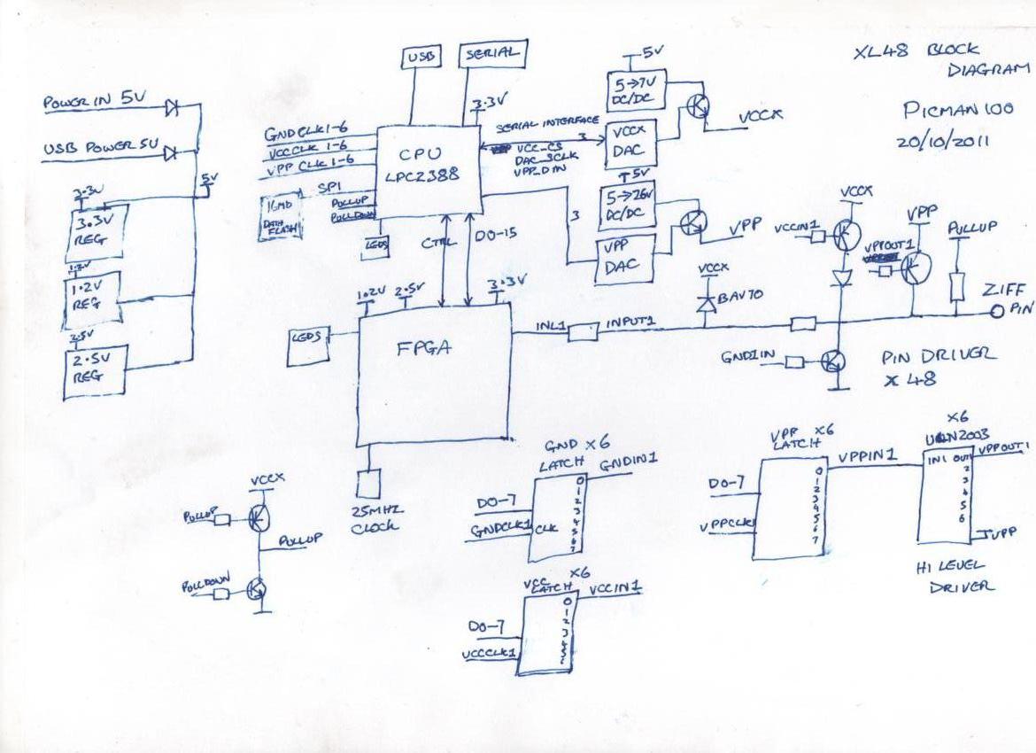

New Schematics
View attachment programmer.pdf
Changes:
DAC controlled PSU for VCCX
DAC controlled PSU for VPP
Ethernet and SDCARD removed.
Smartcard Removed.
LEDs added for status on ARM
LEDs added for status on FPGA.
This should make the programmer cheaper but still function the same.
Take a look at the schematics and tell me what you think.

My idea, please refer to
Rough block diagram of programmer.

I have taken the LCD and SD card off the schematic because of cost, if you want i can put them back on but there is a lot of firmware code to use the SD card and i never use it on the development board i have here.. Also i use the serial port for debugging, not the LCD..
