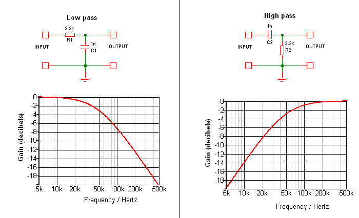

Don't let the terminology confuse you, it's actually pretty simple. Here's a couple of simple RC filters, a low pass and a high pass, with their responses:
In both cases we say there's a pole at 50KHz, because that's the frequency above (or below) which the gain rolls down. When the response curves the other way (upwards), it's called a zero.

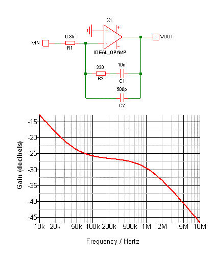

Which brings me to the main point I'm missing: How to find out where those added poles are? For example, how did you calculated the added pole due to Cgd?
The filter below has the same response as the MOSFET gain stage with the values I suggested: 330R and 10nF, with Cdg = 500pF.
There's a pole at 1MHz from 330R and 500pF, and a zero at 50KHz from 330R and (10nF + 500pF).

Assuming Cgd is 500pF (which can be seen by looking at the IRF3205's datasheet; look in Fig.5 at the plot for Crss—this is Cgd, the MOSFET's internal capacitance from gate to drain), the added pole occurs at 1/(2*pi*330Ω*500pF)=1MHz. Remembering the series RC we considered earlier, but replacing R=330Ω and C=10nF, we now place a capacitor in parallel to these of value 500pF. The impedance of this combo is very high at low frequencies and decreases until it reaches 50kHz, at which point it levels off at 330Ω, and then above 1MHz it falls again.
You can visualize this easily using LTspice. Here's a graph of the impedance, and the circuit that produced it:
I'm feeding the network a current of amplitude 1, so the voltage across the network represents its impedance (V=IZ; for I=1, V=Z). As you can see, with Cgd absent the impedance remains resistive at high frequencies (red), which was the intended operation. However, with the large Cgd introduced, the impedance becomes capacitive again above ~1MHz (orange), which brings the phase down and causes instability if the unity gain frequency occurs above it.
Looking at the orange graph, we notice three distinct regions. Starting from the left the impedance is falling, indicating a capacitive impedance (since for a capacitor, Z=1/sC). The fall is at 20dB/dec, which also indicates a single-pole rolloff (the pole occurred at zero frequency). Whenever you have a pole, it is accompanied by a falling gain—20dB/dec per pole. At 50kHz a zero is introduced by the resistor. If there weren't any poles, the zero would actually cause a 20dB/dec rise, but since there was already a pole it simply cancels out the fall, resulting in a level region above 50kHz. At 1MHz a second pole occurs, causing the impedance to fall again.
Doing the math explicitly, we have a parallel combination of (1/sCgd) // (R+1/sC). This translates to:

One thing to notice is that for the second pole at ω=1/(C//Cgd)R, C»Cgd (10nF»500pF). In "parallel" combinations, the smaller value dominates, so we can approximate the pole frequency to ω=1/CgdR. This is in line with what was stated earlier, indicating that we didn't actually need to do all this math, although it's useful for building our confidence.
Stepping back for a bit, this all comes into play by affecting the MOSFET's gain. Its voltage gain in this configuration is (again, approximately) Zfeedback/Zdrive. Since Zdrive is a resistor of 6.8kΩ, this stage behaves as an integrator below 50kHz, transitions to an amplifier of gain 0.05, and then behaves like an integrator again above 1MHz. The gain curve will roughly follow the feedback impedance curve. The new R and C value don't guarantee stability when you add fifty more MOSFETs on, but it should have good margin with one.
