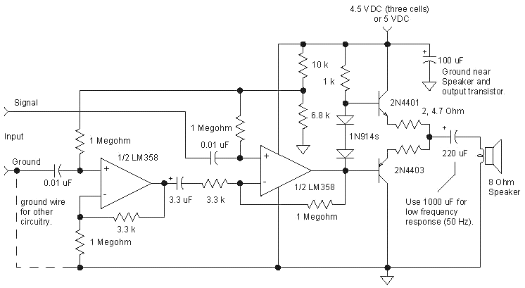

I found this tutorial which is a much more helpful in a practical sense: https://www.societyofrobots.com/robotforum/index.php?topic=9840.0
In it they have an ac coupled amplifier with a resistor to ground either side of the input capacitor.
I think I can see why. Because the audio signal either side of the capacitor is relative to different grounds - the, for example, ipod ground on one side and the opamp GND on the other. And they may or may not match exactly.
But surely that would not specifically result in the the positive side of the audio signal being cut off entirely and the negative side of the audio signal being amplified as expected? If the GNDs are different then I can see no logical reason why the negative part of the signal wouldn't also be distorted in some way.
This highly specific gross clipping in multisim must still be just a very confusing artefact of its failure to more closely match reality?
That circuit has a 1M resistor from the non-inverting inputs to a voltage generated by the 10k/6.8k divider. That is because it is running from a single supply so to amplify AC signals you need to set your virtual earth point above 0V.
Keith.
