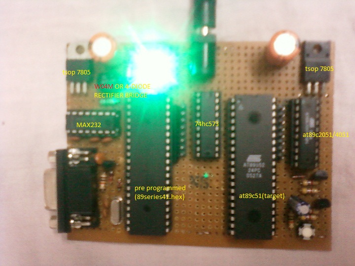

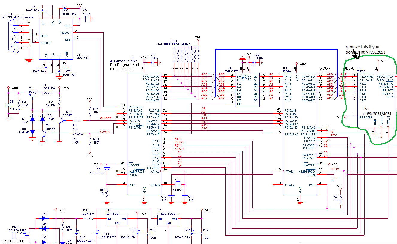

hey tushki, there is another problem..the picture of the circuit made by you do not contain as many components as shown in the circuit send by you,it seems as if you have omited some extra part of the circuit for simplicity,can you please send the edited circuit diagram??

No i had not removed any part.. can you please tell me what is missing ?? There are all 5 ic's, and i can tell you if you only want to program at89c51 then you can remove u5 and all corresponding lines to it... see image :
And here is the same programmer by me I HAVE EDITED IT TAKE A LOOK(ALL MAIN THINGS ARE THERE) :
Sorry here is the final image(at top corners they are voltage regulators 7805 Not tsop) : 2 at89 series programmer edited.jpg
in the section of circuit where there are 3 transistors and 2 zener diodes..where are they in ur pcb?
I suggest you to make your own pcb, looking at only a picture of mine programmer wont make any sense(unless it is circuit).. everything is complete and it is working(i have not removed any part)
Take a look: 3 at89 series programmer edited.jpg
Good Luck..
