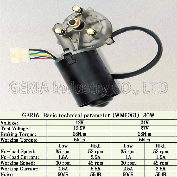

just a reference for the wiper motors :
they have very low speed.
