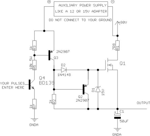

As I understand, in circuit number 2 of these series (please see attachment) the only reform is change the 2N3904 by a BD139, the gnd connection is the gnd of the 5V that I already have, and between this gnd and the base of the BD139 I switch on the circuit with a 5V level, the VGH is connected to the + terminal of a 20V supply, whose – terminal is connected to the +83Vcc of my Spark power supply, and these are all the connections between the 20 V source and the circuit. It’s ok?

If I didn´t make any mistake your driver should look like this. You can use 2 MOSFETS in parallel if you want (just connect the source and the drain in parallel and add a 10Ω resistor to each gate).
Added after 3 minutes:
You can remove (short circuit) R5 if you want but in this case you´ll have to place a small heat-sink on the BD139.

The auxilarx supply circuit has the basic advantage of low voltage drop, thus the MOSFET power dissipation is reduced and the capacitor can be charged up to the supply voltage.
But it's not fully O.K. as shown. A current limiting for Q3 collector current either by a resistor or by turning Q3 into a current source is needed.
If you change the places of R1 and Q1 (together with the connected gate circuit), Q1 source would be stay at V+ level during on state except for a short transition.

Thank you FvM. I was not affraid about limiting inrush currents. I just copied the circuit as it was with a few modifications. I´m not doing the project, just trying to help. The drain current is already limited by the 7R8 resistor and I thought that limiting the gate current would be of no help. Furthermore, as the original author of the circuit (I suppose) also thinks, Q3 can´t source such a large current that the MOSFET can be damaged. In any case, placing a small resistor in series with the gate is a good suggestion (and Luis, please take it into account because some small problems may not be apparent during development but may cause serious problems during the lifetime of a product).
Power Mosfet driver
I rather feared Q3 to be damaged. Also Q3 must have 100V voltage rating, 2N2907 isn't good for.
