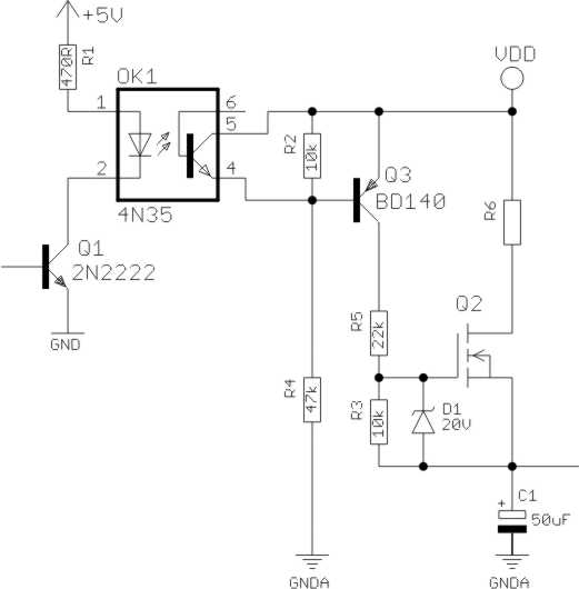

I have the following circuit: it’s a relaxation oscillator: R charges C (when mosfet is in saturation state) and when the C arrives to its maximum threshold voltage (83 v approximately), I must open the mosfet to start with the C discharge, but isolating the R, because I need to cut off this part of the circuit.
I try to open the mosfet giving a “1” to the base of 2N2222 transistor, so the opto-isolator led switch on its transistor (in fact I can’t realize this, I obtain a VSAT to high, nearly the value of the supply), closing the C-E junction of the BC639 and open the Mosfet.
All this would be the ideal that I pretend to happen, but I don’t realize my purpose, because the mosfet always conducts.
I attached the circuit sketch.

What about a circuit like this?
Added after 3 minutes:
Diode D1 can still conduct some current but I believe you can easily modify the circuit to deal with this problem.

You don't mention the part number of the optoisolator, so I can't give a definitive answer. However, It's possible that the output transistor of the optoisolator can not supply enough current through the 2.2K resistor to bring the base voltage high enough for the 2N2222 to conduct, and turn the FET off. You might try increasing the value of the 2.2K resistor.

In the original circuit, the MOSFET is immediately damaged by the high negative Vgs, it can't work this way. pauloynski's suggested circuit is basically O.K. regarding charging action. But as the original circuit, it can't discharge the capacitor, it's even keeping a constant charge current through R2. It also can't charge the capacitor up to the full supply voltage.

Switching the transistor on put's the full capacitor voltage as Vgs.
I think, it will be very difficult to produce sparks at 80V only.

Thanks Luis. I know how it works. I´ve connected the gate resistor directly to Vcc because the MOSFET needs a Vgs voltage of about 3 to 5 volts to conduct. If you connect this resistor to the drain, the MOSFET will hardly go into saturation. If your repetition rate is low this is not a problem. Also, the circuit I´ve proposed shows a small residual current when cut off. This current flows to the output capacitor through the gate resistor and the zenner diode. This diode was placed to protect the gate because the Vgs voltage can´t rise more than 20 or 30V (please take a look at the MOSFET specs), otherwise it can be destroyed. You can increase the value of this resistor to some extent to decrease the residual current.
Added after 1 hours 53 minutes:
This circuit shows no residual current. Please size resistors according to their power dissipation. You will note that this circuit inverts the logic of the original one: when Q1 is conducting it cuts off the output current. You can deal with this by simply removing Q1 from the circuit provided you have current enough to drive the optocoupler directly. You can increase the value of R1 to 2k2 if you have trouble in driving it.

Also, can I set in the place of your Q2 a parallel arrange of 2 Mosfets IRFP260 joining its S and D, and placing in its gates 10 ohms resistors, and then putting together the opposite leads of the resistors to the signal? Is good this value of resistors and the types of Mosfets?

Hi Luis: low capacitance electrolytics may show an ESR in the order of a few tens of ohms, that´s why they heat. The ESR differs from brand to brand and normally increases a lot during lifetime. That´s where you can go into trouble. If you can´t get low ESR ones you can try adding some non electrolytic ones in parallel with your´s to decrease ESR (not a really good solution but may help). Almost any other type will do the job. At the high capacitance end I would like suggesting your using a few electrolytic capacitors in parallel. This will help you conducting large amounts of current through many cables instead of a single one.

I think, in electro erosion applications, it doesn't help to use smaller low ESR capacitors in parallel. Cause the total capacitance is discharged during the pulse, the main (electrolytic) capacitors ESR still determines the losses and achievable pulse current.
As far as I understand the technique, a high current is decisive for erosion effectivity. I read about metal evaporation at 20000 to 30000 K. Or in an energy flow view, a higher ESR means that a smaller part of the stored capacitor energy is utilized for the erosion process.
On the other hand, film capacitors in 100 up to 1000 and more uF range are available for power electronics applications. They are rather bulky and more expensive than electrolytic types. Unfortunately, it's also no guaranteed, that they can endure the pulse currents in electro erosion applications in any case, just because they achieve considerably higher currents than electrolytic types. But it would be possibly to limit the peak discharge current to safe amounts by inductors.
I don't know the state-of-the-art with industrial electro erosion systems, but I would expect film capcitors and current limiting inductors, if necessary.

To quickly turn on a MOSFET you need to source a large current to the gate in order to charge its capacitance. After it is charged almost no more current is needed. The circuit you´ve proposed does it through a 4k7 resistor conneted to the drain (or the 80V supply) which will source only a fraction of the required current. This means it will not reach the lowest Rdon for a while and that is a bad condition since the MOSFET will heat and will not charge the output capacitor as fast as you need. The time to charge the output capacitor will also be dependent on the value of the series resistor connected to the drain. In order to start with any calculation you must define the repetition rate you want to recharge it. In your circuit, placing a 10Ω resistor in series with the gates makes no sense since there is a much larger resistor (4k7) in series with them. In my opinion this is not a good solution. You can try using a more powerfull MOSFET (may be with lower Vds, 150 or 120V seems to be enough if there is no inductive load) or a high side gate driver like **broken link removed** Also, as you increase the charging rate so does the heat on the output capacitors.

change the mosfet to a logic level type and drive it directly from VCC instead.

I didn't yet care about the involved MOSFET type and possible need for more current or power capacity. A parallel circuit isn't a problem. Your gate circuit is rather high impedance, so the individual gate resistors also aren't critical and can have any value between 10 and 100 ohms.
I understand that the circuit is based on using a charging resistor and operate the FET as a switch. The minimum voltage drop of Vgs,on is a serious disadvantage of all discussed circuit variants. Using logic-level MOSFET can reduce but not remove it. Unfortunately, it also limits the choice of suitable devices.
A more general solution would be one of this:
- a PMOS-FET
- a gate circuit utilizing bootstrap
- an isolated gate driver supply respectively an auxilary voltage stacked upon V+. Cause the input voltage supply is AC with a bridge rectifier, there are quite simple voltage doubling circuits available (2 diodes + 2 small capacitors).
P.S.: A switched mode buck converter with constant current output would be an optimal solution to my opinion. The charge current could be easily programmed in this case.
