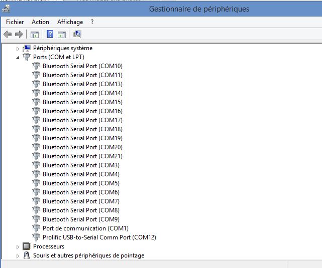

when i plug my USB/RS232 converter on my PC (i use WIN8) i get an additional COM12 = Prolific driver
