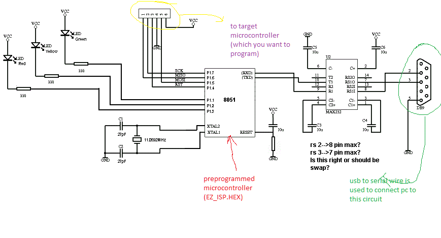

hi tushki7 i had try to make "EZ_ISP" the programmer is not working always giving message "try to connecting COM1" i don't know why??I have checked all connection they all are fine!!!
so i gone a try to make this one:
but I want to confirm weather can i use the IC 89s51 instead of AT89C2051??can you help me plz :???:

How are you connecting your programmer circuit with computer?? Are you using usb to serial??
Second thing the ezp needs one pre programmed microcontroller which contains firmware hex .. This pre programmed microcontroller will burn your target micocontroller..
Look at picture : EZ_ISP2.gif
And yes you can use at89s51/52... but i dont think the problem is with circuit.. there must be some communication problem in between your computer and micrcocontroller..
No I just use the serial cable.
Yes I have done the same thing i.e burn the firmware in a Master controller through parallel programmer.
I have doubt about the connection between Max-232 and Rs232
K
Oh yes, i am sorry.. I did not checked that part.. They need to be swaped or you can use 2-14,3-13 ..
Check your max 232 , check that it is properly grounded, check all ground connections (to microcontroller, max232, db9 connector.. Also check if your serial wire is working fine by using any serial terminal software(connect its 2-3 pin and echo some character..
Check that microcontroller has correct firmware and it is working.
Try this -»» When you connect your circuit with computer and run the ez burning software try reseting your microcontroller by switching off the supply.. Or switch off the circuit supply and run the software then when it is serching for it switch the supply.
