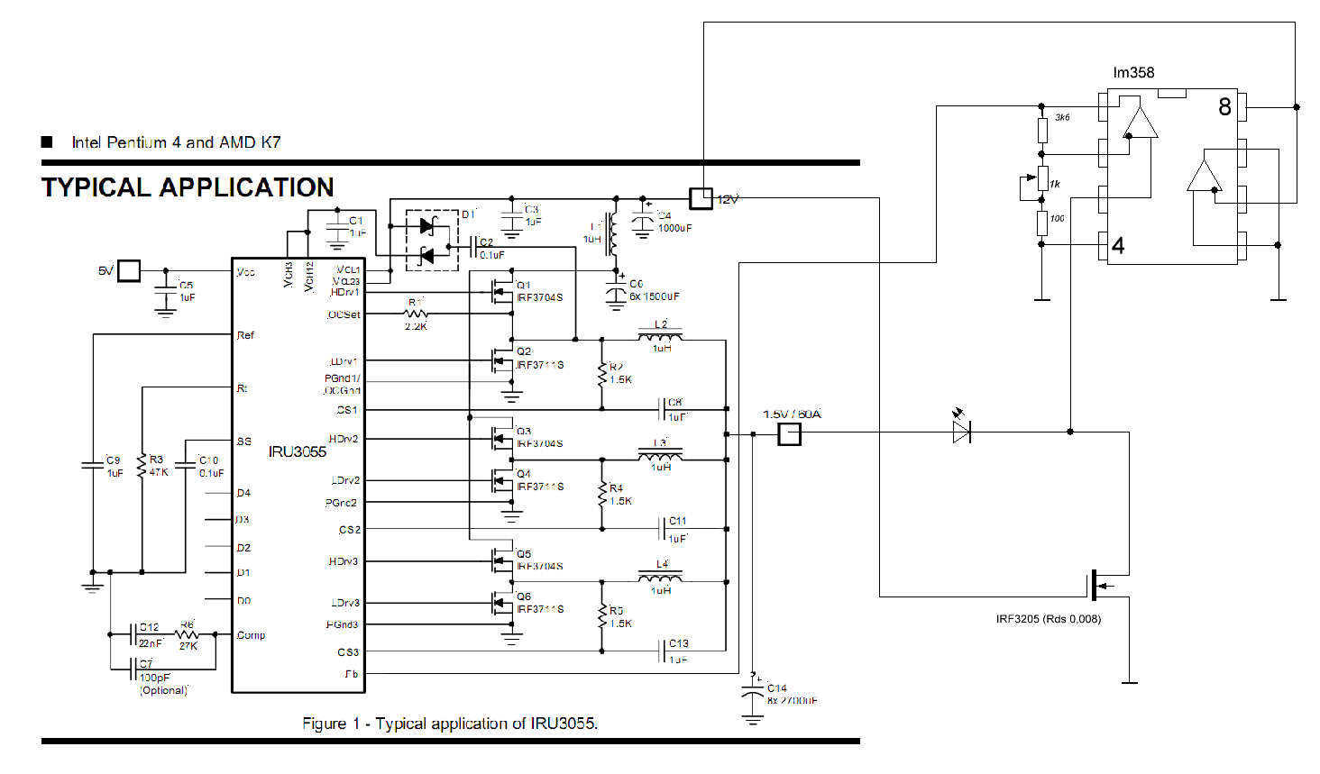

I need 1.3 V.
i think the focus should be on how to manage and control the current, and not this voltage. i might be wrong, but this laser diode must behave similar to any other LED diode which has a specified nominal forward voltage drop ( 1.3v in your case), and a rated max current ( 60A ).
so like any other diode, we have to ensure that the current stays below 60A. The voltage will manage itself.
however the main challenge is to create such a current source which is realistic. For example even a 0.033 ohm resistor in series with only a 3.3v source would need to dissipate approx 130watts
( 3.3v - 1.3v) / 0.033 = ~60 amps.
Or a 0.05ohm resistor in series would allow ~40 amps, and dissipate 80 watts. This could be created using 20x 1ohm/ 5watt resistors in parallel. but it is not neat solution, and less than even 50% efficient
best thing is to use current regulation using very low Rds mosfets. but focus must be on current control, and not voltage matching.
also your experiment with LTC3738 and 0.2 ohms which smoked. i assume you set the VID for 1.3v across 0.2 ohm. did you use a 10w resistor ? less than 10w you will see smoke of course.
I set 1.3 V. and I plugged 4 10W resistors in parallel (result 0.2 ohm). Smoke was from transistors.

Okay now I have to wonder what your layout looked like if you had room to plug in four 10W resistors on each phase... I also have to wonder how you got 10A out of such a circuit in the first place. The LTC3738 has a max current sense threshold of about 75mV, so with Rsense=0.2ohm it should never allow more than 375mA per phase, or about 1A total out. I think there must have been something very wrong with how you set up the controller...
If you want to go the SMPS route, I would recommend finding a controller similar to the LTC3738 (polyphase buck converter), but not one specialized for controlling CPU power supplies or anything. Having such specialized controllers is usually just trouble for people like you who want to use it for a completely different purpose. You'd be better off with a general purpose polyphase controller, like the LTC3829. You will still need to modify its control scheme in order to force it to regulate current, rather than voltage. This will require some external circuitry: use a shunt resistor to sense current through the diode, and connect that to an external error amplifier. The reference to the error amp will also be external, which will allow easy adjustment of the current setpoint. The output of the error amplifier can drive the Ith pin directly, thus implementing a current-mode current regulator.

well i was thinking as i went along. but here's a basic and standard circuit
your laser can be connected between the mosfet source and the sense resistor.
the sense resistor needs to be selected - say 0.01 ohms/ >50watts. Then the preset on opamp input can be set for 0.5v
Vpower on mosfet drain can be 3.3v. Then dissipation on mosfet will be ( 3.3v - 1.3v - 0.5v) x 50A ~ 75watts
actually not better than just having just resistor in series, but at least there is some control on the current with poetntiometer.
switched design of better efficiency i do not know how to do, sorry

Rsense - what do You mean by Rsense ? If You look on circuit in LTC3738 datasheet (page 30), You can see Sense 1 - 3 and resistors. In this point I have the same like in datasheet - 0.002 ohm.
4 10W resistors in parallel (result 0.2 ohm) - I plugged to output from all circuit.
it is not clear what you did here.
0.002 ohm vs 0.2 ohm ? 4 resistors in parallel to give 0.2 ohm means you used 0.8 ohm resistors ? this is non-standard value. please explain further ??

Picture shows what I did. I used 0,124 ohm - sorry for my mistake (4 x 0,5 ohm 10 w in parallel).
Ok you were referring to the load resistance, rather than the current sense resistors.
So if you blew a FET, did you try and find out why? Was it an immediate failure on startup, or did some parts gradually exceed there temperature limits? Did the circuit work well at lower currents?
There are many possible reasons for the failure. Poor layout, insufficient device ratings or heatsinking, bad solder joints, etc. Do you have a picture of the circuit under test?
So,I was checking current on multimeter. First, I was loading current about 5 A and testing about 2-3 minutes- was ok (but coils were very hot). Next I increase current to about 10 A, after 5-10 seconds I was feeling smoke.
I'm thinking why, datasheet say: up to 65 A, I had 10, so this is 17 %.

so you are saying the inductors burned, and not the mosfet ? and these inductors are rated for 65A or is mosfet rated for 65A ? what freq are you using ?
also, are you using all 3 phases or just one phase ?
I think that mosfet burned. Inductors were hot. I used 3 phases.
Schemat is in attachment (In schemat are symbols of inductors and mosfets).Printing Drukuj schemat-page-001.jpg
Schematic is the same like in datasheet. Only difference is between some elements - I can't find the same like in original, so I found replacement.
