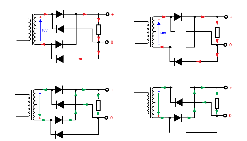

1:
Please have a look here: https://img17.imageshack.us/img17/224/img0001ea.jpg
You can also see my questions there. I was expecting to get peak voltage of: 60V * 1.41 = 84.9V minus the voltage drop across the LED. Do you understand my question? Please help me. Thank you.

1:
Look at the situation as the positive swing.
As you can see the current flow from point A to load and back to B
So the load is connect directly between points A and B. And voltage across the load Vab must be equal 30V.
The load is connect between the upper part of the secondary winding coil.
And we have very similarly situation for negative swing, but now the load is connect between lower part of the secondary winding.
So the voltage across the load must be equal the voltage of the lower part of the secondary winding coil.
And this voltage is equal to 30V.
To get 60V across the load you need to add two extra diodes and disconnect point B.
So we end up with this schema
AS you can see we need to use the bridge rectifier to get 60V across the load.

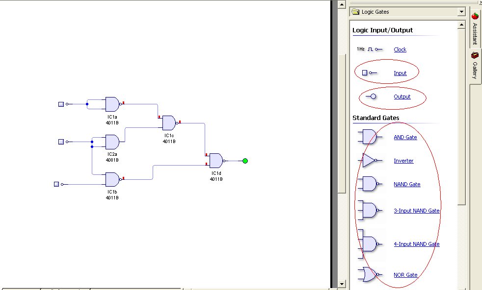

As it is apparent from the reading of this thread that I have MultiSim and Circuit Wizard programs. They both let you use gates in electric circuits as Jony told me in his latest post in this thread. But I don't think they do what I describe below. Do they?
I want a program in which I can drag-and-drop the gates etc. and then simply describe the inputs to see what the output should be.
For example, suppose I have created the following circuit after dragging-and-dropping the NAND gates, then I state what the inputs would be to A, B, and C, and then the program tells me the output at Q.
In Circuit Wizard you can drag-and-drop the gates and set the inputs and outputs.
See the expel
  • NAND.rar
