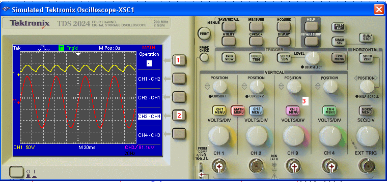

  • fullwaverectification2b.rar
First run the simulation, then go to MATH MENU
And then press 1 ---> press 2
Next set position and Voltage/div =100V and next you can off channel 3 and 4.

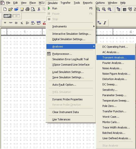

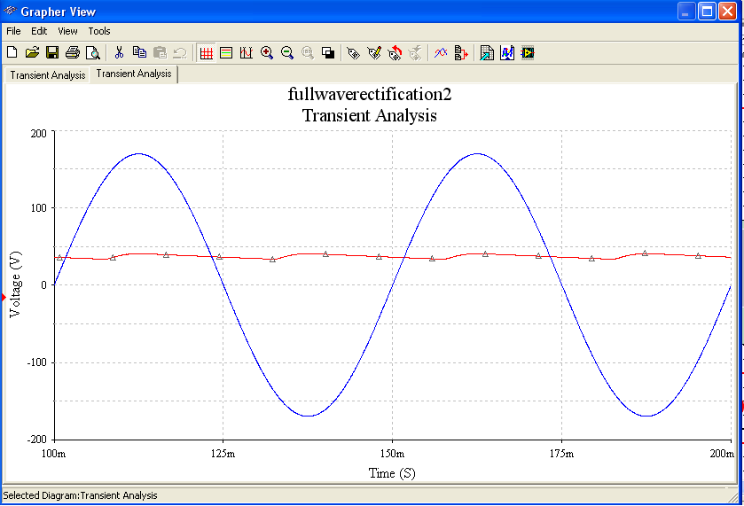

But you can use transient analysis to "see" the voltage in certain nodes.
and we end up with this waveforms

@Jony: I think the peak voltage for CH1 should be 120V, or should it be 170V ( Vrms x sqrt(2) )?
Anyway, I don't get the same output as you do. Although the o-scope menus on the screen look the same as in your attached screenshot:
https://img593.imageshack.us/img593/9308/jony1.jpg
I'm getting three waveforms, and other problem, as you can see, is that CH1 doesn't even occupy 1 division on the display!
In the following video you would notice two things: 1) the trace (or whatever you call it!) starts at the middle of the screen, why is so?, 2) CH3 and CH4 measure voltage across the primary and their waveforms are out of phase but their peak voltage should be the same, right? The set scale is different for both of them but in spite of this the waveforms for CH3 and CH4 occupy the same numbers of squares (or, divisions) on the screen. Why is so?
Video: ‪oscopefuss.avi‬‏ - YouTube

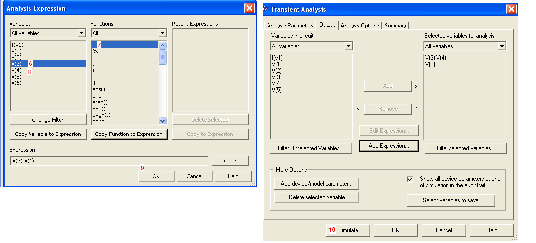

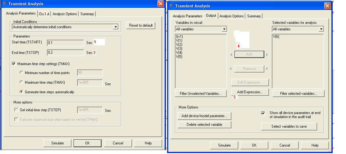

I think transient analysis can used to measure voltages across the circuit. In the following video what are those V(1), V(2), etc.? I think they are the voltages across the nodes 1, 2, etc. And what is that I(v1)?
Video: ‪transientanalysis‬‏ - YouTube
The input voltage is 120V RMS do the peak will be equal to 120V*√2 = 169.7V
For CH1 change Voltage/div, switch off CH3 and use "position" knob to move the waveform down.
Becaues trigger is set to starts at the middle of the screen. The first position knob from the right.
The voltage measure by CH3 is the voltage between node 3 and GND and for CH4 we have very similar situation (Node 4 and GND).
The primary voltage is equal to voltage at node 3 minus voltage at node 4.
I(V1) = current that is flow form the AC voltage source (V1)
As I said the oscilloscope shows the voltages referenced to gnd, if you don't add a gnd in the primary of the transformer you will get that strange results because the primary is floating.
The voltage source is 120v RMS so Vpeak=120*√2=169.70v and Vp-p=339.4v , the oscilloscope will show that Vp-p.
In your oscilloscope picture you have the red trace on which is the math between CH1 and CH2 but you haven't connected anything to CH2 so what is the point of that trace?

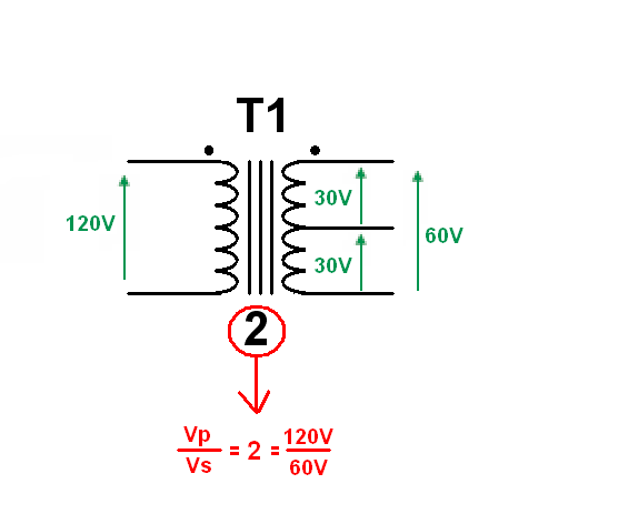

I have changed the Volts/Div setting. The setting is 20 Volts/Div. The peak voltage for CH1 should be 170V because the rectified wave have the same peak voltage as the primary. Right? The waveform hardly occupies two divisions; 2 divisions multiplied by 20 Volts/Div is equal to 40V. So, what's wrong? Please help me
https://img231.imageshack.us/img231/6227/ch1sf.jpg
Everything is okey. You use step-down transformers.
The relationship between primary (input) voltage (Vp) to a secondary voltage (Vs). is given by Vp/Vs = n, where n is the ratio of the primary turns to the secondary turns. The parameter n can be adjusted.
So your output voltage is equal
30V * 1.41 = 42.3 minus the voltage drop across the LED
